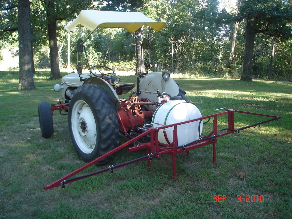

Just want to tell you thanks! Great project, and documentation. You have some very good ideas and workmanship. I hope you don't mind if I take some of them for my sprayer. I fabbed it up after having seizures when looking at the price of store built units. Here's a picture of it. 30 gallon, 12' collapsable boom, 8 spray tips, and a spray wand. Come to think, I'm going to build another one. I know where a 35 gallon horizontal tank is. Again, super job! Mark

Thanks Briar. I don't mind people using the ideas; otherwise I wouldn't have posted them.
With two 35-gallon tanks at your disposal, you could have put them on one frame, and used a diverter valve to control which tank sprays what chemical.
