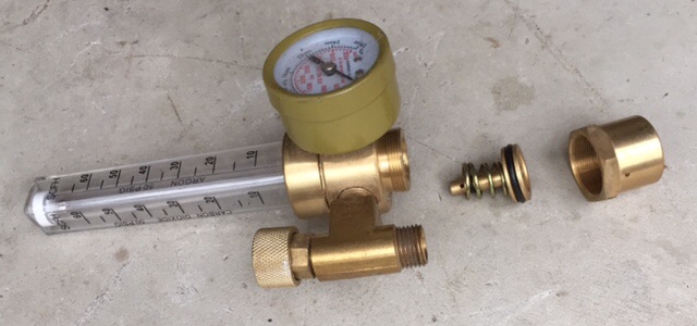

If there is no diaphram, how does it drop the tank pressure to a safe level?
Or does it give full tank pressure on the output side?
I believe these have an internal non-adjustable regulator built-in.
And therefore you should still try to open the tank slowly.
You're right it must have a regulator, but I don't know if its a diaphragm or fragile. I shouldn't speculate on the toughness. But it certainly doesn't "slam" the needle or overstress a bunch of tiny gear teeth etc (thus risk calibration). This would be interesting to "know".
I hear you on retaining the habit ----- of opening 2,000+ psi tanks slowly.

If someone has a broken one, they could take it apart and show us what's inside.
   / My C25 CGA 580 MIG welder regulator blew out today - anyway to fix it? #13
,,,,,errrrr got one but it's at my shop 100 miles away. Dan how do you know me so well? :laughing:
I'm curious and would take it apart if I had it here. I looked in Google images for a diagram or how it works but couldn't figure out what search terms to use, maybe Bruce :D can find it.
No diaphragm. I suppose this means you could cultivate a bad habit & open the valve quickly with this regulator. And yhe benefit you get from that is if the ball doesn't jump then your MIG held pressure. And if thsts the case, you didn't have to close the valve. FWIW,,,,,
   / My C25 CGA 580 MIG welder regulator blew out today - anyway to fix it? #16
<img src="http://www.tractorbynet.com/forums/files/welding/438455-my-c25-cga-580-mig-image-jpg"/>
Hmm. Uses a piston instead of diaphram. Looks like it wouldn't be too hard to replace O-rings, or inspect the seat. I wonder if the seat could be damaged by opening the valve too quick.

A lot of high end high pressure regs use the piston technology. It's a better mousetrap.
