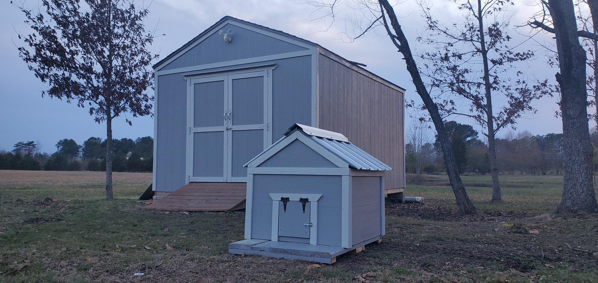

We got a few chickens and ducks in the early spring, almost as soon as the chicks became available around us. The picture below was after a week or two. 4 ducks and 14 chickens, one of each died. Chicken got the crusty butt and not sure why on the duck. He was fine the night before and dead the next morning.
I built the duck house first so they could be separated. (It's the little one).
Then I started dreading building the chicken coop. I had no idea how to start but found this. Too expensive and small to buy so I decided to build something like it.

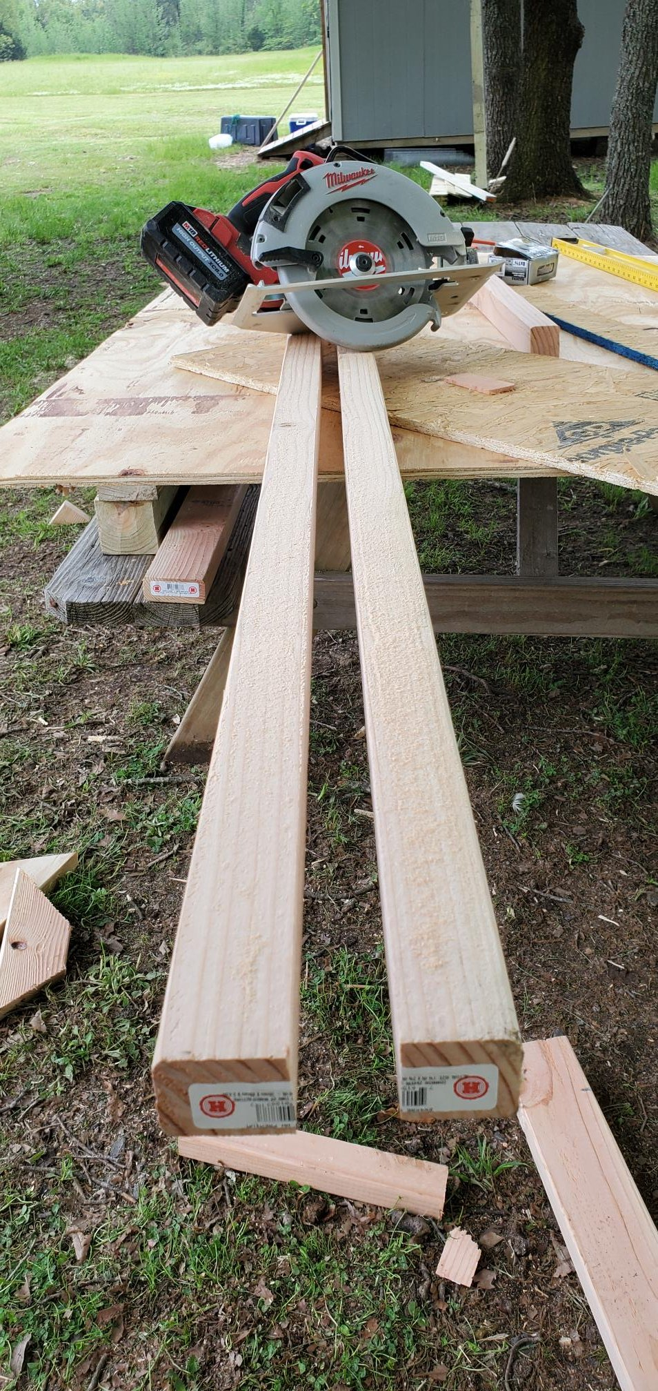

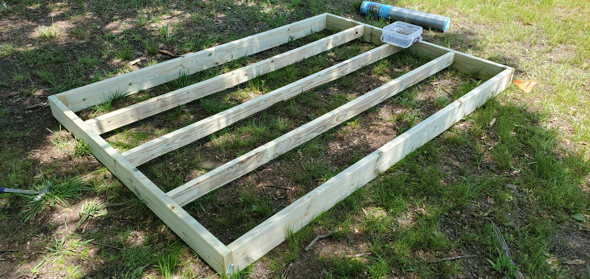

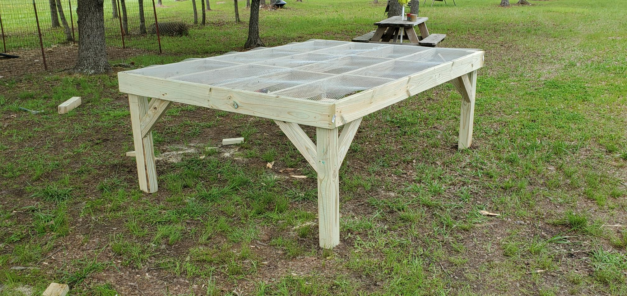

This is the first project I can remember that I did not have enough of an idea to sketch it up before building. So I finally quit procrastinating and just blindly bought some lumber.
Did some quick measurements on the temporary pen I had them in and decided that a little more than double should be a good enough size. So I started with a 6' by 8' floor.
Wire mesh sounds good enough for the floor. Maybe the poop will go through?

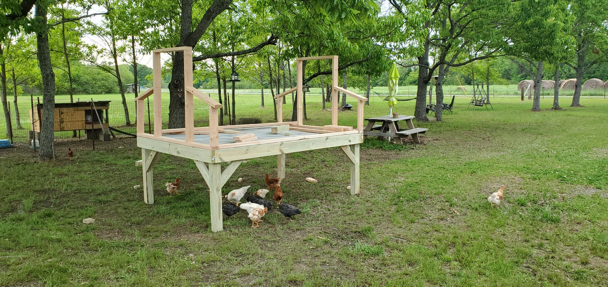

Now some legs to hold it up. How tall should I make it? No idea, about this tall should work?

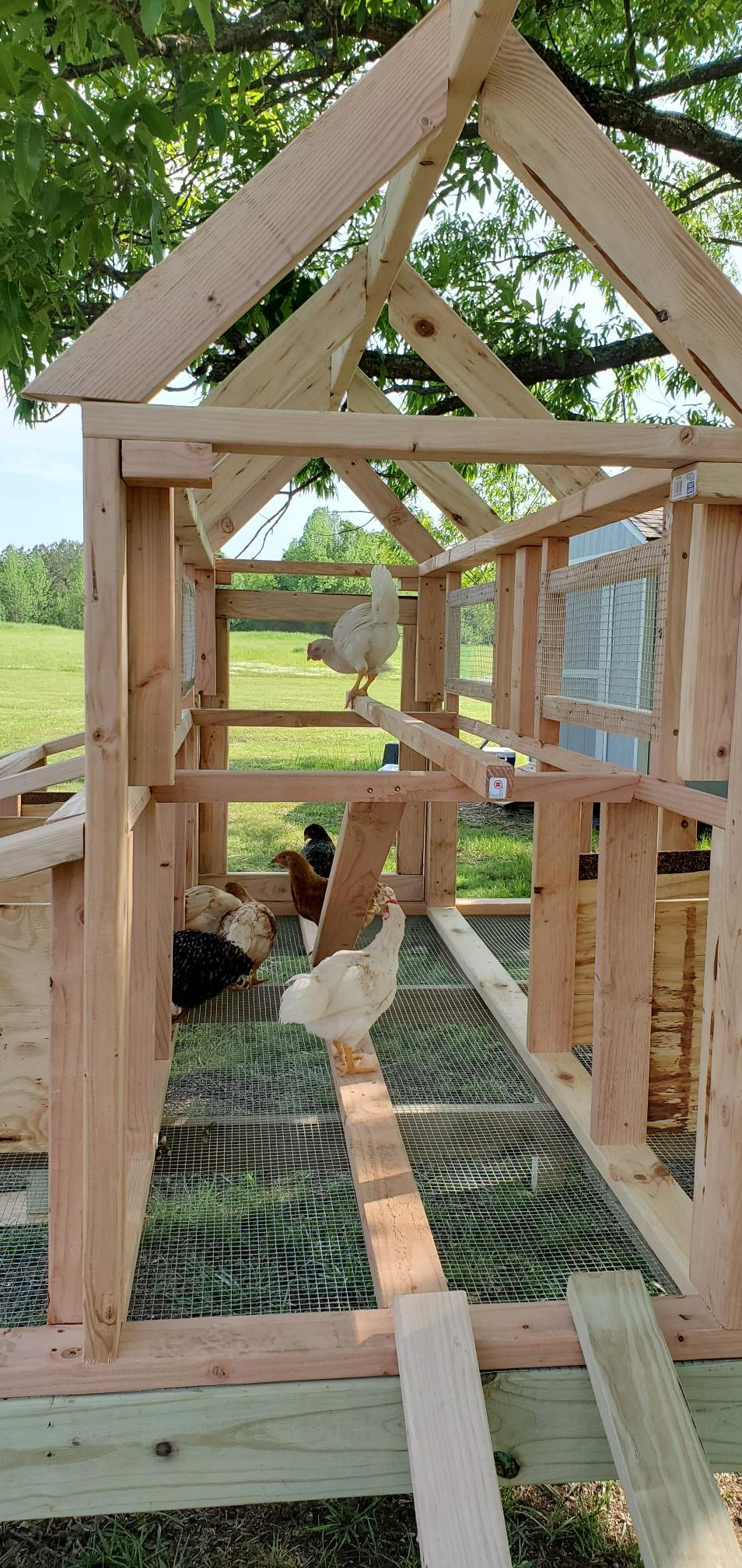

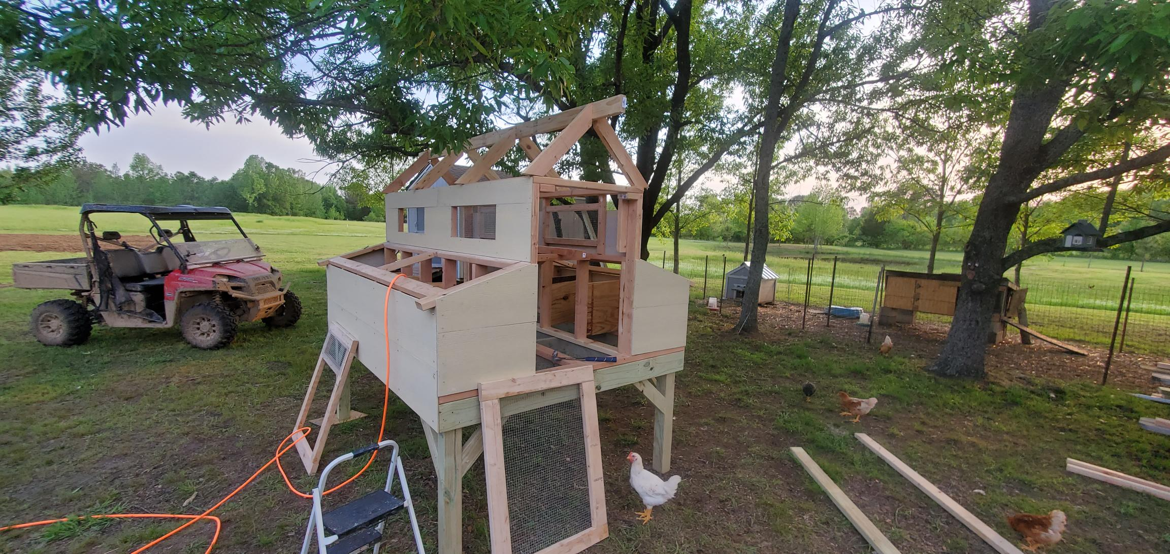

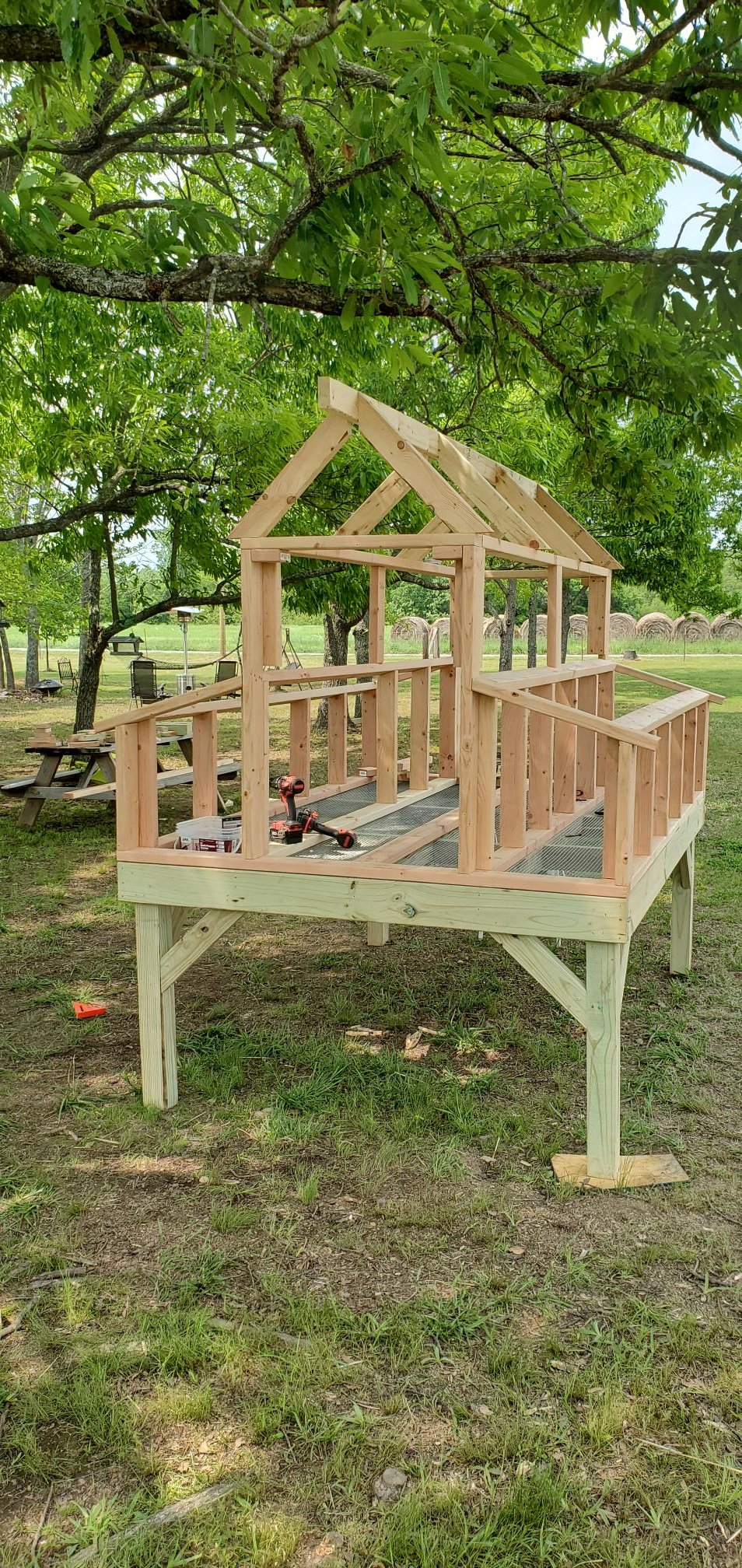

Again, no plan, just started putting some pieces of wood together to get an idea of what the gable end should look like.
Seems ok. I'll go with that and make the other end.

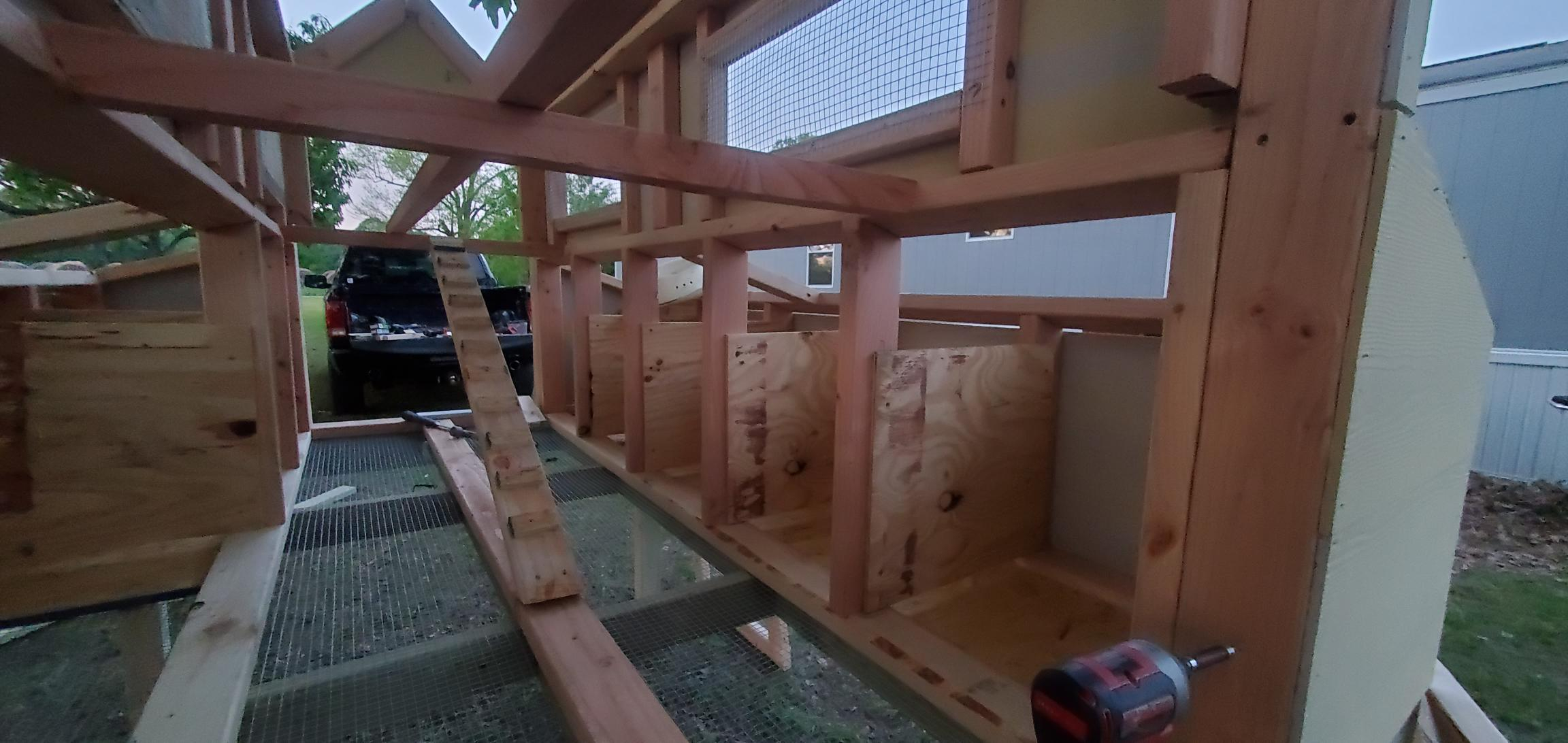

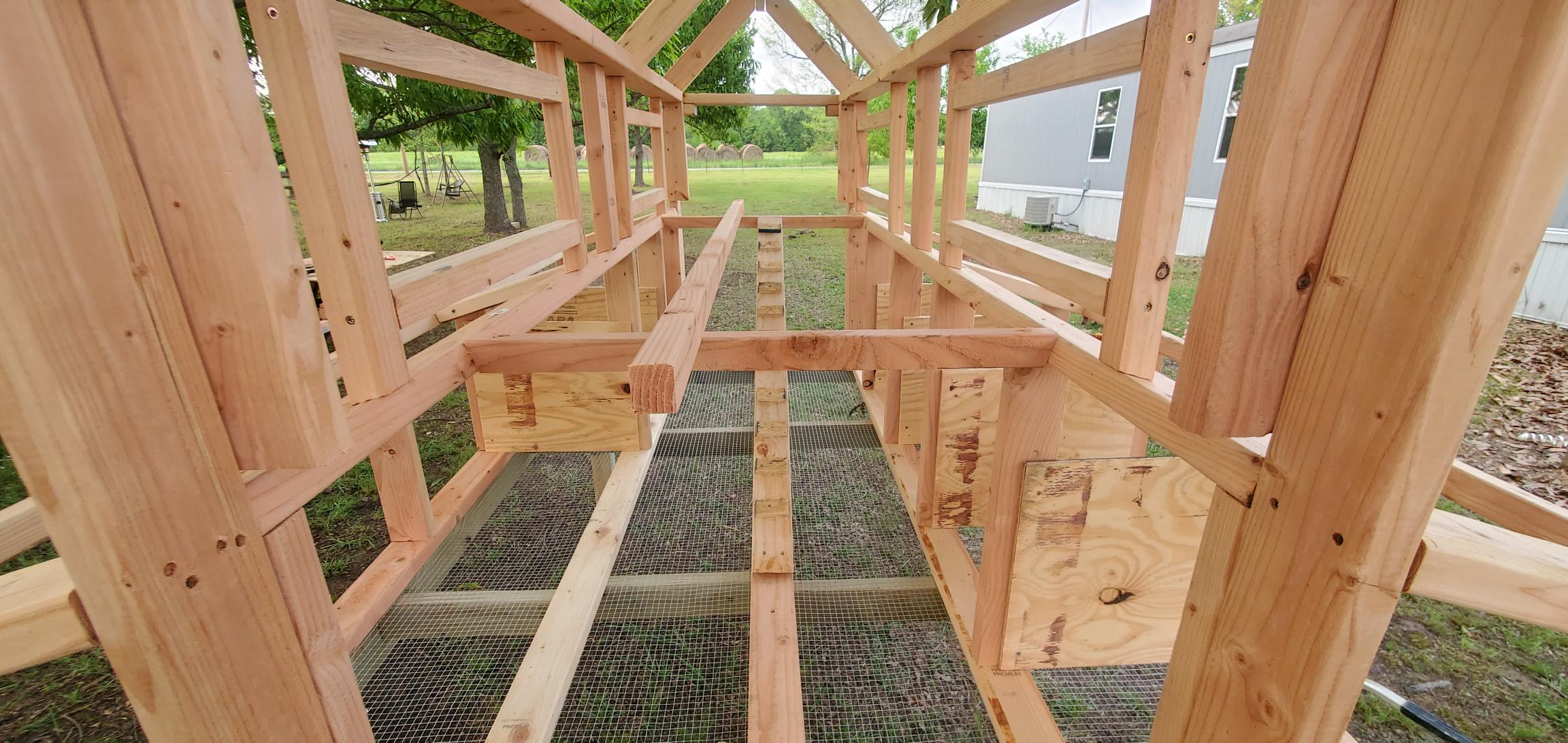

This spacing should work for nesting boxes, and wall construction.
   / My Chicken Coop Build (The Fluffy Butt Hut)

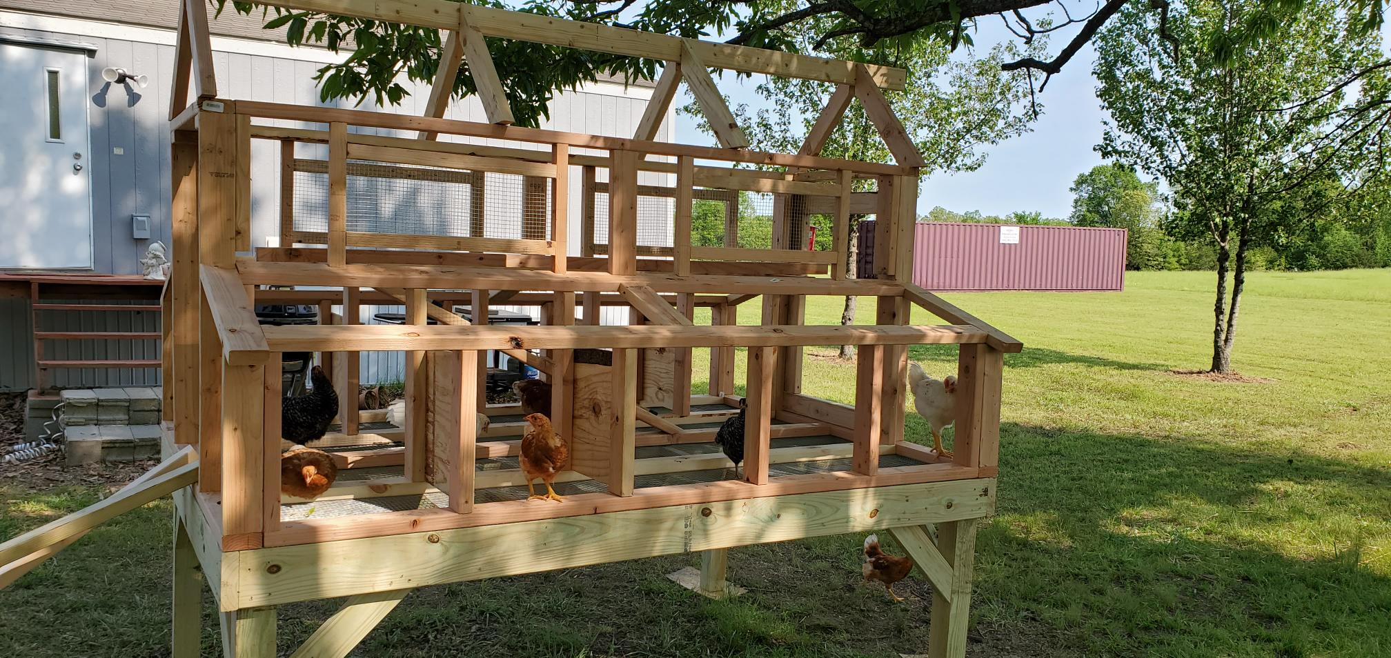

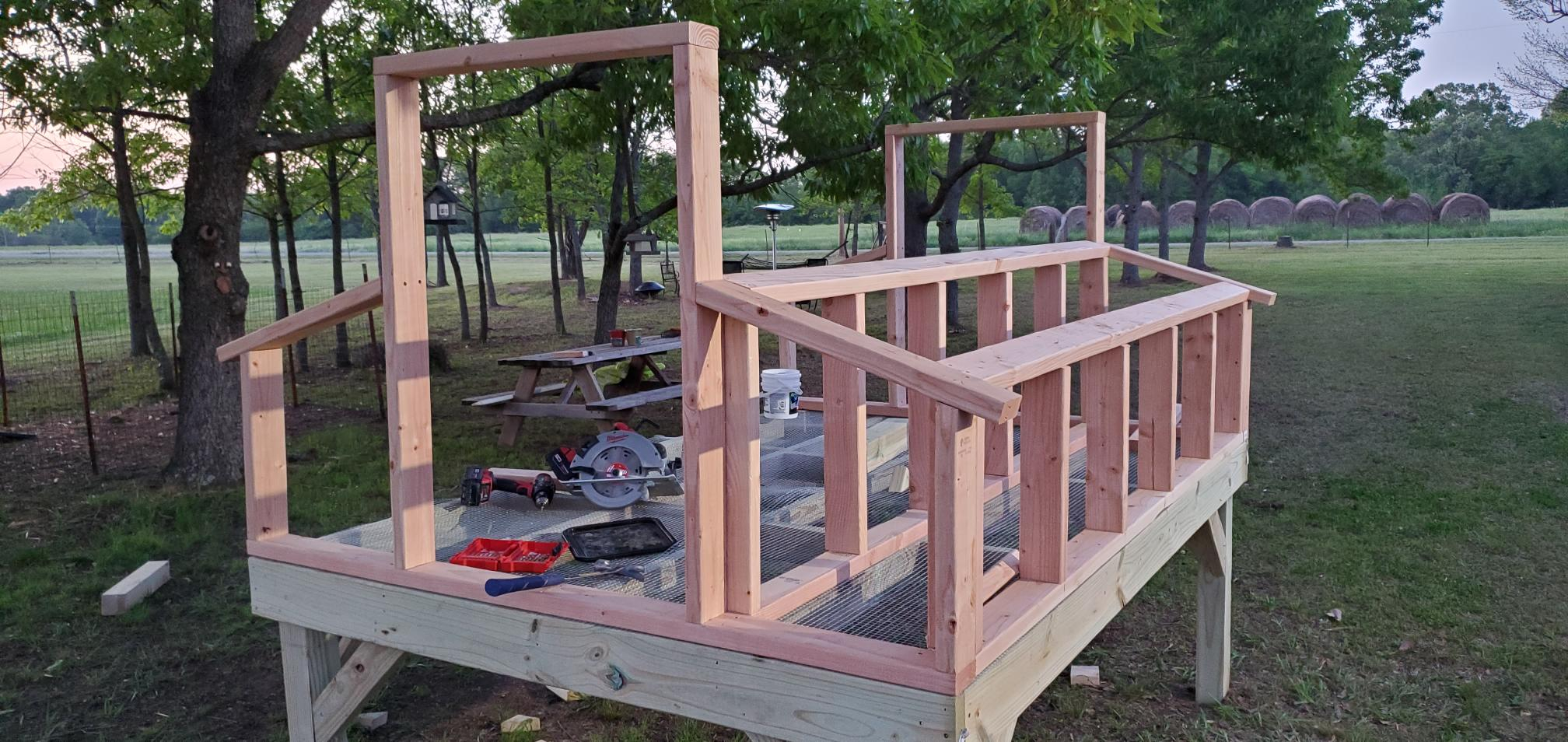

Finished the other side with just 2 nesting boxes and a larger open area. Also decided on a roof line. Yep a little bit of random bracing, not that professional, I know.

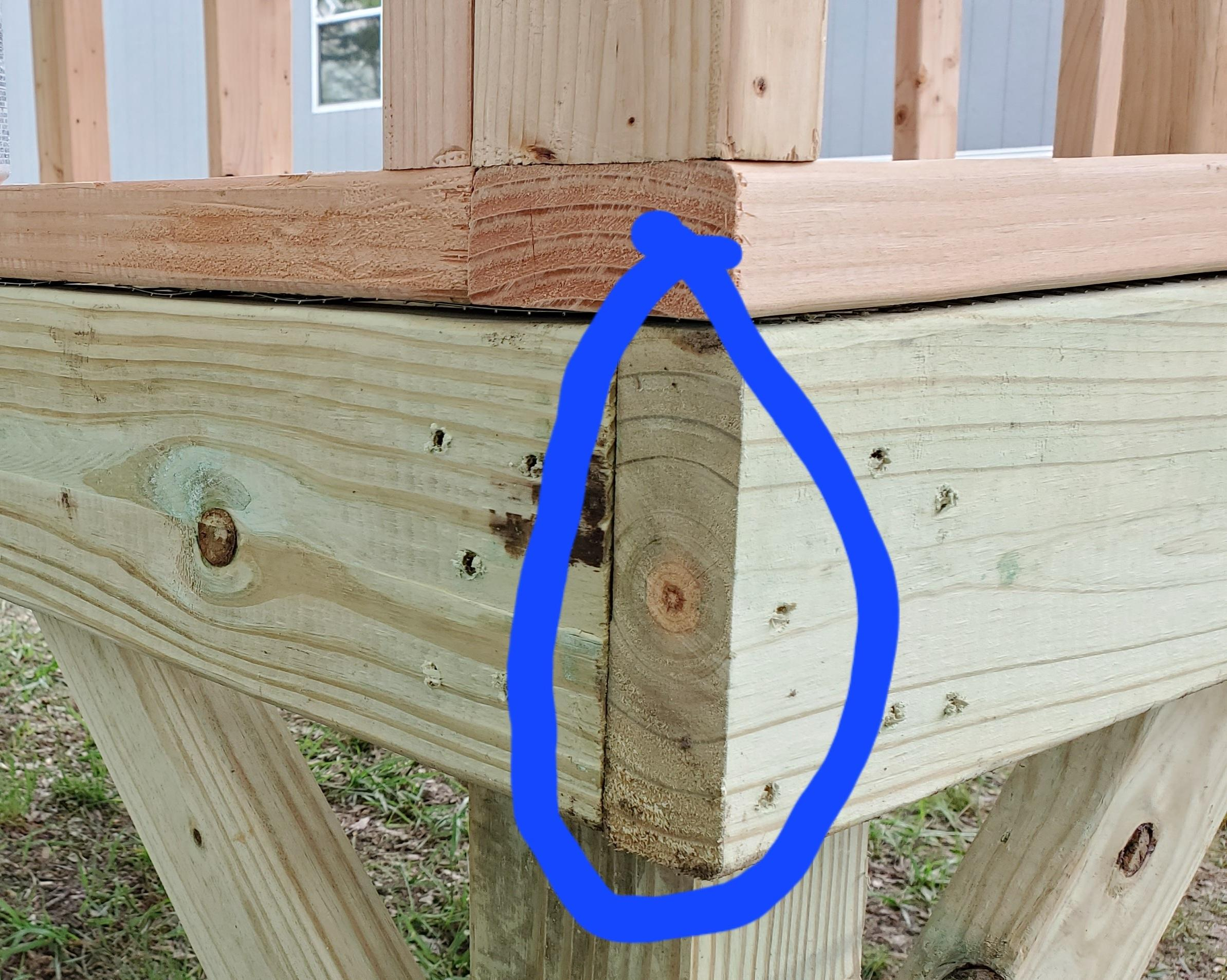

Around here is when I noticed my first oops... Remember that I didn't draw this out first. I was not forward thinking enough and made it 8'3" long, this board should have been on the inside... Sheet goods are only 8' long that is going to bite me.
I decided wood is getting a bit expensive. So I cut the cost in half, so to speak.
Test fit some window openings and a roost with a ramp.
Windows and roost are installed. Inspection is being performed.

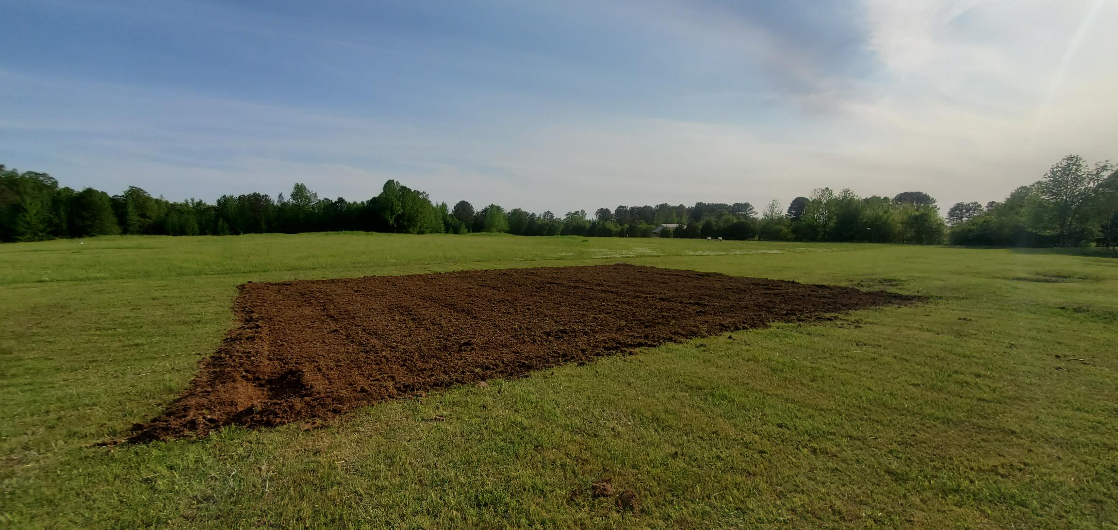

Intermission for garden tilling. It has been really wet this spring and there was finally a break long enough to till. Still a little wet for my liking but it worked. Poor goose wanted to help so bad. At the old place he would be beside me the whole time while I tilled with the walk behind. He would dig so long and hard he would have a hard time walking after it was over.

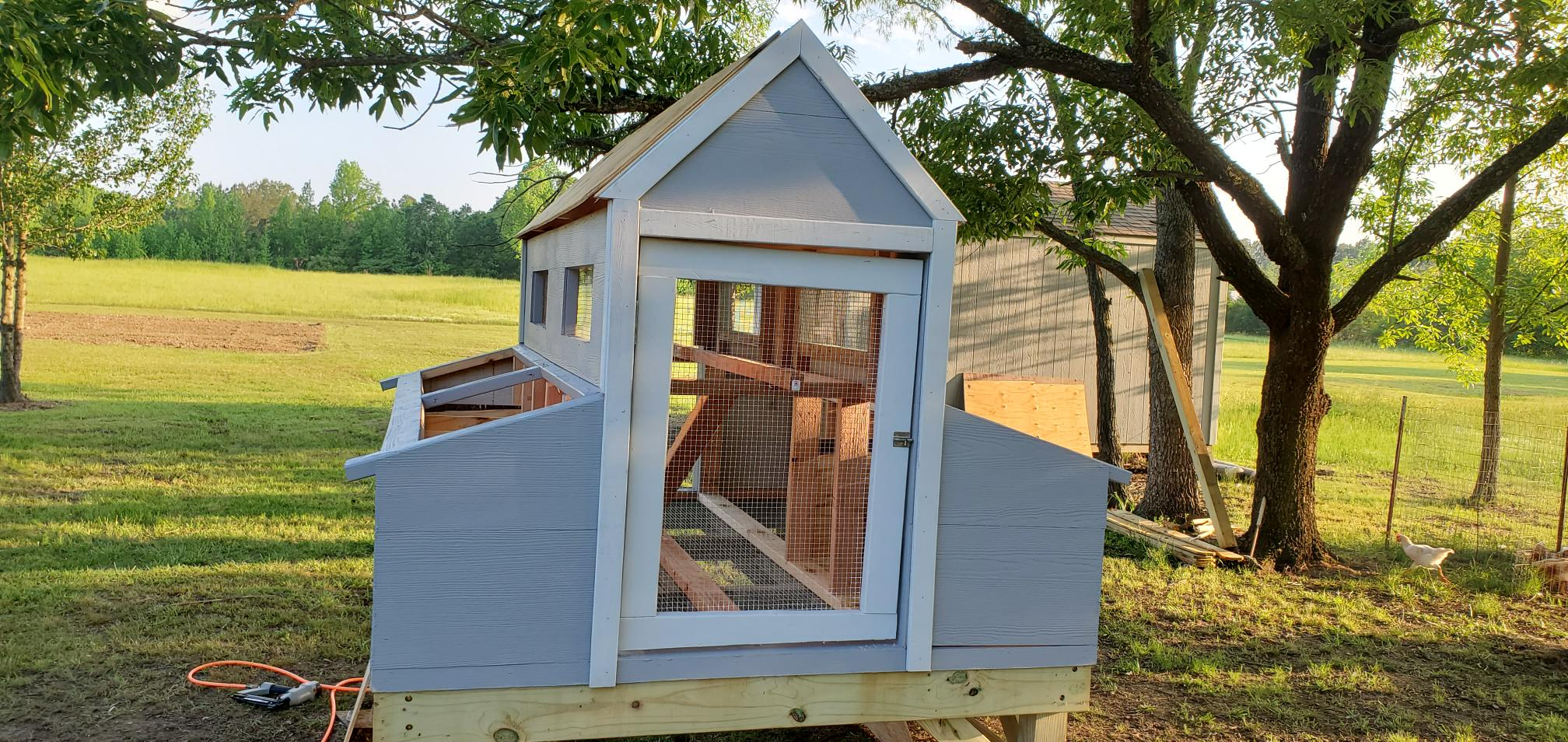

Break is over, back to work. Starting to put a little skin on now. I opted for Hardy (cement) board. It's intended for outdoor siding and to be overlapped at the joints. I just butted it up for a smoother look. It won't be perfectly water tight, but the windows are made of wire mesh anyway so I'm not worried about that. Price was just a little higher than plywood siding. But this will last forever and the long wall is 8'3" and the Hardy board is 12" x 12' so it will cover the whole length.
Oops number 2. One of my door openings is not square. Not to worry, I just made the door a bit more "custom"

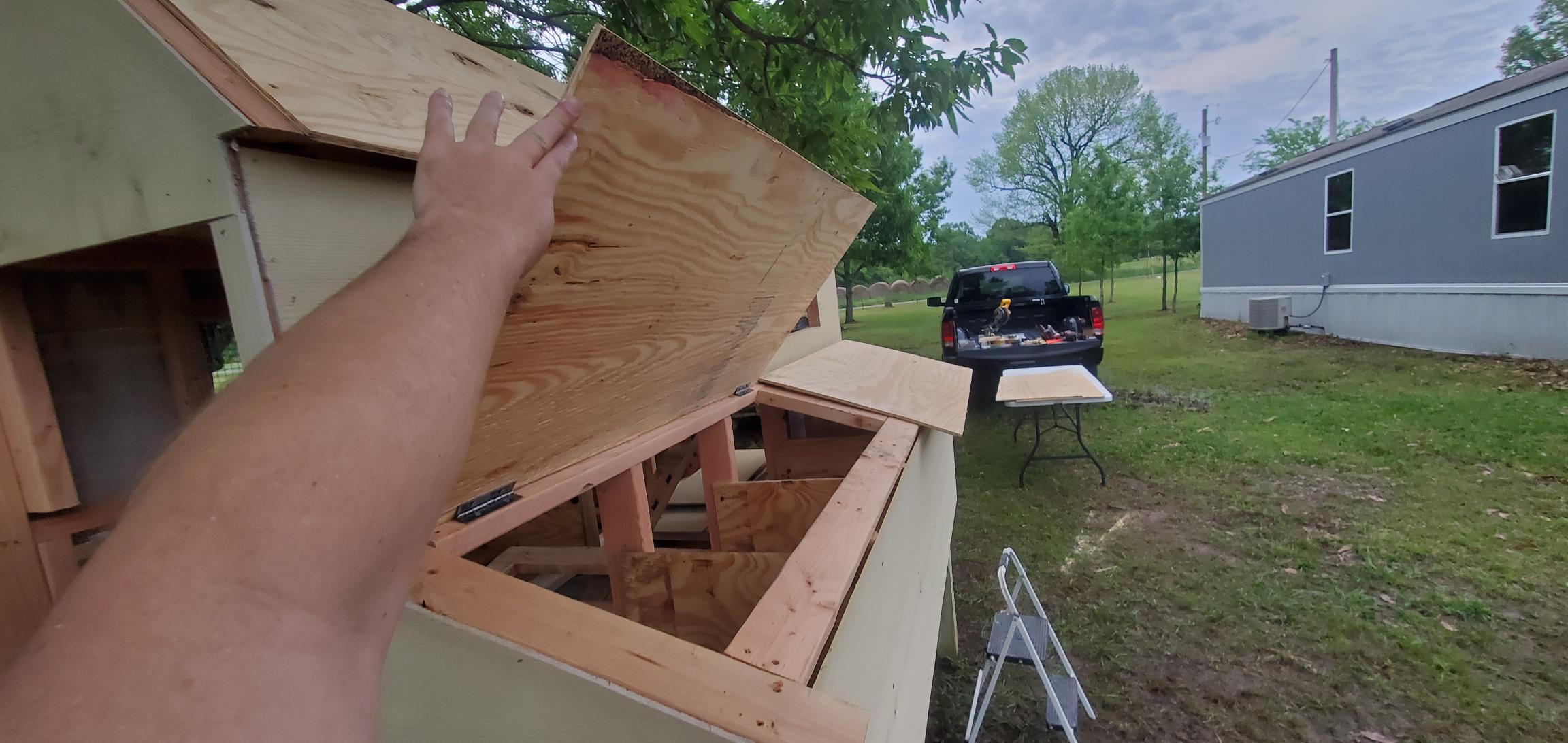

This is how I'll get the eggs:

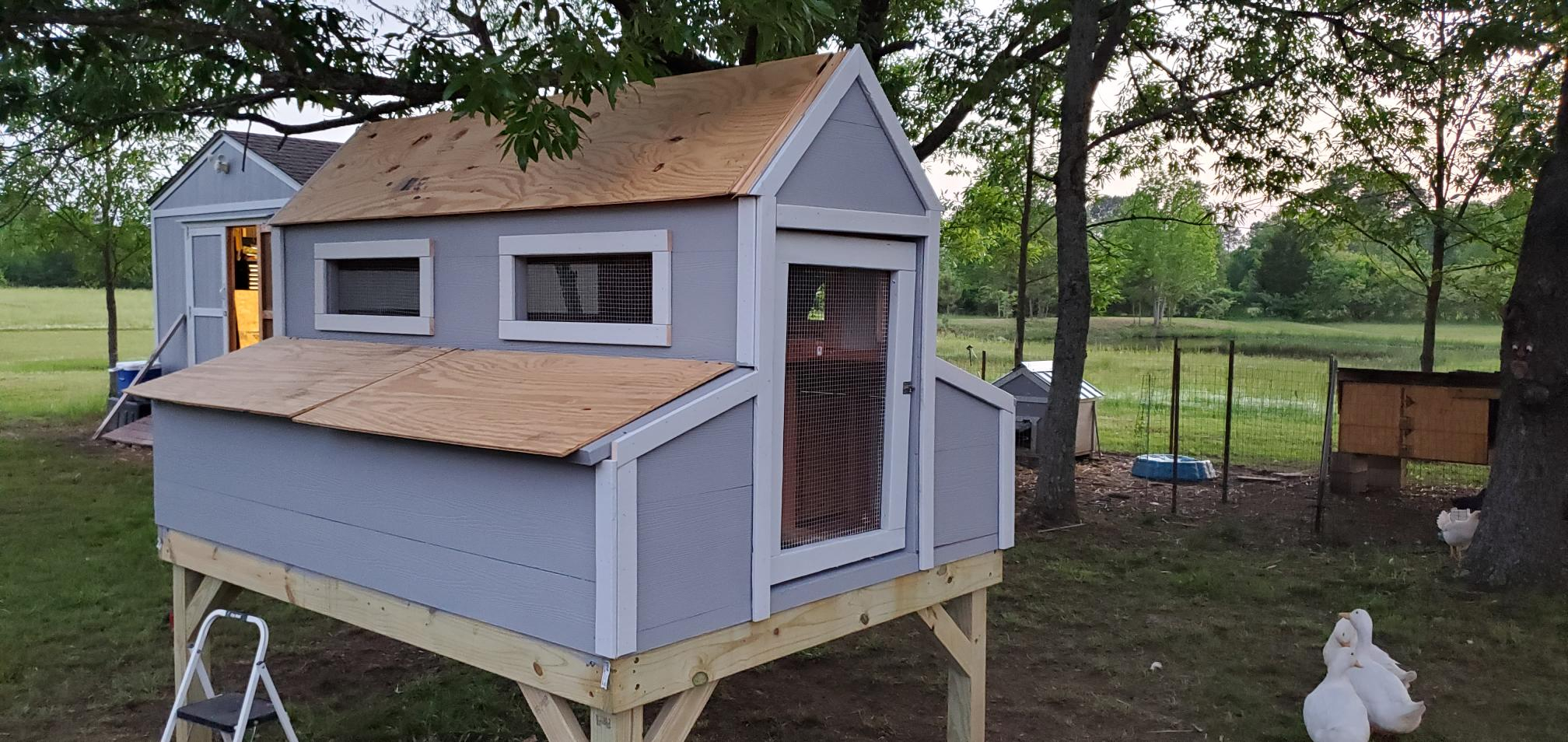

A little paint and the beginning of the trim.
A little more trim and the rest of the decking back on.

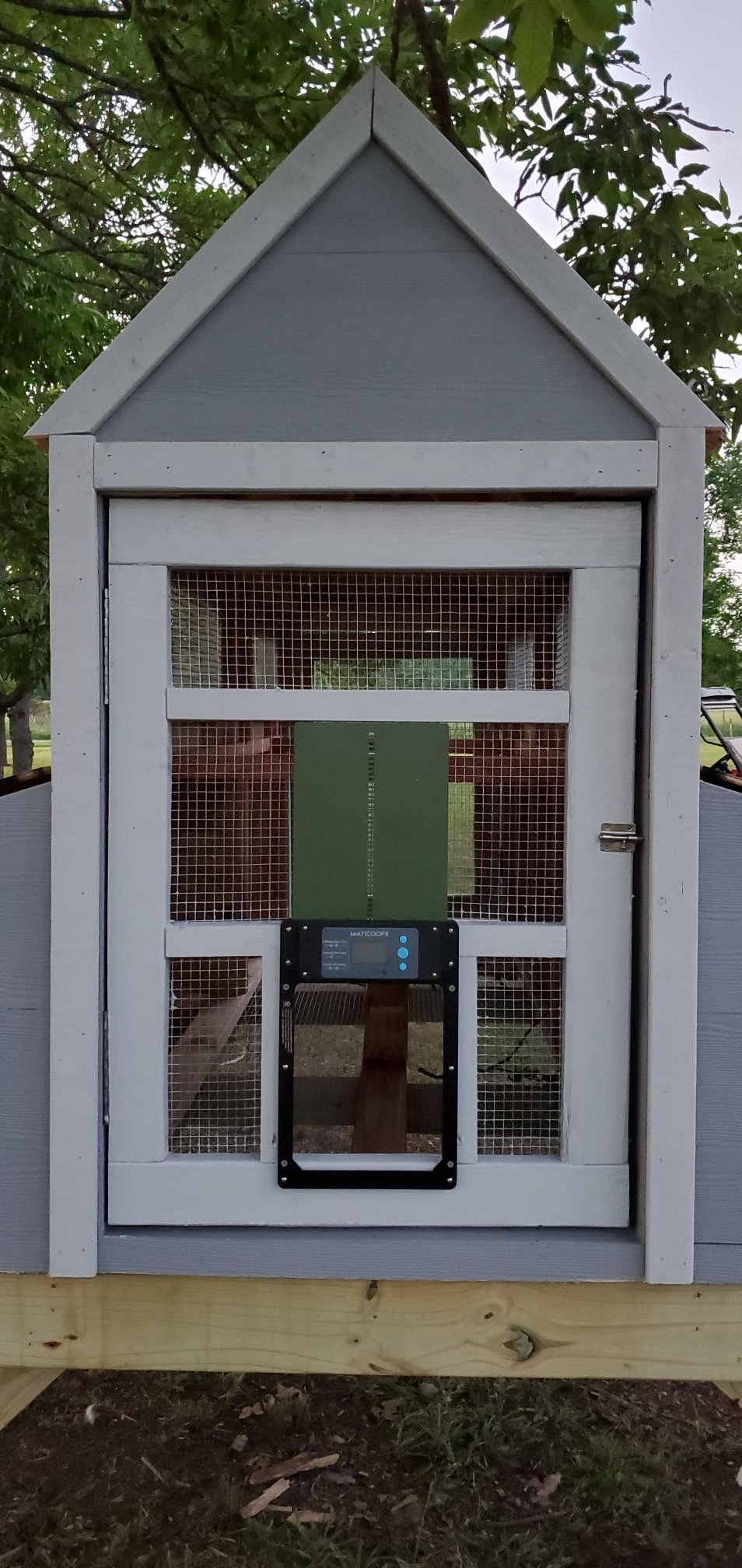

Automatic door installed:
#9

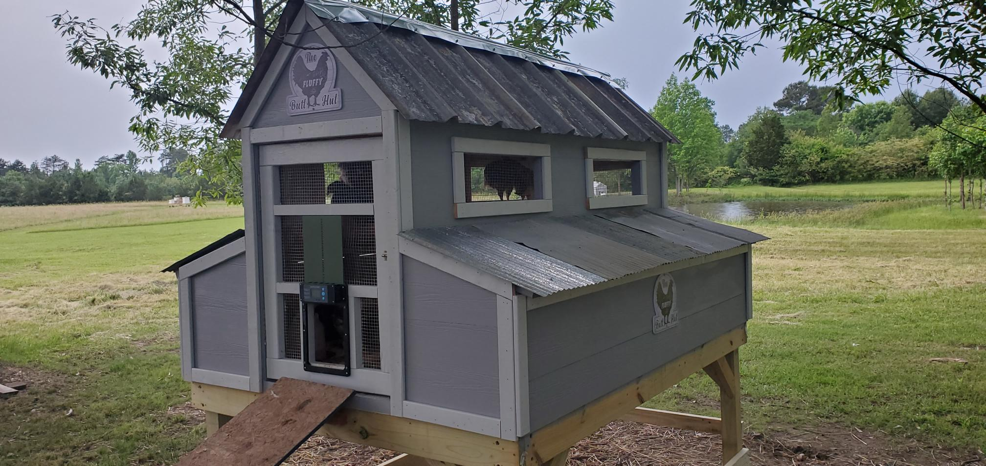

Completed Fluffy Butt Hut.
Chickens are very happy. I do need to find a better ridge cap. The only one I could find was made out of aluminum foil I think. It looks bad.
It's not perfect and I'm sure there are better ways to do it. But, I'm happy with how it turned out for the most part.

It was perfect for the size flock we had. Since then we have added birds and it's a bit small. We have not had problems with snakes on this one, I assume it's because the floor is very elevated.
Overall we have been very happy with it. No rot, still as solid as the day I built it. The automatic door is amazing, I will never be without one. If it was just a rectangle and not old barn shaped you could fit another full length roosting board so double the birds could roost at night on the same footprint. But then it would look totally different. I guess you could widen the high portion and have the same shape but then your footprint would be wider. I never did change the ridge cap. It seems fine now, guess I was a little hyper critical.
