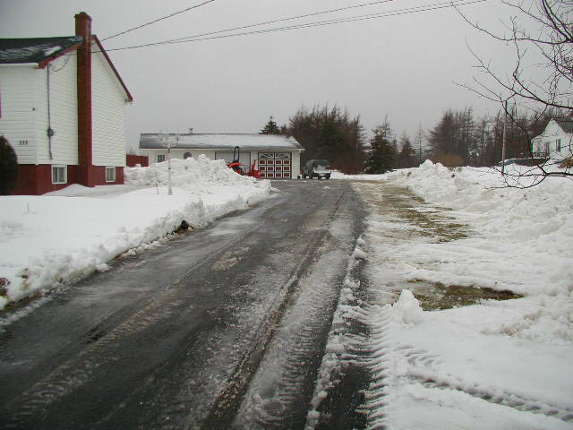

I know - it's a never ending subject but one has to apply the HST answers to their own unique situation. I'm looking for some help, please ? I run in medium range but I really have to work it by taking run at the snow and when I get too much to move it stalls. This particular day we had extreamly heavy rain for about 3 hours after the snow. I had no power going up my driveway of which is only on a slight incline as you will see. I couldn't get very far with the couple of inches of slush.
There has been a couple of ocasions when I had to rock it back & forth to get it moving in just a little bit of snow. My dealer who also sells Masseys, says they just do a small adjustmant and they are ok. Do you think it might be a valve adjustment How about a couple or a lot of views on wether I have a problem or I don't ? I'll post a few pics on my CK 25. Took me about 3 hours to move this stuff aroundfrom front to the back of the garage - I'll post some progress pics from the piece I am building in the back later. Thanks

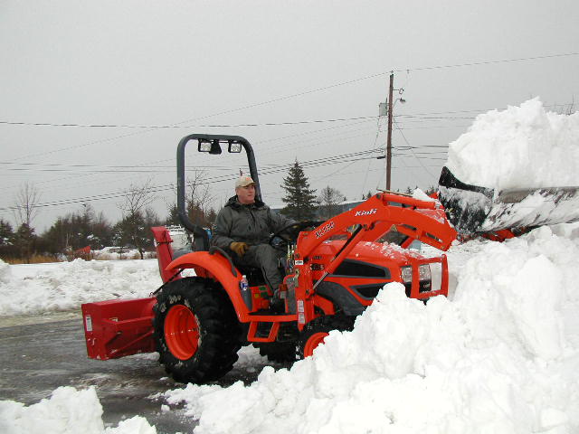

It stalled getting a good scoop in meaduim range.

I don't own one, but I have moved a little snow with a ck30 hst. Every time I ran out of traction before it would stall. Heavy wet snow, as people have said, RPMs would need to up, and let off the pedal if it starts to bog.
IMO, no way it should be stalling when doing FEL work, unless you are running low rpms.

I keep the throttle at about 2000 to 2100rpms and I always have my foot on the clutch to ease the strain on the motor when that happens but stalls before I get a chance to push it in. I don't have any additive in my fuel - what do you suggest or what should I ask for ? Does Walmart or Canadian Tire sell it. Thanks

Steve - probably just a habit with the clutch, me thinking when i push in the clutch it appears to take the strain off of everything and I usually take my foot off the accelerator at the same time. But if you look (first attachment) at the slight incline in my driveway i tried to plow (in medium range) about 2 or 3 inches of snow & slush up hill and only got about 5 feet, no power beyond that. Is that normal for an HST ?
any input would be appreciated. Thanks
Kevin

This defiantly sounds like a driving habit, Run your tractor at wide open throttle and govern your speed by how far you push the hst pedal.
Keep in my when your tractor starts to run out of power ease up on the hst pedal just a bit and recover the lost rpms
