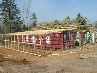

My inside dimensions are 24 feet by 39 feet. I had to bring in the ends 6 inches on each side to handle the curve and design of the containers.
I used 14 foot 2X6's for the truss's that are 4 feet apart.

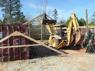

   / My Container Barn
After reading Spencer's and Henro's discussions on their barns and doors, I've decide to put in a roll up door. The dimesions are 12 feet wide, 10 feet tall.

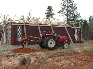

   / My Container Barn
Outside of each container I'm building a lean-to. This side will be open on two sides with 10 feet between each post.

Where did you get the containers and how much are they? Don't know that I want one, just curious.
   / My Container Barn #8
Looks good, Eddie.
Is there some type of foundation?
Be sure to update us with your progress.
   / My Container Barn
#9
I found the containers in Dallas, about 100 miles west. They were $3,030 for both delivered.
Prices really depends on who you talk to and what the other guy is charging. I started out at $3,000 each, then the next guy said he'd do them for $2,700 each. I kept looking until I found the best price.
I have 4 inches of limestone under the containers and as a floor of the main barn area. I will poor concrete in this area in the future.
The side lean-to sections will be just dirt floors.
