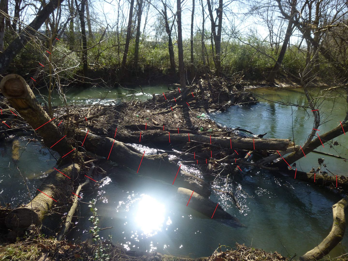

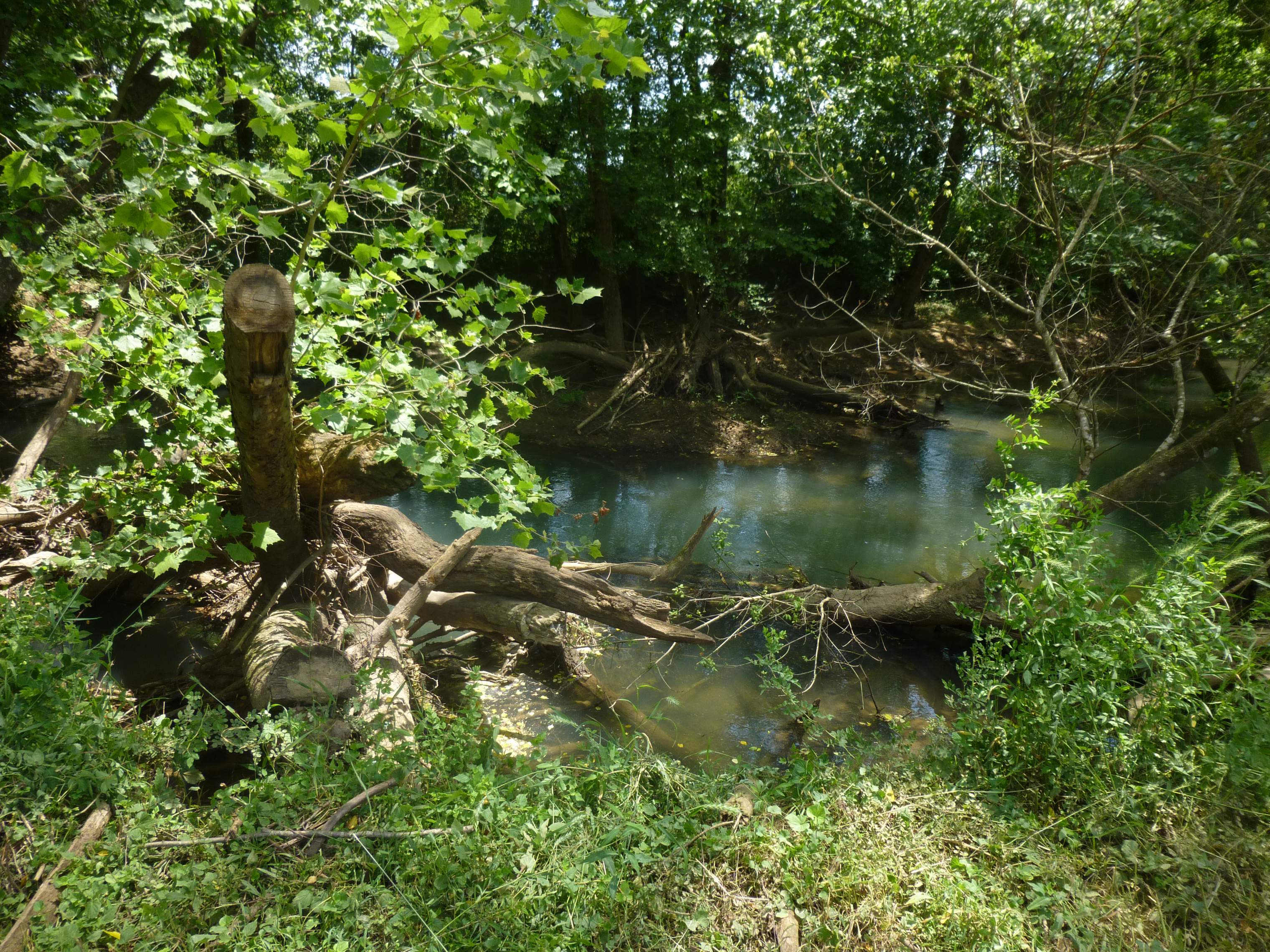

Here is my E. TN Big War Creek:
   / My creek is clogged - What would you do? #42
I might have missed a few, but you have to cut them into firewood sized cants to get them to move when the water comes back up:
