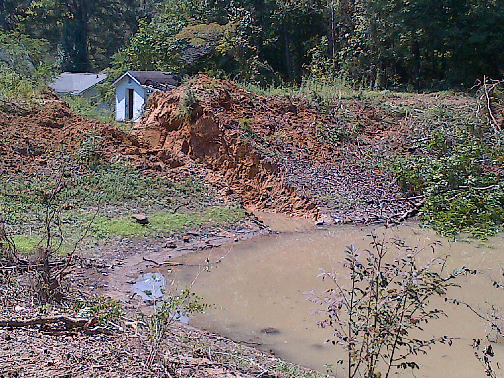

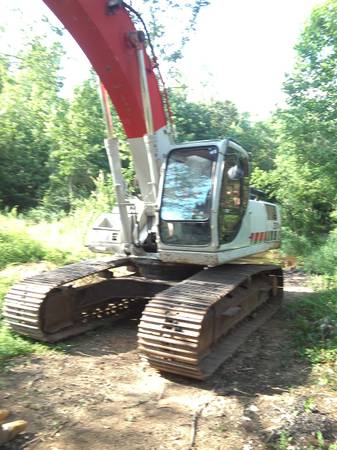

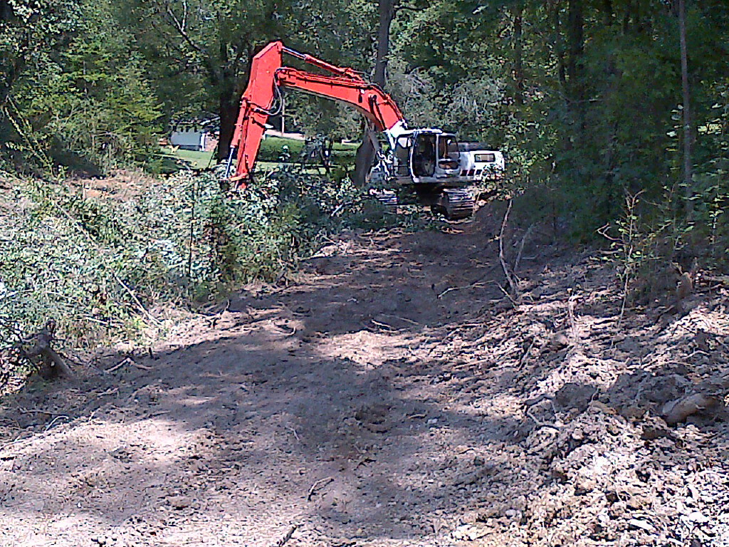

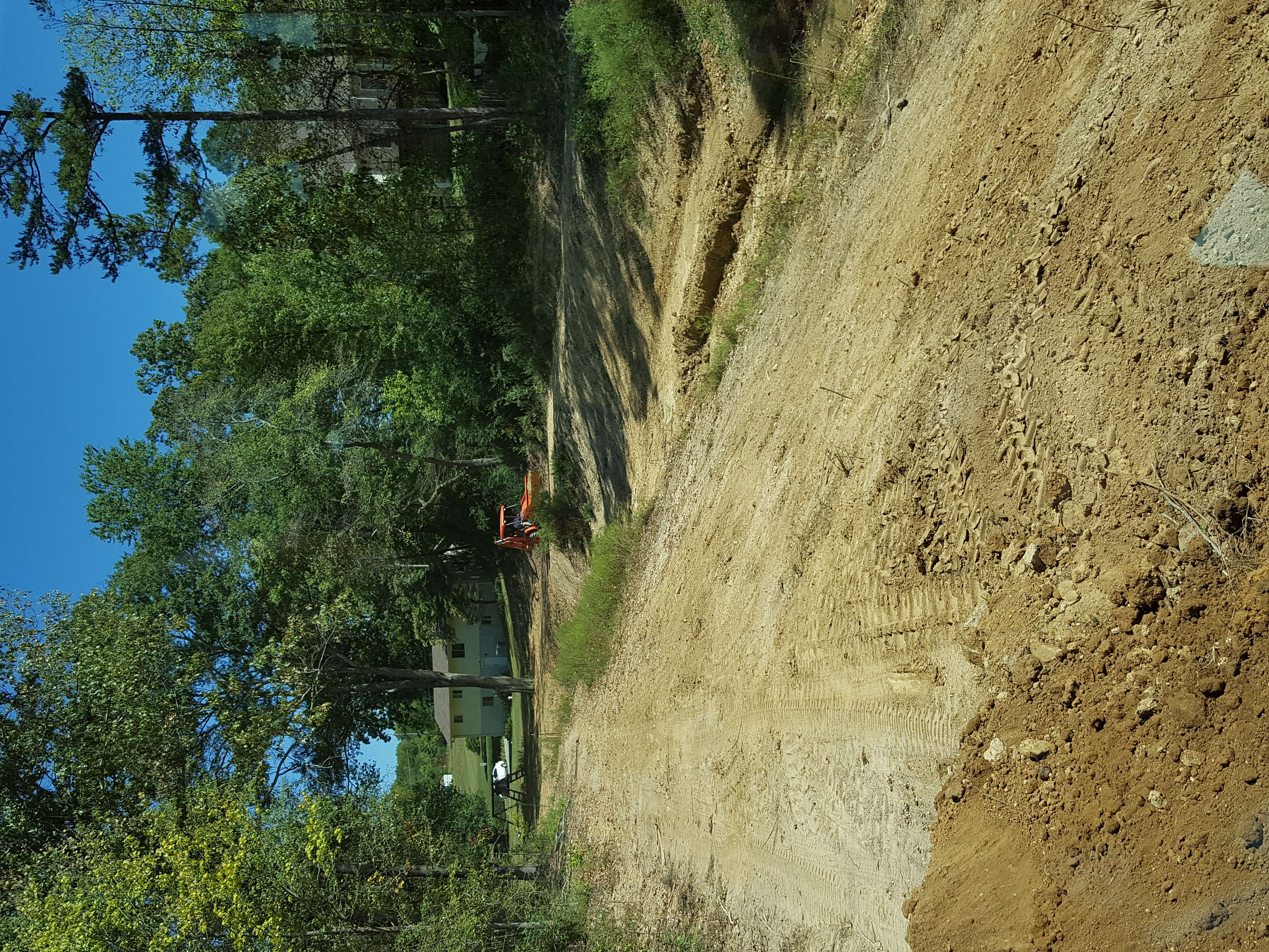

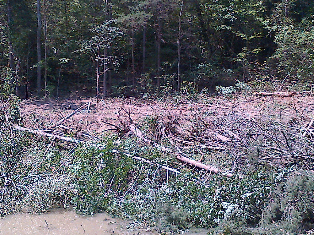

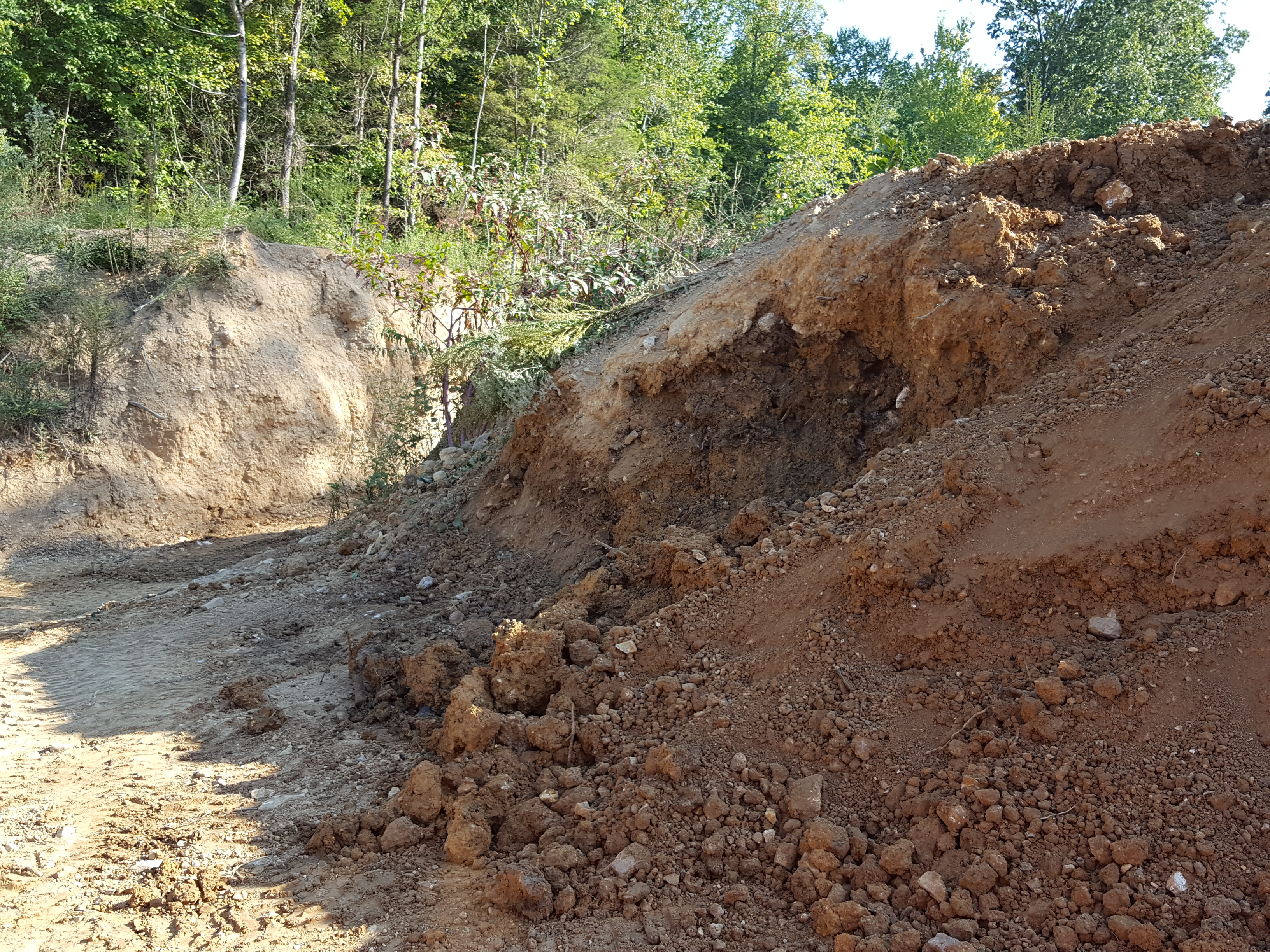

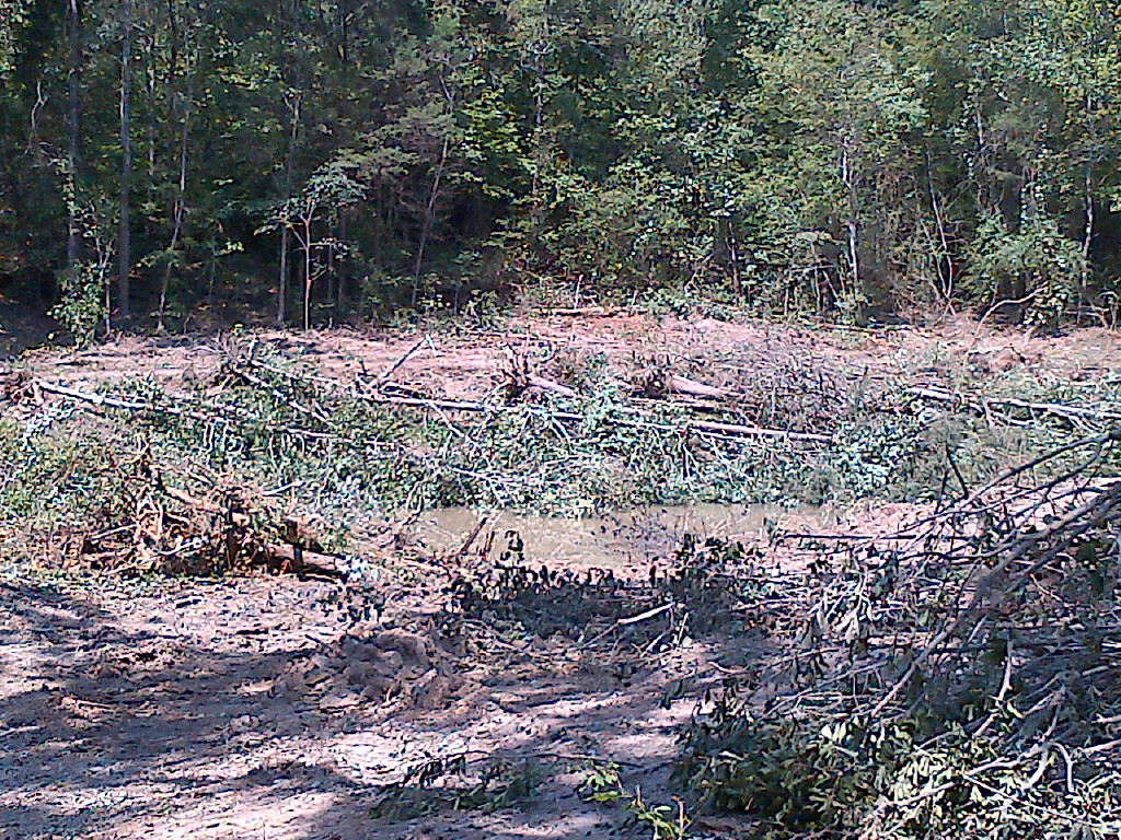

My pond has been leaking under the dam for several years. After getting a $22K estimate from a pond re-builder, I started collecting equipment to do it myself, finally found a dump truck last week to haul the mud/silt. Started cutting it today but did not reach the water level since the pond is only half full but will tomorrow. Should be fun project. At least I can use the excavator for something other than digging holes for my wife's roses:D
Picture of my excavator on the dam and all the trees I cleared off the back of the dam.
Well, I thought I would update my year old thread as my pond work and dam repair is almost done, planting some grass and shaping the sides a little. I installed two 18" overflow drains vise the one it had before.

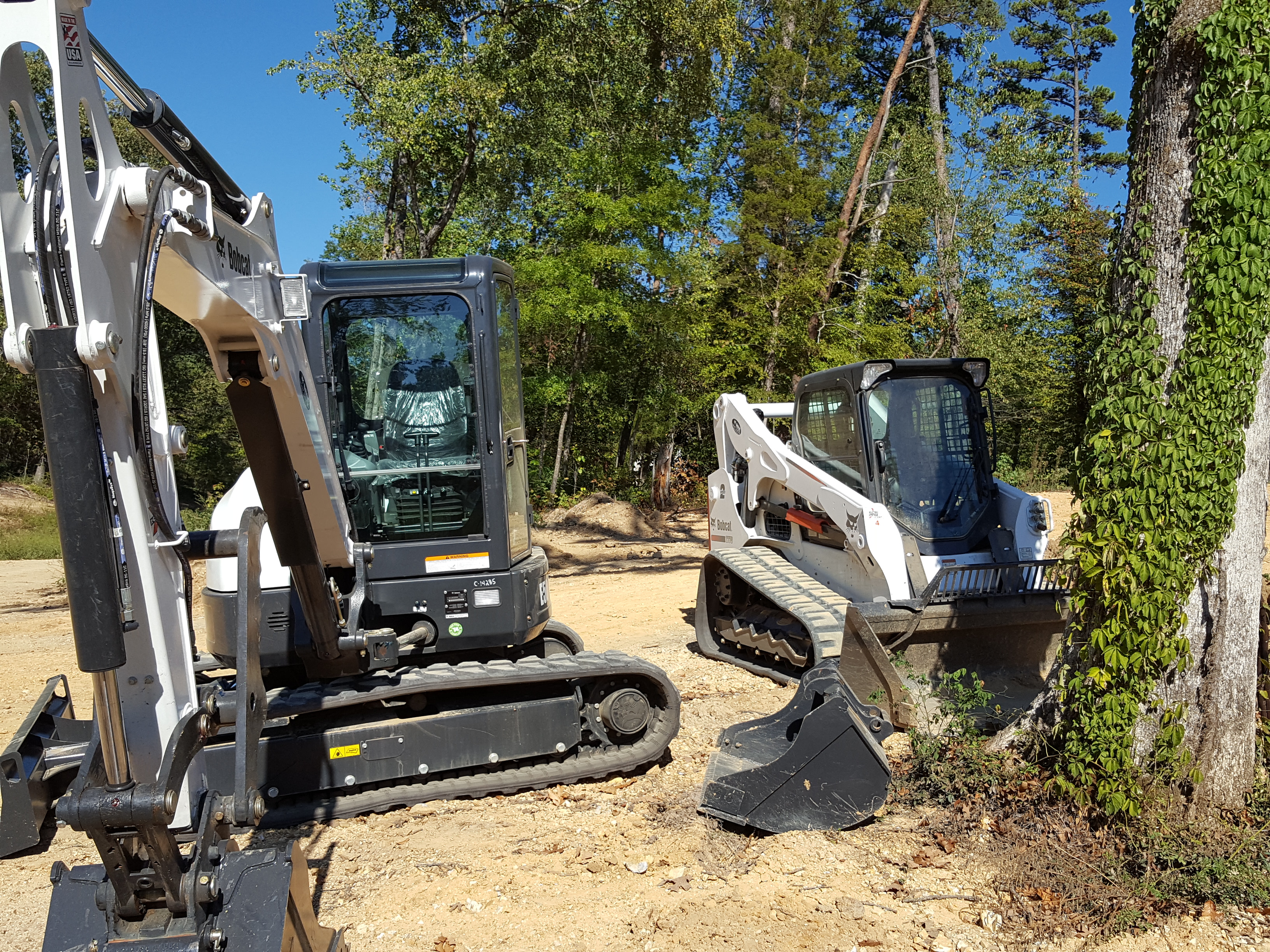

More pics, and some of the equipment I used. My wife is running the backhoe shaping the back side of the dam. She moved a lot of dirt for me, one bucket at a time with the L45 (I offered her the cabbed T770 but she preferred the L45.
Now to find someone to drill a well for me to fill the pond and keep it full.
