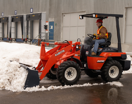

1) Not exactly a tractor really, but basically an articulated loader, for tight quarters maneuvering without tearing up the ground.
2) SSQA loader to accept my existing attachments
3) front hydraulics with enough flow to run a 5 ft., front mounted bush hog
4) 4WD with big tires all around
5) 40 to 50ish HP
6) maybe a heated cab but low profile for mowing around trees. (Or easily removeable in nice weather.)
Is there such a thing?

One of these 4 models should be pretty close.
Compact Wheel Loaders | R Series | Kubota Tractor Corporation
Or maybe this:
Why Toolcat? - Toolcat 5600 and 5610 Utility Work Machines - Bobcat Company

I haven't found anything that meets your criteria in one package. The Kubota R series are nice articulated loaders, one of my friends has a 520 with hydraulic quick attach (nice) for in seat attachment changes. But the aux hydraulics are not enough for a brush cutter. They are taller than they look, about 8' IIRC.
I pretty much have what you are looking for but it takes three of them to meet those specs.

The Kubota R530 looks like a very capable machine, but it is big, heavy and I'll bet over $50,000 with the cab, etc.?

The problem with most of these compact wheel loaders for you will be the height issue. They are similar in height to cabbed tractors or taller. For that reason I use my 4x4ws mower with 3ph to work under trees without a rops.

My understanding is that Earthforce built it, IR bought it for the all-wheel-steer design and bought Bobcat too, then discontinued it because it competed with their skid steers. What ever the reason behind it, it was a very nice machine with a strong loader and a lot of potential. My thought is that if the backhoe had been detachable to switch out with a 3pt it would have been a perfect machine for a whole bunch of tasks. Could be wrong, but I think parts are a bit hard to find. Have you thought about an all-wheel-steer Bobcat A300? More power and weight than you're looking for, but it'd get stuff done for sure.

This is pretty much what you described, but the tires may not be as big as you'd like. A nice bonus is that it's only a bit over 7ft tall. The specs say 12.9gpm to the standard aux hydraulics....seems decent for this size machine. I think even higher flow hydraulics are an option. They have a really impressive loader for their footprint, and weight.
