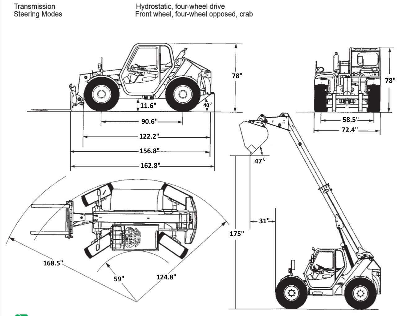

The dimensions of the V417.
Note the turning radius, inside 4' 11", outside, 10' 5", and 6' 5" cab height is why it gets around good in the woods. :thumbsup:

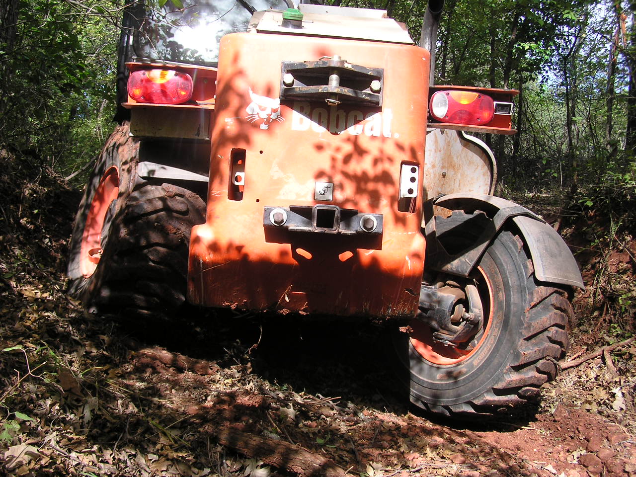

I'm trying to figure out how "driving" in a circle, is more maneuverable than using an individual brake on a tractor, so that will turn right around in it's own length?
SR
   / My dream tractor: is there such a thing? #34
   / My dream tractor: is there such a thing? #36
duplicate
   / My dream tractor: is there such a thing? #37
SR
Driving in a circle is for going around trees.
It is more maneuverable because of rear wheel steering, which also allows crab steering to get away from a fence or building.
