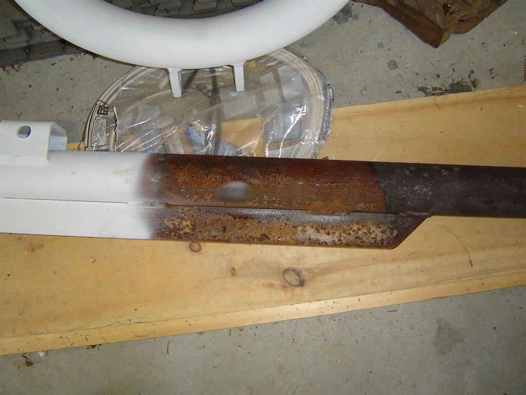

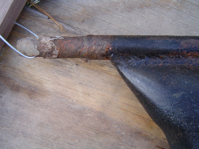

After seeing the GREAT result on the post hole digger, i want my own de rusting rig.
after you took it out of the bath, it still looked dirty to me, but after pressure washing, the iron looks like fresh manufactured steel :)
I see you use 3 rods of rebar, to attack the PHD from all directions in the bath ?
/ My electrolysis experiment
#44
Renze said:
.<snip>
Thanks. I smile every time I see it. I showed pics of it to my uncle and he couldn't believe what a restoration job I did.
Pressure washer is one way to clean up the pieces. Another method is to let it dry and hit it with a wire wheel grinder set up. It doesn't take much pressure or time. Pressure washer gets into all the corners and doesn't make a dust cloud.
The rebar.... I read somewhere that the electron will follow the path of least resistance - so surround the item with rebar (or scrap iron) so the electrons will come off of all surfaces of the piece and not just what is near the rebar. Does that make sense?
