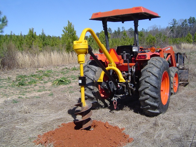

Been a while, but the project is complete. Here's the finished product.
Free tip of the day... Spend the extra 20 cents on nylon locking nuts for the shear bolt. The regular nut supplied with the shear bolt worked loose and fell off after 4 holes.
And if you wrap with a couple of turns of duct tape the nut won't go flying when the bolt breaks allowing the nut to be reused. MikeD74T
