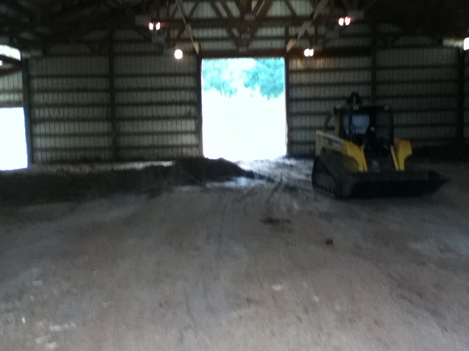

I have done very similar tasks with all sorts of machinery and a Skid steer is definitely the ticket to the right machine. That being said, lift capacity is a huge part of it all. The S175 lifts around 1700 lbs. which in reality isn't very much. When my step mom was in teh market for a used skid steer, lift capacity was the on top of the list. In research, we found that John Deere offers the best lift capacity in the CTL division over most every other brand. So in turn she got a CT322. Here are some listed on Machinery trader for a good price.
DEERE CT322, Used DEERE CT322, DEERE CT322 For Sale At MachineryTrader.com - Page 1
The CT322 lifts close to 2 ton, I have maxed it out before at that. The tractive effort is incredible. On Monday I used it on a job to clean out an arena that was buried from 1'-2' in manure. This was a build up over many years and it was very packed down. So I started off, the CT322 weights in at around 4 ton which provides incredible tractive effort and makes it almost unstoppable. i pushed through the spots that were 1' deep like it wasnt even there, i pushed some 50' before taking a scoop, it did not stop. The tracks also offer a smooth ride and make it very effective at grading uneven terrain. It has plenty of hydraulic GPM to power your post tamper as well as run a PA30 PHD in hard clay. The arena job took me 5 hours, I also scraped out an aisle way as well. IMO Deere also has the best roll back on their buckets, you can hold bigger loads without loosing them on the way. The visibility all around is great, i love the lower back window, it makes backing into places a lot easier. The 66hp engine is actually very quiet, the more throttle it gets, the quieter it gets. I know i am sounding like a sales man trying to sell you on the CT322, but this is just out of my great experience with one. It will out do an S150 as well as a S175, even a T190. Try one out and see what you think about it. :thumbsup::)
