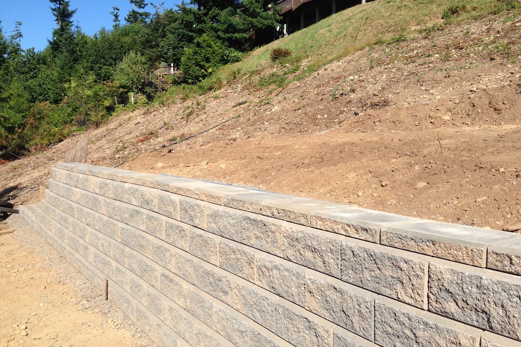

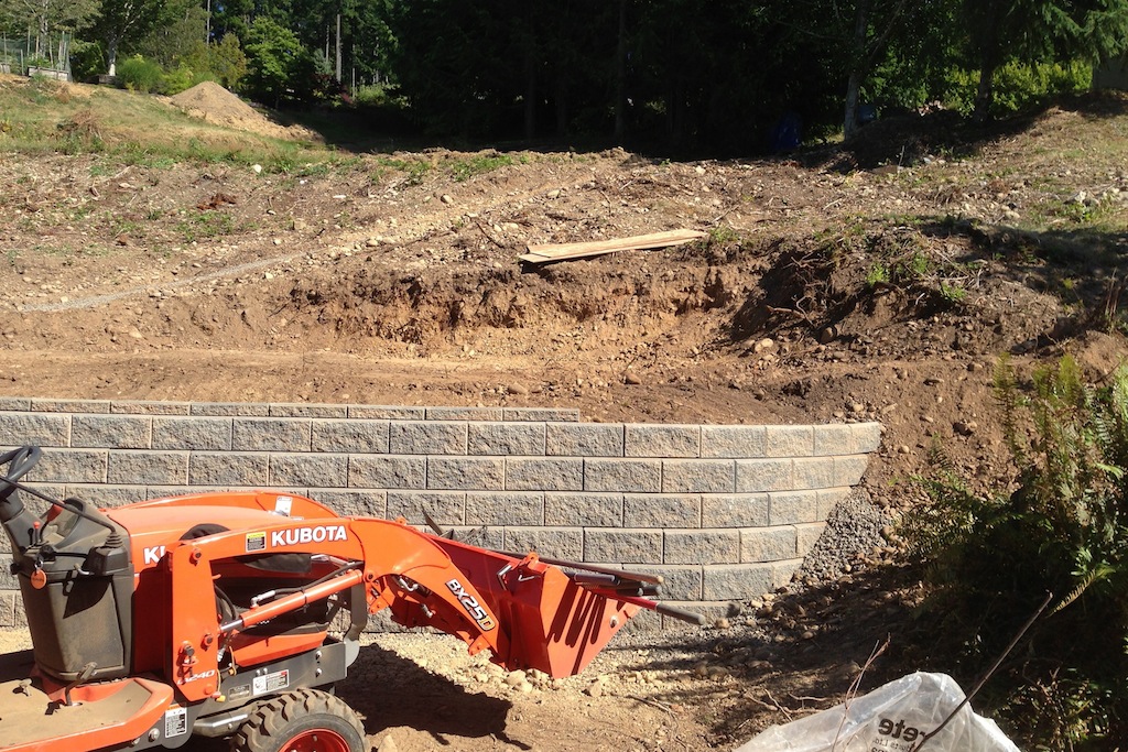

Okay I am not finished but it is always those last few details that take the longest! Here are a few more pics. I curved one end (to the right) into the hill and the other end which will meet up with my path that I cut to get down the hill, will have a couple of terraces (two block high) to create little stepped planters. Caps are still loose and I think I will do a little more compacting/filling before finishing them off. I also realized that when I decided to curve the ends and make the stepped planters, I just created a bunch more work. Now I will have to cut the caps for the curves! :eek:
I guess that means a diamond blade for my circular saw, eh? And a vibratory plate... $$$ I can't justify the daily rental if I do a few more days of wall building and I have weeks or months if I do all I want to do.
Overall I am pretty happy with my first attempt and the amount of work I was able to do with my BX with BH and Piranha tooth bar added to the bucket. If you look close in the background you can see the cut for my next retaining wall. I have learned a lot from the first one, for sure.
