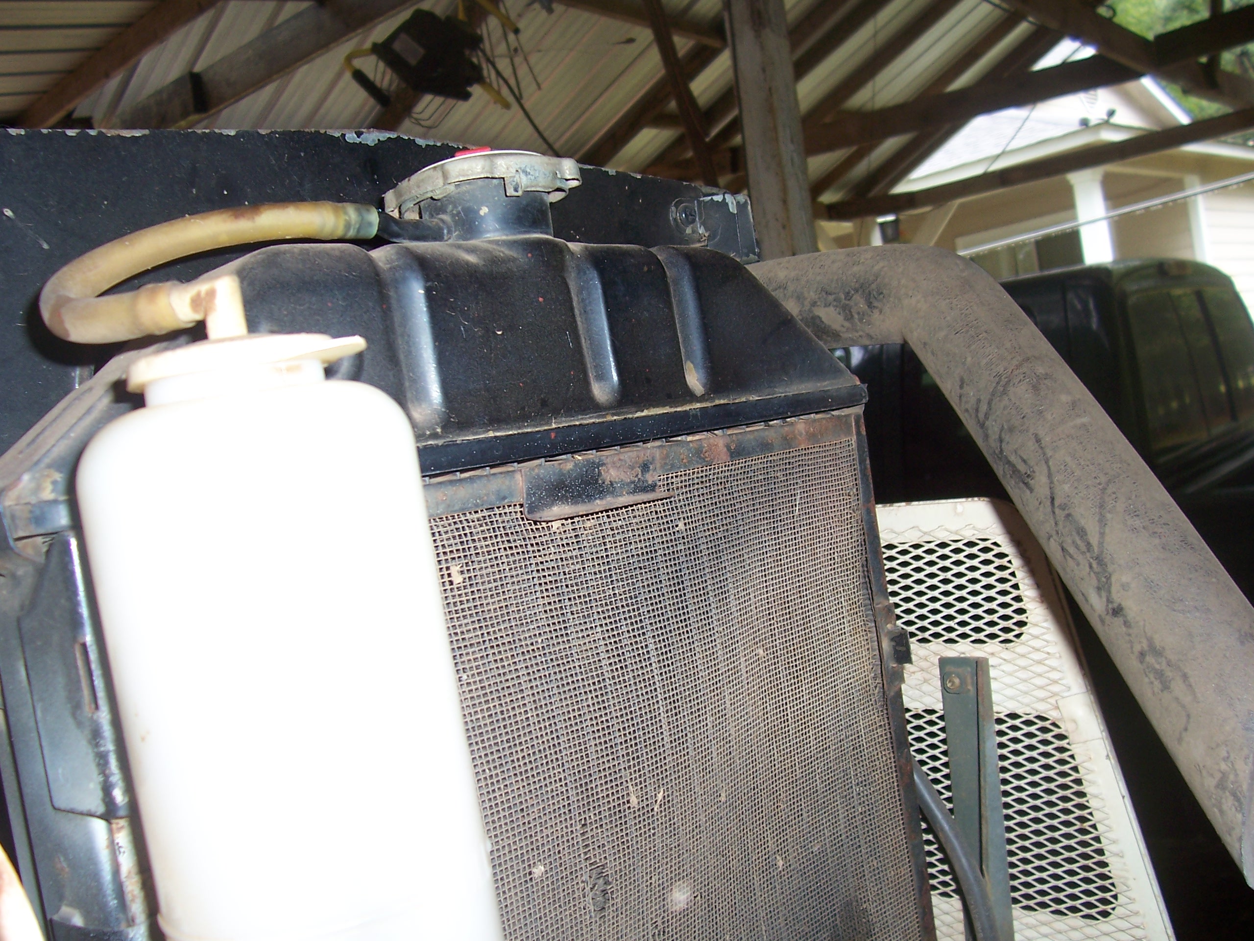

I'm going to do just that. I again, let it cool down and cranked it with radiator cap off and ran it for four minutes. Not a single bubble! So I'm gonna just add the pump.
For the uphill/downhill thing, when it's facing a decent angle downhill there is no pump to fight gravity and I think it just really "slows down" the syphon technique. Water still gets hot and comes out the top connection no water what. But it then has to fight gravity to push it uphill (motor facing down) back into the block out the bottom hose. This is the only thing I can think of. I double tested this, and both times when facing the tractor uphill (water out bottom hose then falls downhill into block) it never once got above 175-180. Very interesting.

A couple of thoughts -
I read somewhere that Model T's had thermosyphon cooling and had to be backed up hills sometimes in extreme weather to resist overheating.
Most important: If you have any suspicion of a bad head gasket it is critical to spin it with compression released, to blow water out of the cylinders, before attempting starting. Water is incompressible and can crack the piston rings, or worse.
And that thread I linked had a post from a dealer specifying at what temperature an OEM YM1700 warning light will come on. It is surprisingly high, maybe 240 degrees? It's worth re-reading that thread to get the facts. And of course a radiator cap in good condition is essential to run that hot without boiling.
I think any bubbles visible in the radiator (with no water pump) are suspect. If you don't smell exhaust there, then possibly a spot in the head is clogged and is boiling at that one spot.
There are diesel coolant additives that improve heat transfer and reduce cavitation. I don't know more than that, but the topic is worth investigating.

Thanks Cali! And yes, I have double and triple checked, ZERO bubbles in radiator with cap off. Absolutely none. I'll post back when my water pump gets here. I'm not gonna run it anymore and just go ahead and take it apart. I'm too ****/OCD for thermosyphin haha!

And also the radiator and cap are both brand new.
