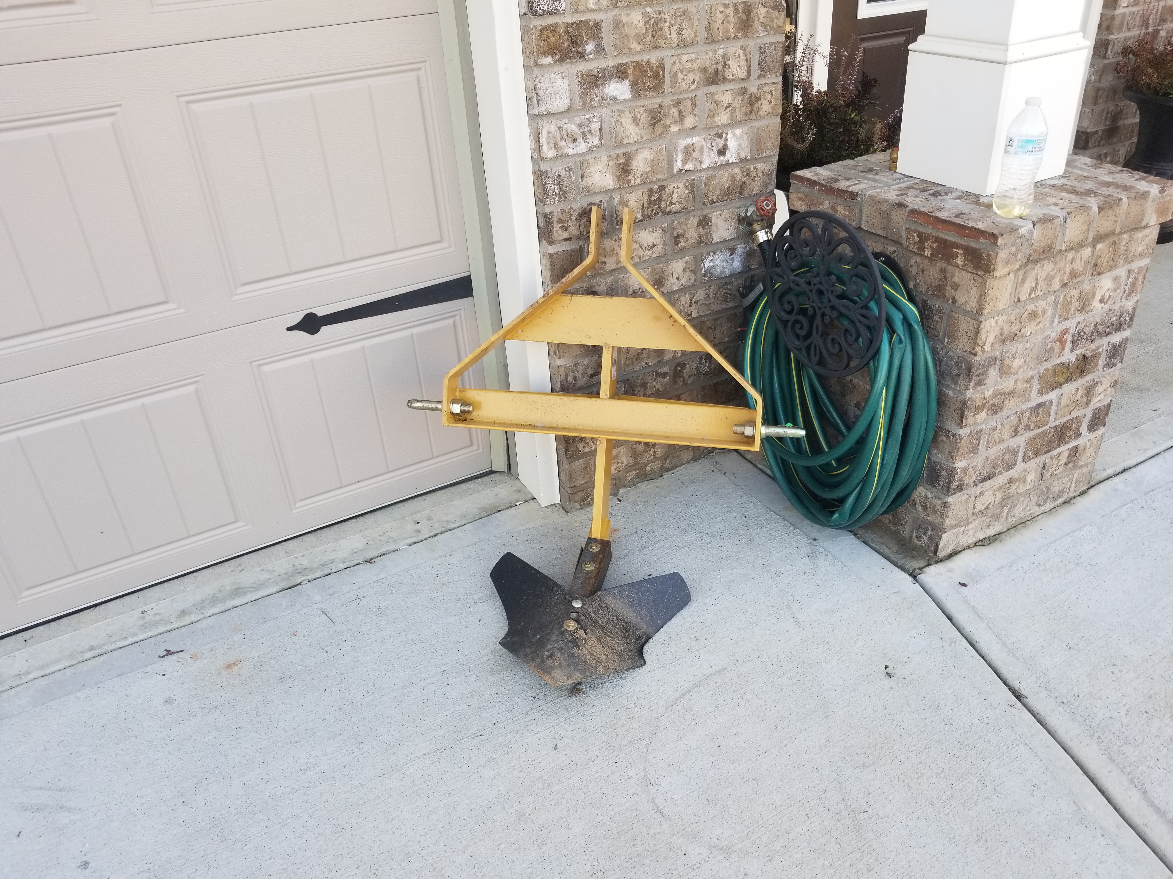

I found a King Kutter Middle Buster been used once for $90 I'm about to pick up today! May test it out today and try to rip some weeds/grass up behind the house.
   / My First Real Tractor! #264
Go for it! I've always wondered if these Yanmars have the traction to pull a 'boat anchor' like that. It should work fine .... Please report how that works out! :thumbsup:

Your ought to make some nice furrows if that is what your after.

Using it to break new ground for new deer plots. Then go over it with some discs or a cultivator to break up and even out the surface a bit- whatever I can find first haha!
I have used these before behind garden tractors and they are GREAT for breaking new ground!
I cannot wait to test it out!
   / My First Real Tractor! #268
It will work beautifully.
My uncle has one. I have never pulled it behind mine though.
