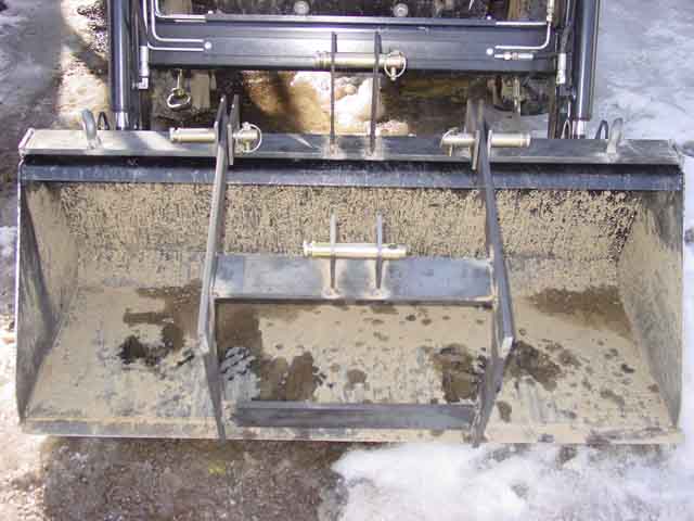

from the front
   / My first tractor grapple
#32
I received the cylinder and the website showed the wrong schematic for it. The schematic shows pin to pin of 10"-16". It turn out that this cylinder is more like 18"-24". Rats. So I took to modifying the grapple, which was already fully welded. I finally finished the changed to allow for this cylinder...about 3 hours of work.

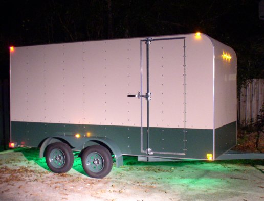

   / My first tractor grapple #40
I agree about price. Our Boy Scout Troop built this in my driveway for about $2300, including custom shelves and lighting inside. We did get paint donated for the fenders and frame, but it's still much cheaper than a comparable trailer would have cost. Cheapest dealer quote was $3500 without any custom interior.
