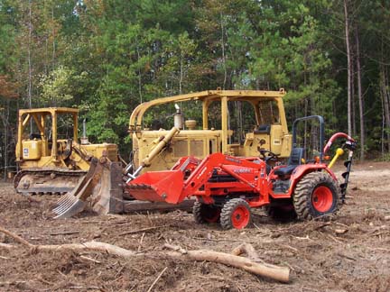

FEL too high, ground too soft, and a bad choice of counter weight on the back end. I had been working with the tractor for about 4 hours when it tipped. Been going over the same ground laying in fill dirt in a depression when the ground gave way under the front left wheel. All said and done, I walked away with a h*ll of a scare, a great lesson and almost no damage to the Kubota. Some friends that stumped and graded our property had some HUGE Cat dozers out back when this happened and they put me back on my feet. They've been in the earth moving business for over twenty years, and were too happy to share all of their war stories. Flipping dozers, excavators, tractors, etc. Made me feel not-so-bad about laying down my baby! The pic is the Kubota after I gave her the once-over and a bath, and her paramedic!
Maybe it's just something about GA clay that likes to suck in tractors!
