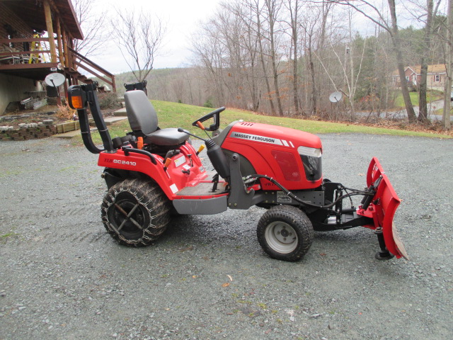

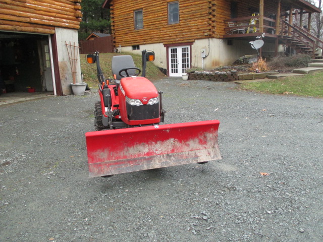

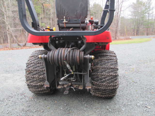

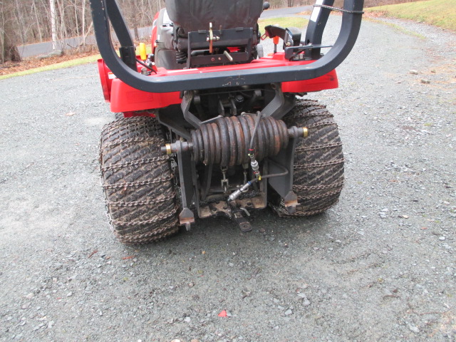

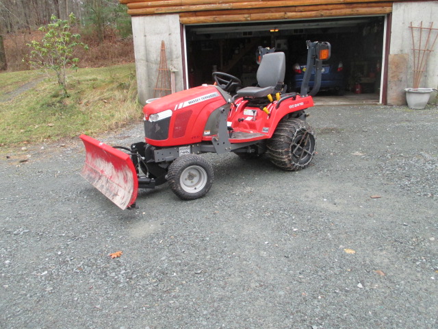

Added 100# of barbell weights to the backhoe frame. I could do the same on the bottom bracket but would lose my trailer hitch.

Where can i get more info on the blade setup? Also for the weights what did you put them on?
   / My GC2410 ready for snow (if it ever comes #6
I have a 2400 and have V-bar chains on the back and chains on the front. I also have 400 lb of crete on the 3-point hitch. I also have a hill that is pretty steep and slopes to one side. With out chains i can plow down but have a very hard time getting back up even with the plow up. On flat ground I would not even use chains or the weight. Ed
Don't have enough room in my garage to leave the backhoe on. I have to park it sideways in a two car garage behind a tiny Honda fit and a SUV on the other side. The blade is factory and the weights are just on a 1" bar with collars on the end to keep in place.

Also if you leave the backhoe on it would seem you have 3 other issues:
1. Too much weight . . That backhoe is heavy and leverage outward where ballast weight is lower and closer to the back wheels.
2. Rear clearance angles. The backhoe hangs lower and has less angle clearance compared to ballast weight. So with ballast weight you can go from flat to a steeper tighter incline without dragging or getting hungup.
3. With backhoe on your manuevering circle and backup issues changes compared to ballast weight. And how far back behind the rops does the backhoe extended compared to ballast (extend in height and extend in distance back).
