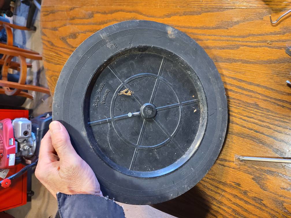

On the outside of the wheel there should be a pin with a spring that when you push the wheel on the axle it snaps in that groove..
Bingo.. Moss’s video shows this. It appears the spring part has failed.

You will observe that the axle has a notch where usually a clip pops in.
Clip is now trashed.
Measure as carefully as U can, go to the plastic wheel drill a small hole that aligns with that axle notch and insert a cotter in, nail or whatever will engage that notch and U should be OK.

Thank you, I’ll try that tomorrow. The lid failed a couple years ago and a dowel fixed that problem. I ended up taking it off since it’s just a glorified wheelbarrow.

Fixed it!
I drove a #6 screw until it hit the axle and backed it out a turn so both wheels can continue to turn independently from the axle. I have no doubt this will eventually fail so is a stainless screw a better choice?
I couldn't figure out how to use a cotter pin.
