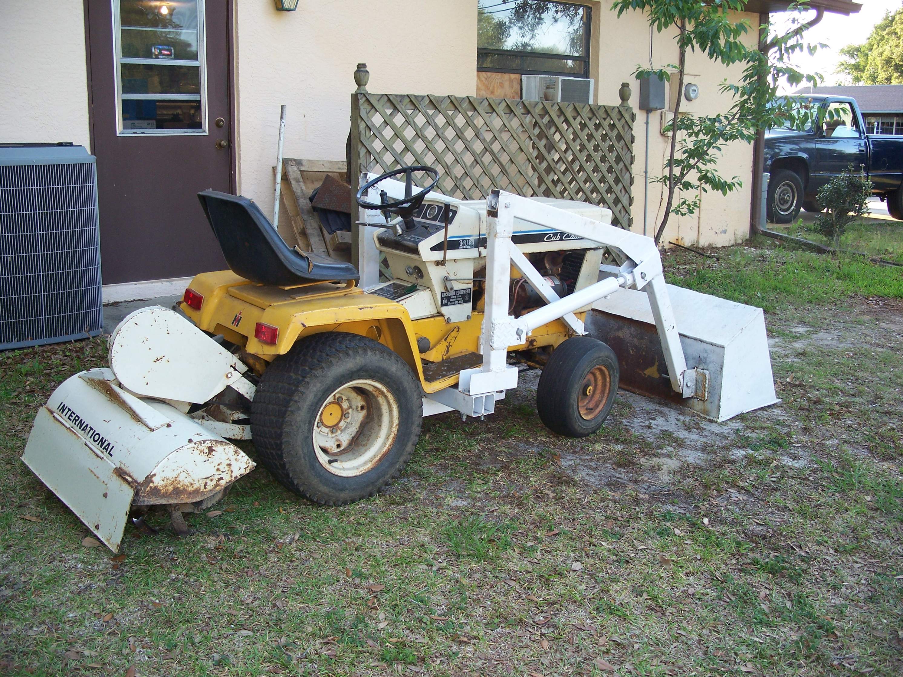

i think i put a picture on here, if not i`ll keep trying.
everything for this is made from steel i had on hand. all the arms and tower uprights were a big steel table i had. there was a 4' x 6' 1/8 diamond plate steel sheet for the top which i used for the bucket. i got 4 sides out of it and the guy who gave me the table gave me a 1/4 piece for the top of the bucket. the cylinders i got from northern tool along with the pump. the valve came off of a 318 john deere i bought off of ebay. the tiller came with the tractor. i designed the loader so i can run the tiller at the same time. the tiller runs off the front pto like normal but the pump runs off of a stock pulley that the drive shaft links to.

Lot of respect for those who build with what they have on hand. Looks good.

thanks, whenever i find a nice piece of steel i save it. at first i didn`t want that table the guy was giving me as i thought it would be too heavy and big, but then i thought about my loader dream and said i`ll use it as a table until i get the tractor to put it on.

Just be sure to watch closely for any possible weak spots the first couple times you use it.
   / my home built loader so far
i sure will don87 i have had the bucket on there and had put long 2x4`s where the lift cylinders go. i stood and even jumped on the bucket (i chained the bucket to the front horizontal brace) and it didn`t even flinch. i estimate the bucket weighs about 125 lbs and i`m now about 180. i will start light on the lifting. most stuff i move is only about 2-500 lbs any more than that i use different means.

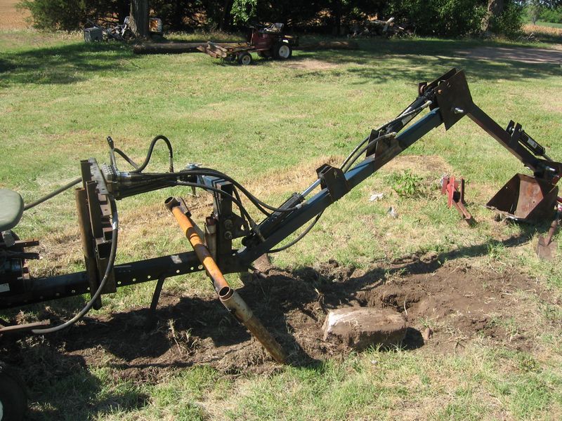

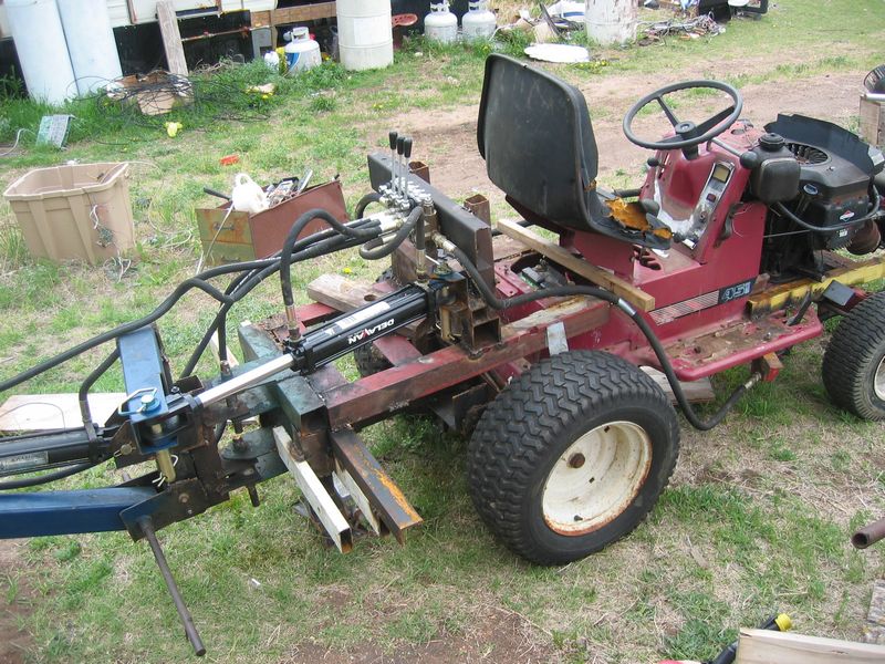

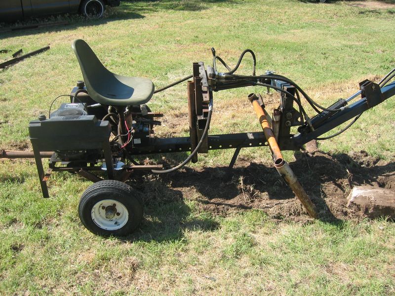

Awesome. I have an old sears lawn tractor that's pretty sturdy built and has a great trans axle in it.
Once I finish my backhoe project I plan to add a front end loader to it.
I'll use the twin cylinder engine I took off the lawn tractor I was making my backhoe on.
The old lawn tractor is in disrepair. The trans axle is shot in it. I was gonna put a front end loader on that one. But have decided to put it on the better tractor.
A front end loader and fork attachment would come in really handy to move old washing machines, refrigerators, water heaters and other light weight junk metal.
I might get started on the loader next summer. Get that old lawn tractor back to work. "Dad bought it from a friend for us for $200.00"
The plastic fuel pump broke on it and we never got it fixed and the engine sat and seized up.
Also could make a grapple and move brush with it. Hey another project. I'm just sitting here and getting ideas. lol
Chad
PS. Let's have a moment of silence. The old lawn tractor that I started my backhoe on, in the picture is about to go to the shredder. :eek: Probably sometime this week.
Bye, Bye little tractor. I'll miss you. "wipes tear from my eye" lol

i got all the steel for free, the valve on ebay-$80, 2 lift cylinders for $79+tax+shipping= about 120 each. the pump from amazon (free from gift cards) and 1 bucket cylinder free from amazon with gift cards. now i need the hoses and fittings and to make the fluid resovoir and all the lines. i still need to mount the bucket cylinder when it gets here,the 19th of june.
