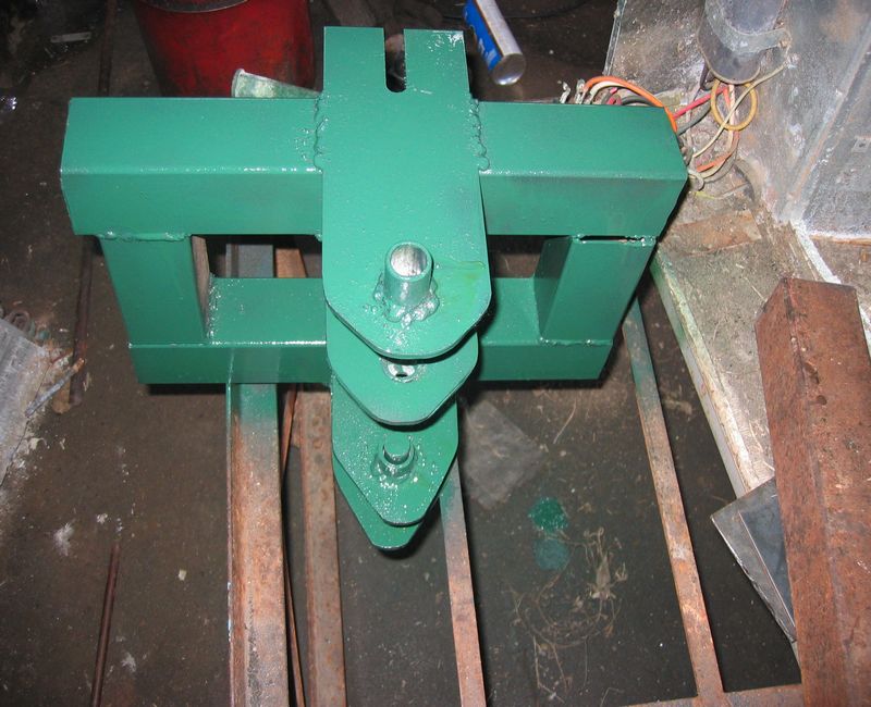

I love the project Chad! Good for you. Keep the pics coming and like the others, I'm dying to see your first use video! :thumbsup:

I've changed the design of the pivot for the swing. I had a piece of 3" x 3" square tubing laying around so used the air grinder to cut it down, so I could make this new pivot.
I also had two pieces of metal gave to me, that had the right size holes in the right spot for the bushings. That's those 4 top and bottom pieces that have a curve in them. They were longer pieces and bent as legs for a table. But I cut them out to size and used the grinder to cut the angles into them and then smooth them with the bench grinder.
I'm also gonna order some more 3" square tubing for the boom and stick.
I'll be sure to keep everyone updated.
Chad
