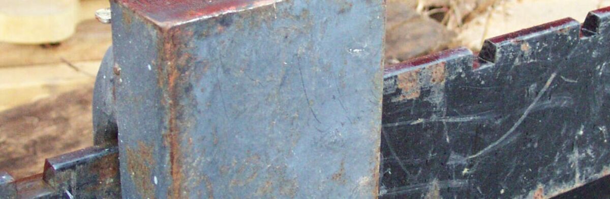

Well, not much left to say in praise of your fork job that hasn't been said. The forks themselves look exactly like what I have on my Kubota 4610HSTC. I don't know if you got any specs with yours but mine are rated for 1300LBS, some less than the shorter forks.
About those toggle latches on top of the forks: those are designed to lock the forks so they don't move in or out getting wider or narrower from any side force during use and they are made to work with a series of detents in the top rail that the forks slide left and right along.
While you could probably get by most of the time without the detents, some day it could take a big bite out of your backsides.
In the picture you can just barely see the sort of brass colored lever almost hidden behind the top of the fork. The detents aren't evenly spaced but are symetrical about the centerline.
Im not a pallet fork expert so I don't know if there are industry standard fork width settings but if you are interested and don't have a convenient source for dimensions, I would be happy to measure the patern of detents on mine and get back to you.

Hey Pat,
It would be great if you could check the spacing on the detents. I was just about to ask if there was some standard or something for the spacing. Thanks!
