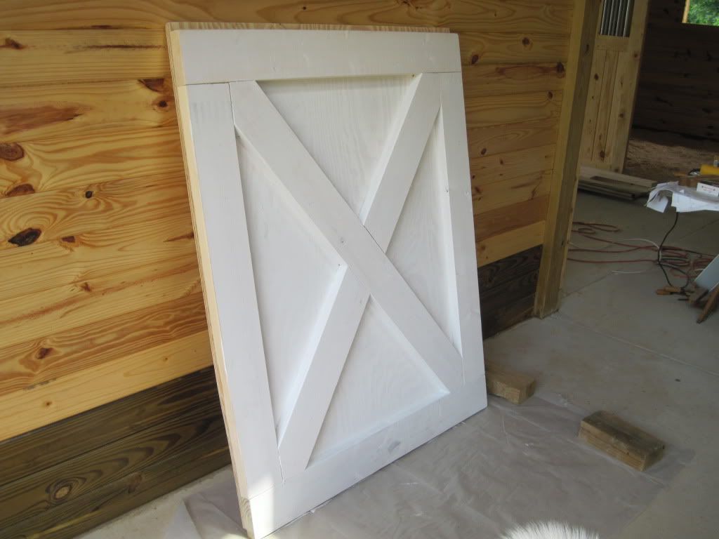

This weekend I built the first set of dutch doors. They still have to be primed and painted before I hang them, but hopefully they'll look decent once they're up. It was nice to get back to working on stuff that's visible again. The last couple of months have mostly been consumed with stuff that's supposed to be as invisible as possible.

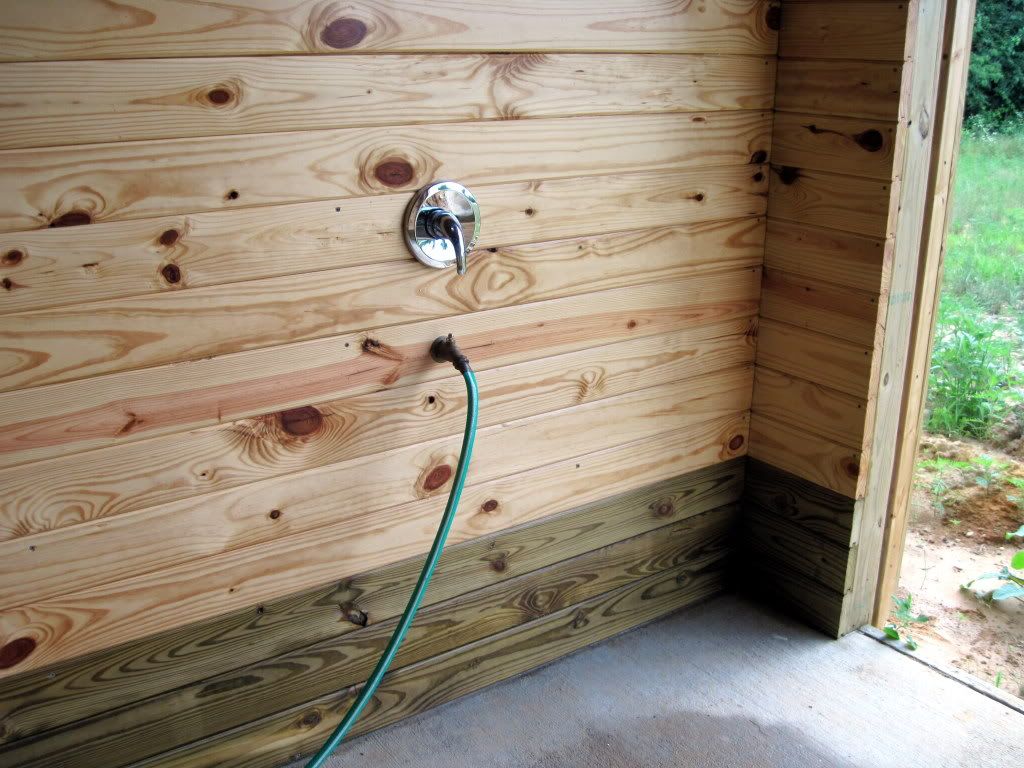

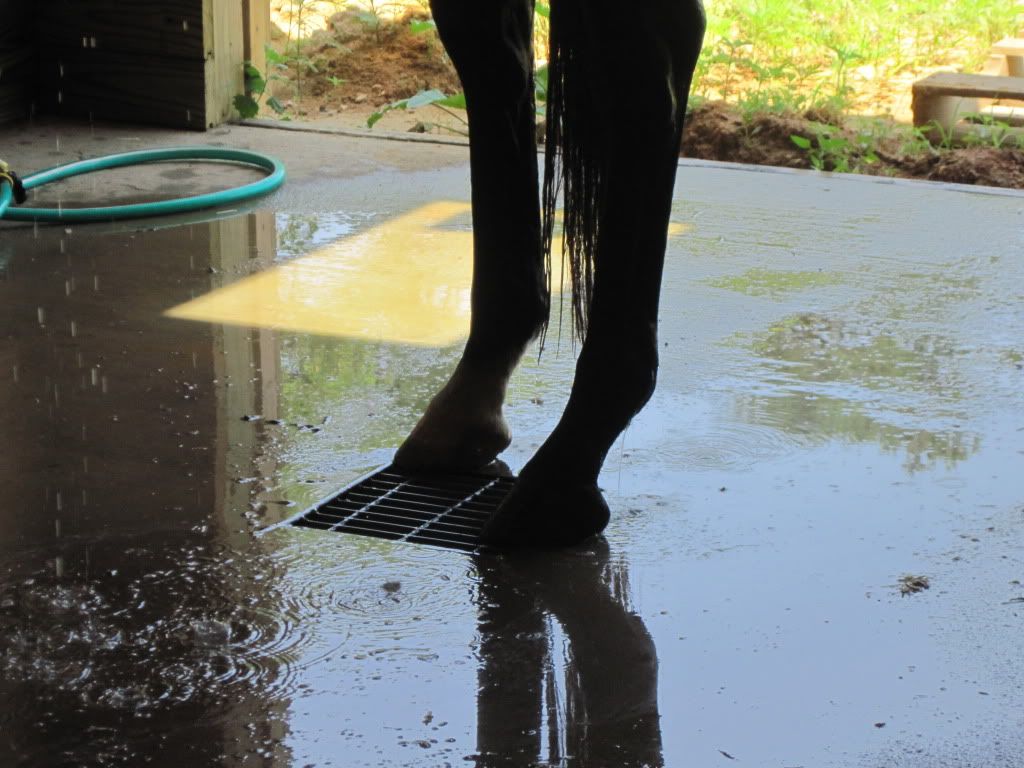

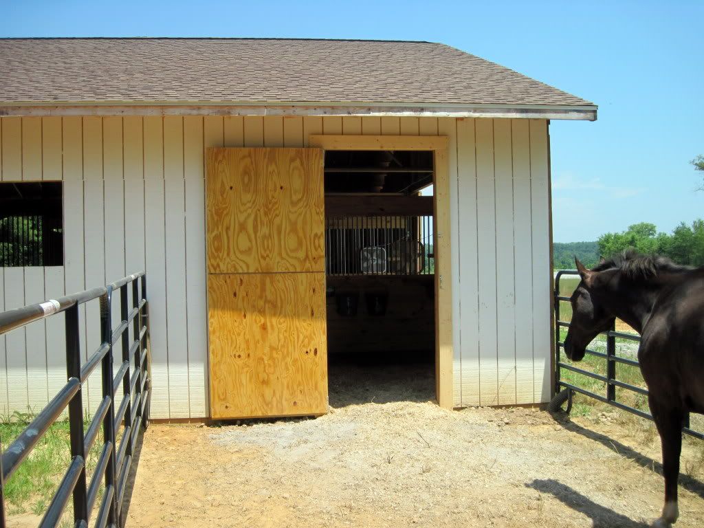

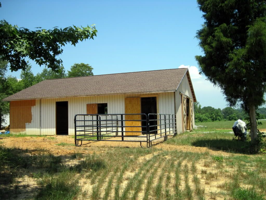

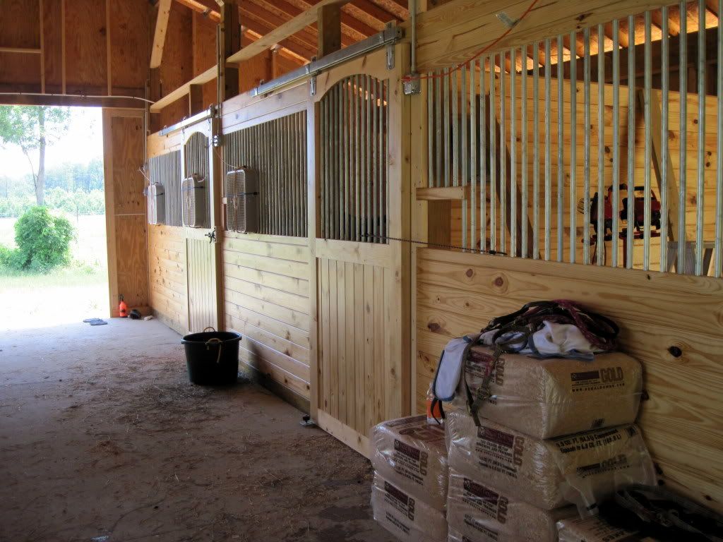

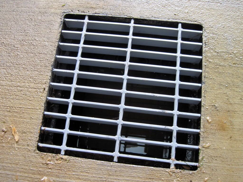

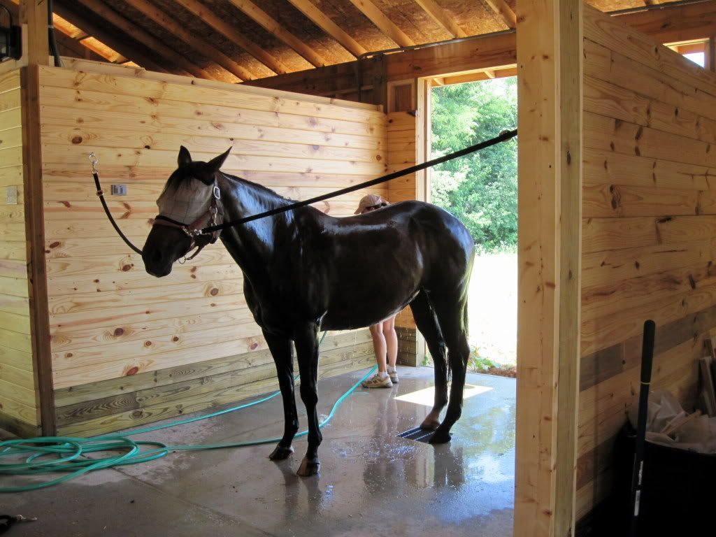

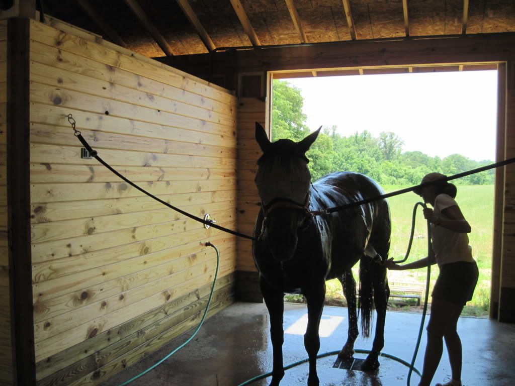

I'm happy to report that I've got the wash rack completely functional, along with three of the five horse stalls, including one with a set of dutch doors to an outside paddock.
For the floor drain in the wash rack, I went to a local steel company and had them cut up a chunk of scrap steel bar grating to size for me. It cost me $20, but they got the size perfect to fit into the catch basin. The horses have been standing on it, and it seems to be holding up just fine.
The horses really seem to appreciate being able to look out the open doors of the wash rack while standing there in the cross-ties. It also makes the barn a lot cooler being able to have that door open on the north side.
Some pics:
One of the dutch doors primed and ready for paint:
Some shots of the wash rack:
A couple shots of the dutch doors after installation (sorry, I haven't taken any with one or both closed).
And finally one showing a recent shot of the stall fronts.

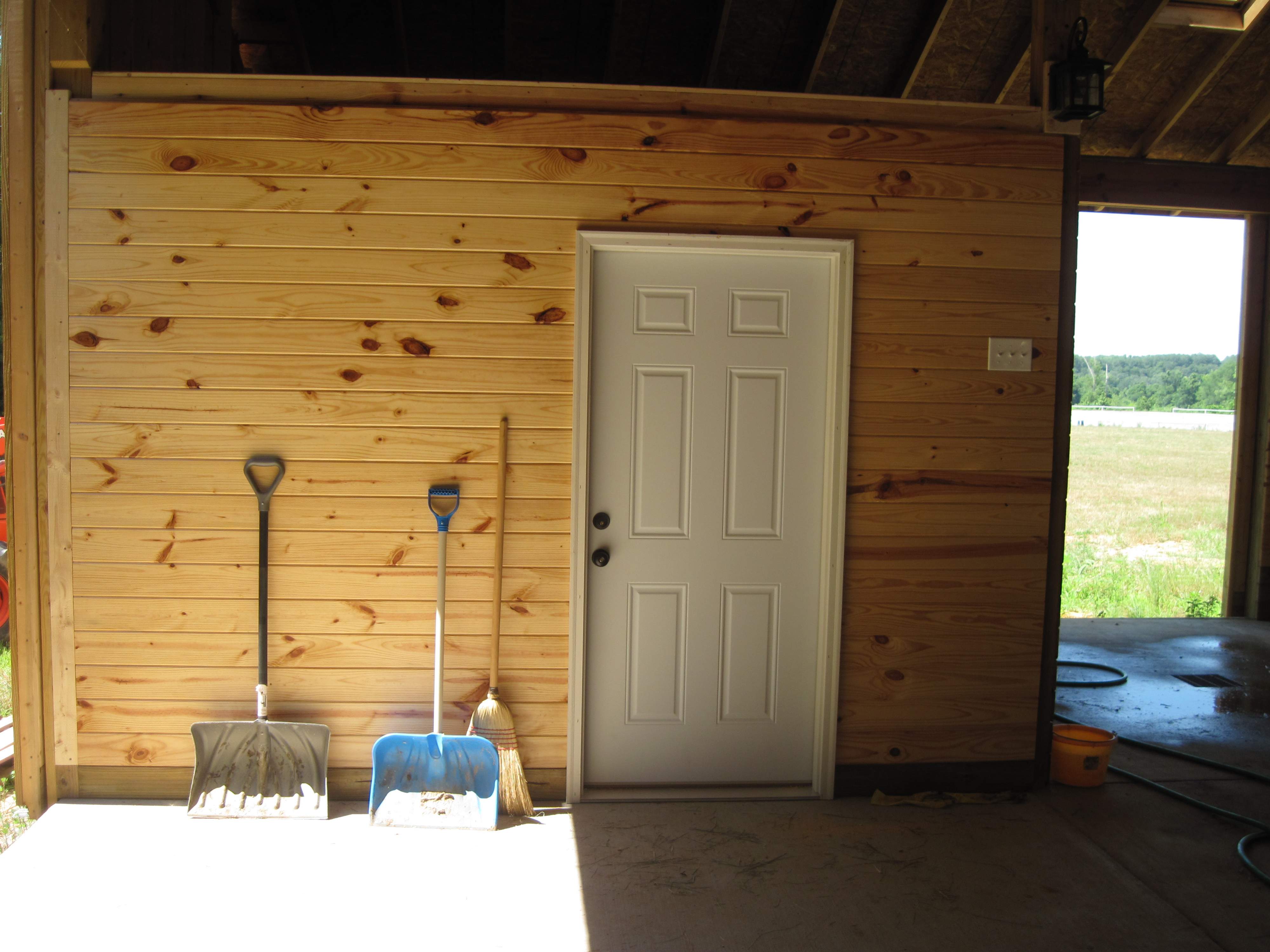

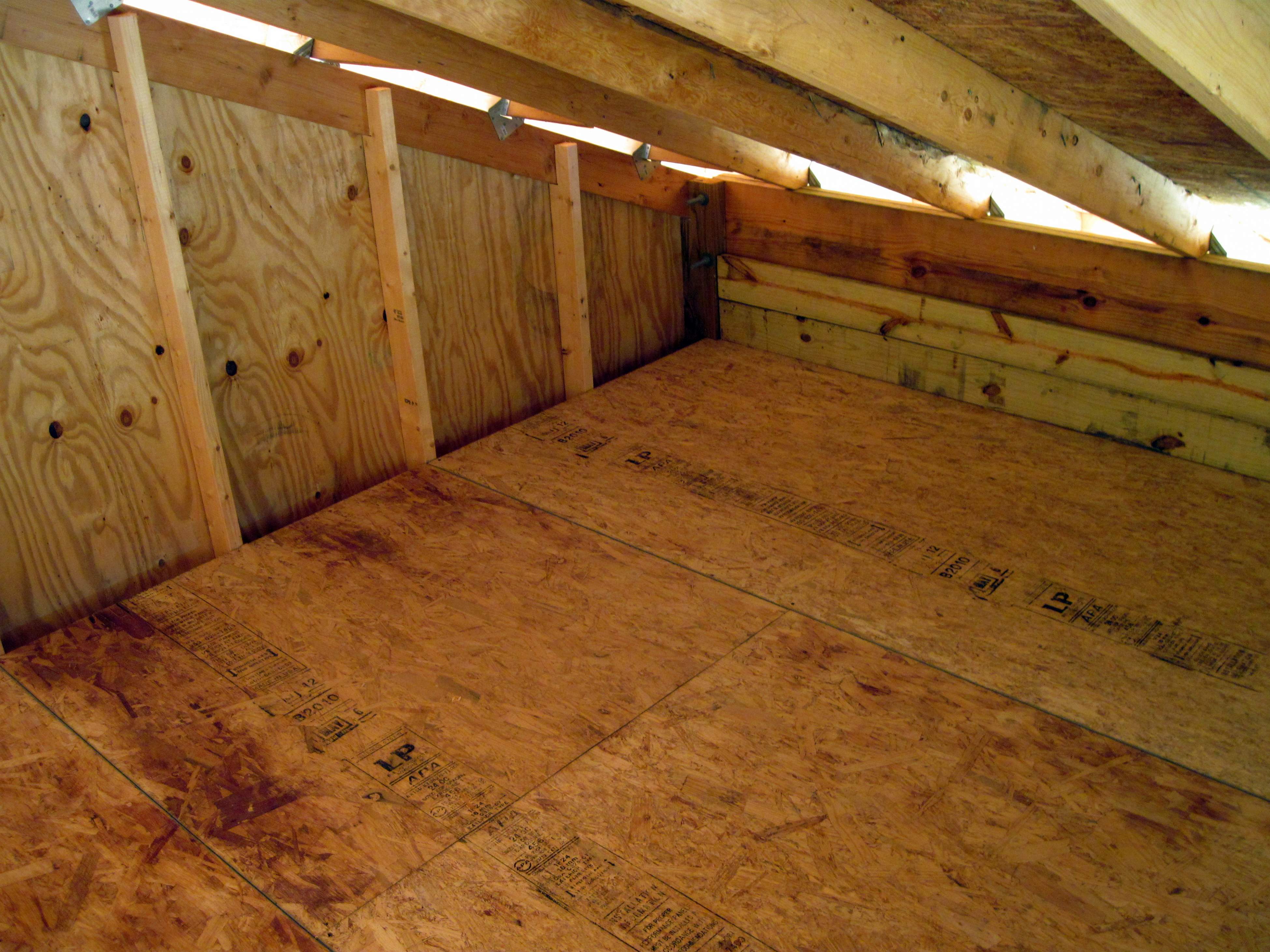

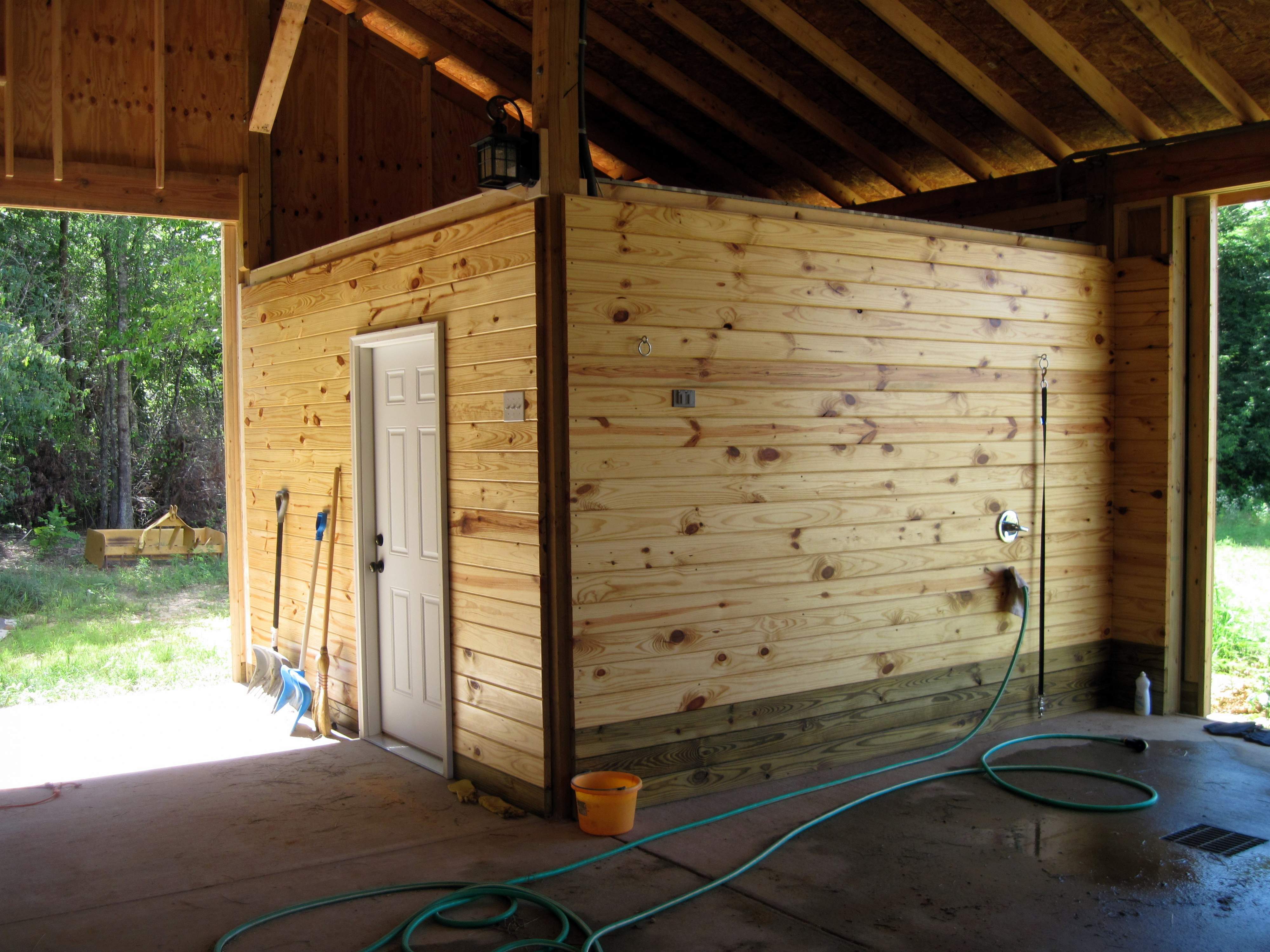

Step 18: Tack Room

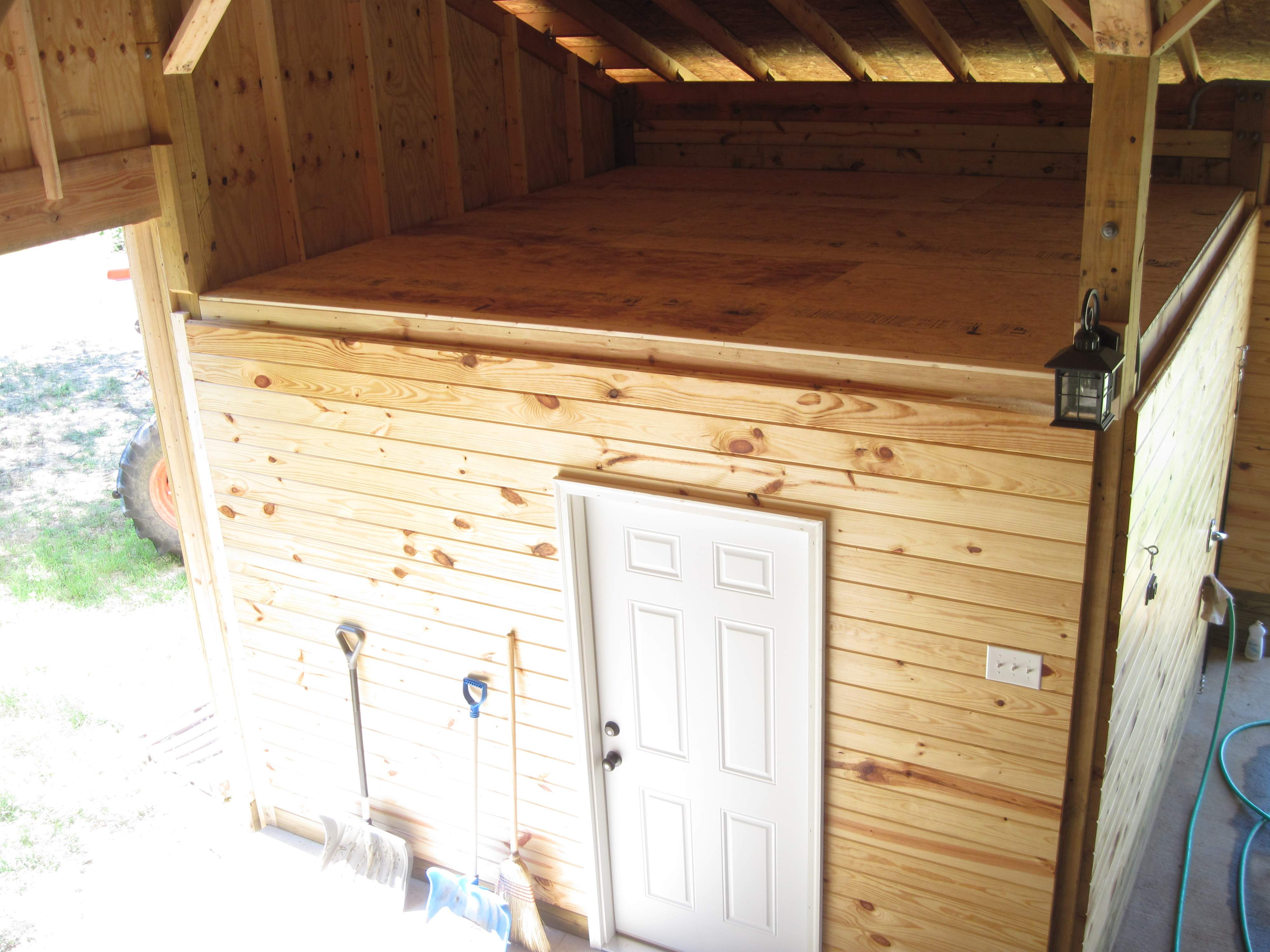

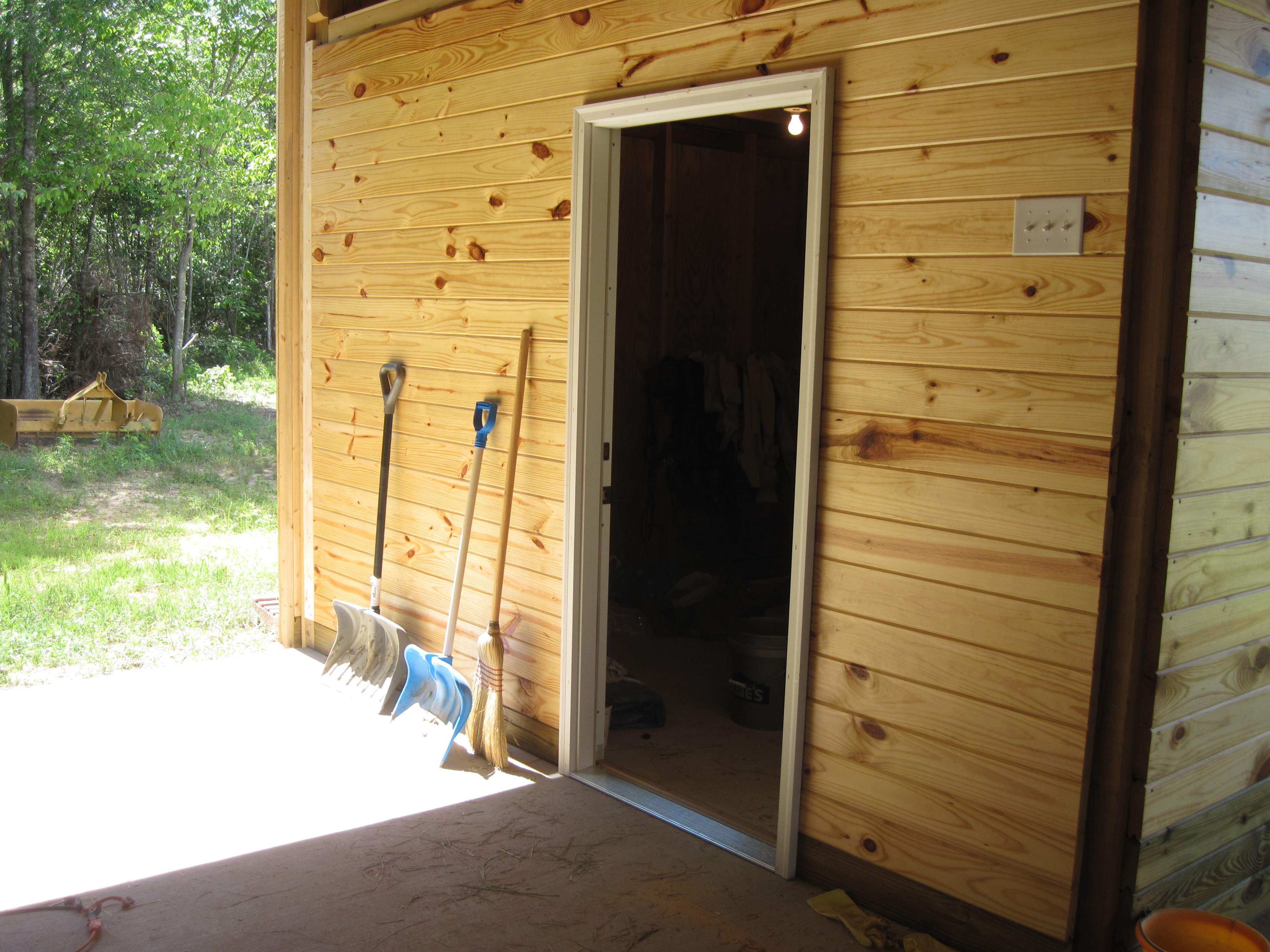

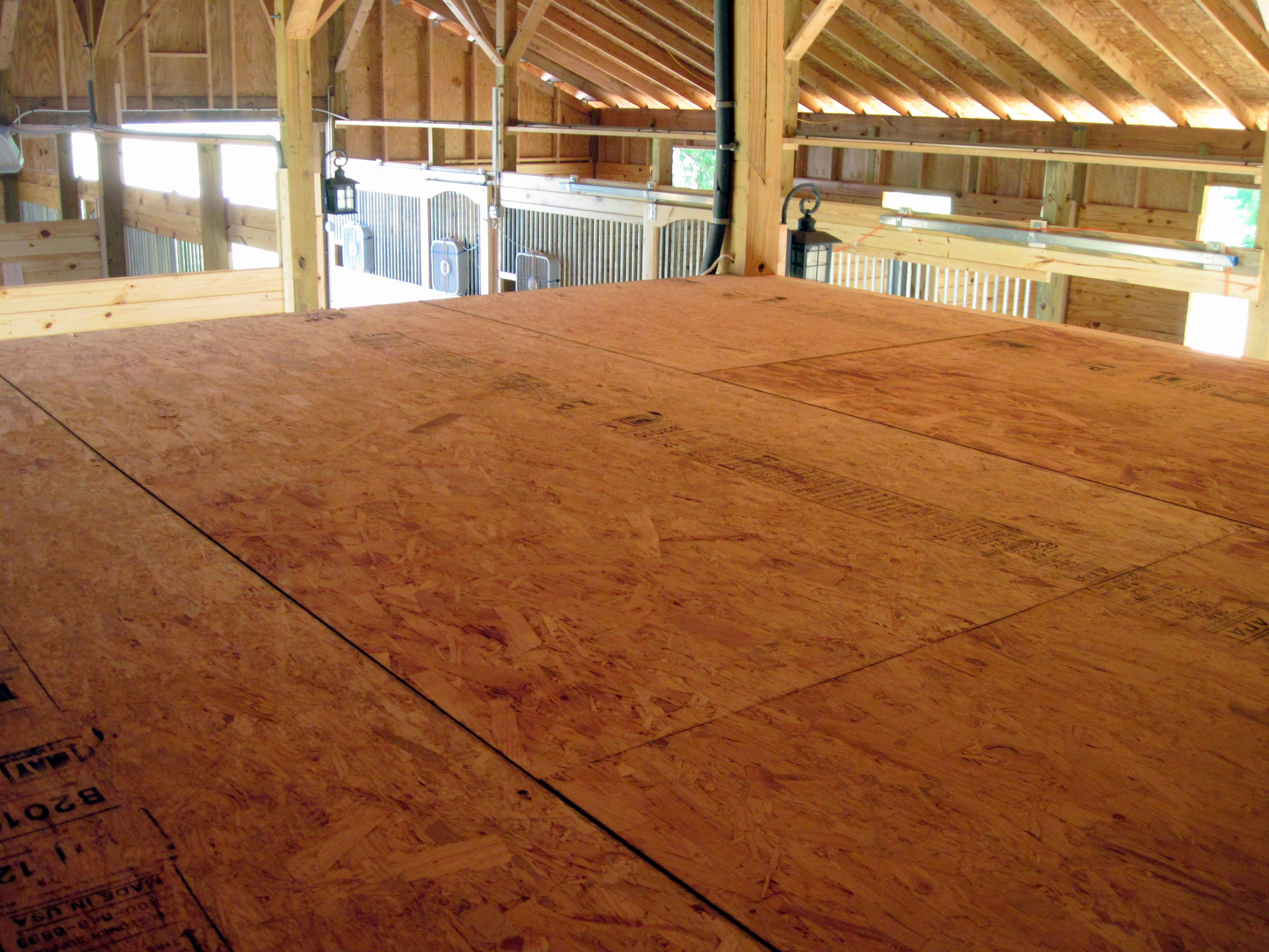

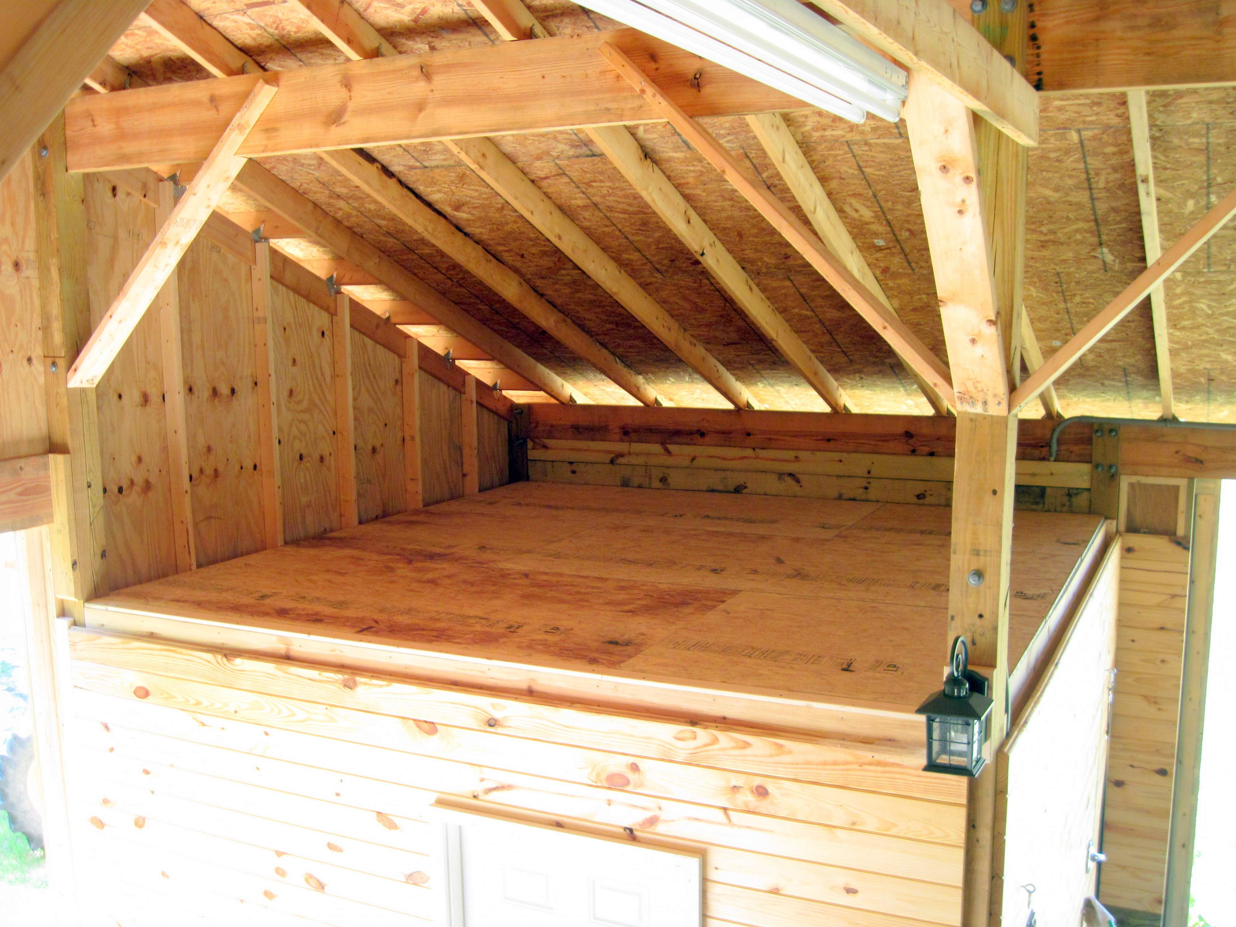

It's been one year to the day since I started on the barn!! A year's worth of weekends is a long time, but I feel like I've done okay all in all, especially considering that I've done about 95% of the work by myself.

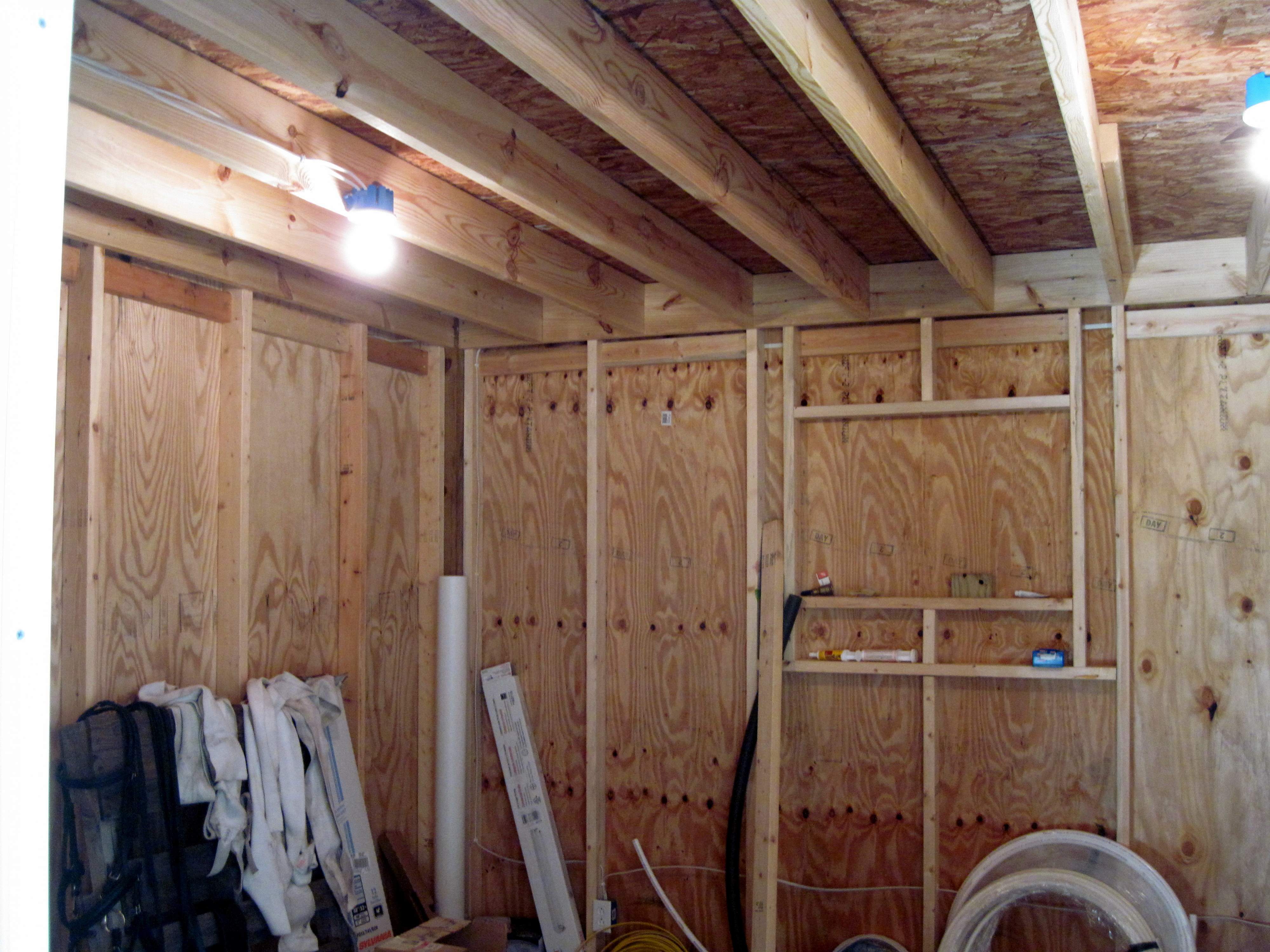

We now have three horses living in the barn, so I had to finish the tack room/feed room so that we can store grain in a (hopefully) rodent-free environment. SWMBO is getting pretty sick and tired of shlepping back and forth between the house and the barn.
Temperatures in the 90s notwithstanding, this made for a relatively easy weekend. I had to lay the loft floor/tack room ceiling and install a door. I used 3/4" T&G OSB for the floor. I paid almost $20 per sheet which is more than double what I paid for the same material a year ago! I also came to realize that once you discount the tongue, those sheets are only 47.5" wide. That meant that I came up 1.5" short when trying to cover the 12' span. :mad: I made up the difference with a strip of pine that I milled with a matching tongue. In the end, it was probably just as well since the pine has a much nicer looking edge, and I was able to easily round it over so it'll be easier on the shins when climbing up into the loft.
The door was relatively trivial - just a generic steel pre-hung door. Other than ticking off a few wasps that had nested up between the members of the door header, the process was pretty much uneventful.
In the short term, I'm planning to put a wall-mounted AC unit in the tack room. I didn't get to it yet, but I'll hopefully get it done sometime this week. Eventually I'll put drywall or OSB on the walls and ceiling inside the tack room, and I still have to install a utility sink, but those are fairly low on the priority list.
Here are a few pictures:
