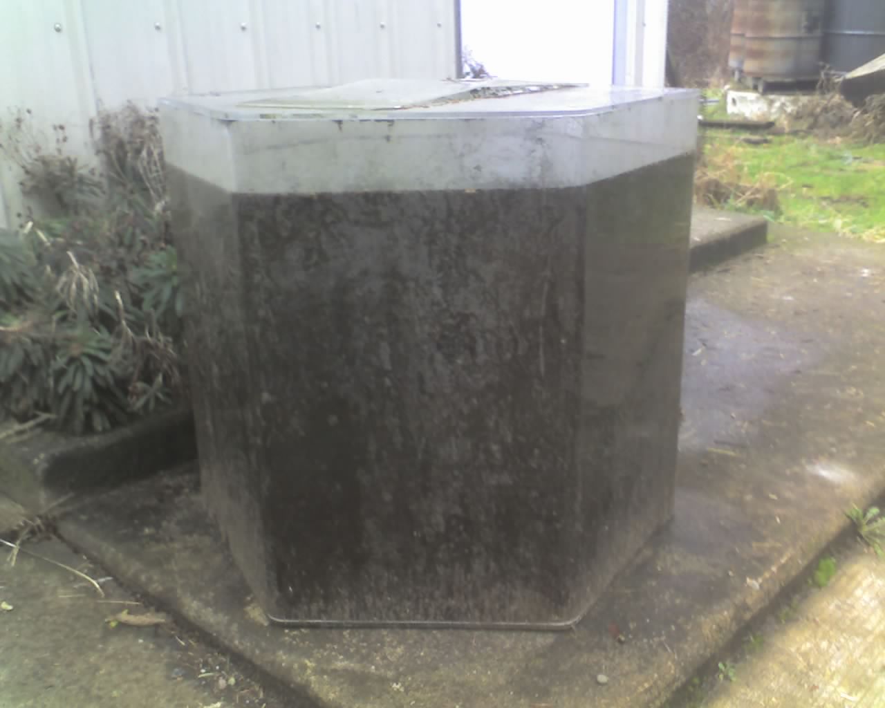

Yea, we're pretty wet this year. Most summers, by August, I can dig down 4-5 feet before finding water. Sometimes deeper. Last summer we never really stopped raining. I was lucky to get to 18" without having standing water in the ditch/hole and then fall and winter came again. My son grabbed one of our old aquariums a few days before Halloween because he wanted to bring it home. I took a picture of it yesterday. Now keep in mind that the top of the aquarium is not completelly open so there has to have been more rainfall in the last couple of months than just what got in the tank.

Wow! That's some serious rain! On the bright side, you can be glad that didn't all fall as snow!

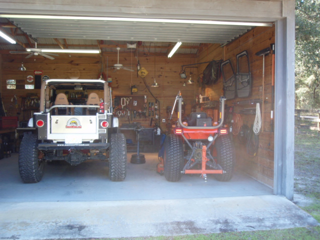

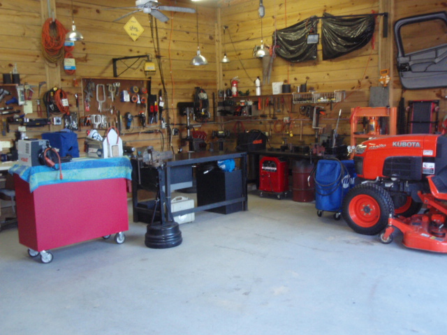

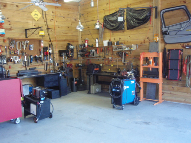

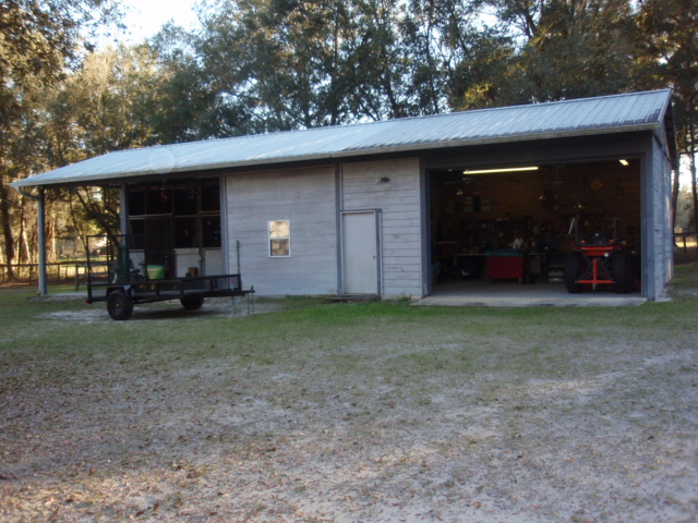

Great thread and a very nice build..P1010035.JPGP1010013.JPGView #3.JPGP1010039.JPG
