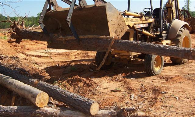

Thanks to everyone who took the time to reply to my other post about getting a patent. I honestly don't know if I'd qualify if I went that route, and even if I spent the money and somehow received it, there's no way I could inforce it anyway.
Too much money, heartache and effort for something that's very simple for anybody to make themselves. I've croped the pictures just in case I decide to sell the plans on how to build it, but plenty of you will grasp the concept as soon as you see the pics.
What is it?? /forums/images/graemlins/smile.gif
For now I'm calling them Bucket Fingers.
They are an attachment that works off the existing hydraulics already on the front bucket. The bucket stays in place and is half of the operation. The fingers open and close just by opening and closing the bucket.
The advantage and attraction of this for me was not having to run any addition hydraulics. No hoses, no control lever, no quick connects and no hose lines. The amount of steel is minimal and all flat stock. There's nothing fancy here, just a few holes for pivot points, some cutting and welding. LOTS of welding!! /forums/images/graemlins/grin.gif
The bucket is tilted down so it doesn't pick up any dirt, but will go right over a log or brush pile. Than you close the bucket and the fingers close at the same time, holding everything they grab in the bucket.
Eddie

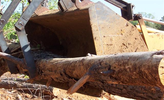

My tractor has a one yard bucket with a fair amount of lift. I can handle most trees I come across.

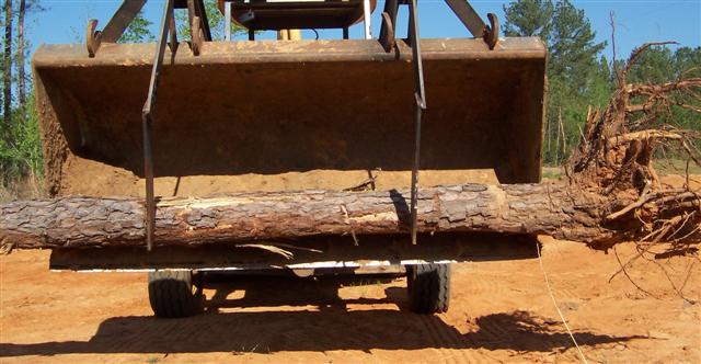

I wont go into details, but another thing that I really wanted in this was to be able to put it on and take it of without any effort. Regular grapples require the bucket comes off. That would be a hassle that I wanted to avoid. The other type of grapple requires attaching it to the bucket and weighs quite a bit. Not impossible, but a pain to take off and put on.
This comes apart in pices and is easily installed and removed.
The final advantage is it's around $200 for all the materials!!
Eddie

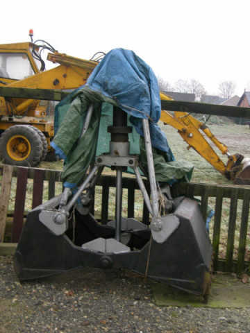

Works just like a clamshell drag bucket or pulp loader. One action is xfered to the other set of jaws. Nifty idea, I'm sure i've seen that on old timely cable powered equipment before they had hydraulics.
   / My Invention #9
The basic functioning is exactly the same as this bucket: Think of the right part being the backhoe loader bucket, and the left part being the grab.
The basic principle is old as the road to Rome, but the application is fresh thinking /forums/images/graemlins/smile.gif
