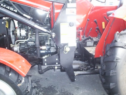

   / My KAMA 454 has arrived! #17
Patrick, attached are a few pics of the muffler mod. I used 1 1/2" black pipe cut'n'thread then welded. I used a muffler from TSC and a 1 1/2" circulator flange for the manifold.. Its out of the way and a lot quieter ... Scozz

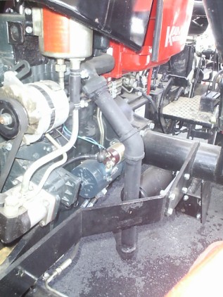

   / My KAMA 454 has arrived! #18
Another
