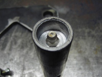

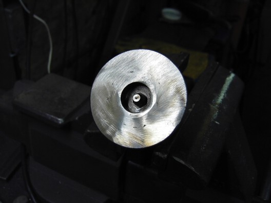

I made new pins today and I drilled out the center portion of the pin to allow for future greasing of the pin when installed on the hoe. I recessed the area where the grease zerk went so hopefully I won’t knock off the fitting when digging. At one end I drilled a ¼” hole to accommodate the bolt to pin the pins to the ears when installing the bucket on the hoe and on the other end of the pin I welded a large flat washer to make it easier to pull the pin.

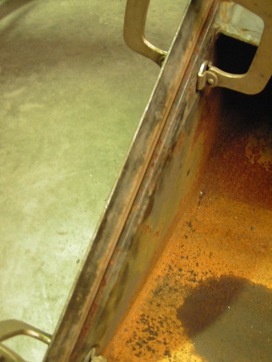

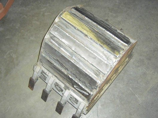

After sandblasting I noticed that the bucket had no wear plates on the bottom. I thought it might be a good idea to weld wear plates on the bottom of the bucket like the Gannon buckets have, so I added some ¼” wear plates to help prolong the life of the bucket.
Bill

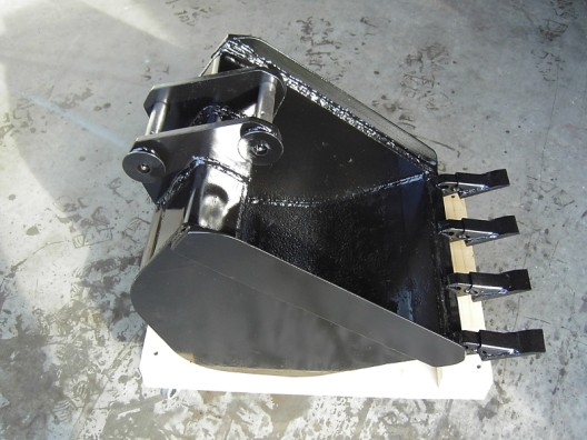

Here’s a photo of the finished bucket, ready to get dirty. I have a grand total of $149 in rebuilding the bucket, plus my labor. What do you think I should charge myself for the labor???
