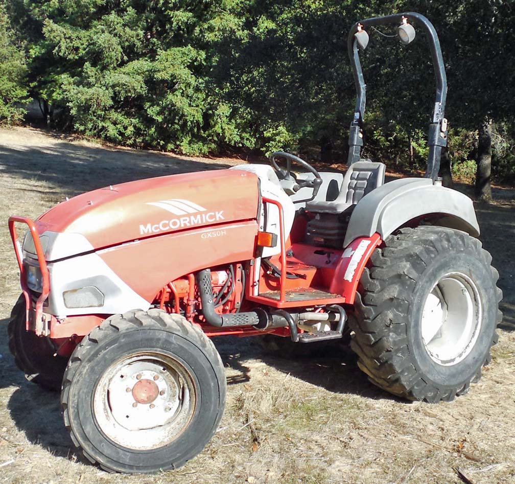

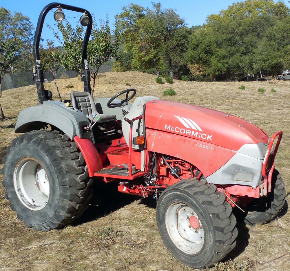

Well the McCormick is back together and running. Most (or much) of the time spent on this project
was dealing with electrical interlock problems. There are more than 20 relays, and some are bad.
Cascaded relays are easy to damage while testing in that you can fry the coils with a 12V battery...
you need to limit the current. To get this unit running, several relays have been jumpered. The
electrical diagrams in the manual are the worst I have ever seen, automotive, tractor, M/C, or ATV.
Anyway, the driving experience is excellent: the servo-controlled HST has a built-in delay when
switching directions. No sudden stops/starts like some HSTs.
Currently for sale locally, asking $9800.

Great work troubleshooting and getting it going.

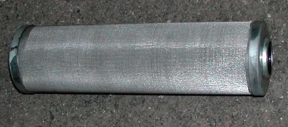

I tried to order a new intake filter cartridge from a McCormick dealer, and I was told that I needed to
buy the whole assembly....for about $300. Hunh?
So, I made a new intake filter from some stainless steel mesh I bought, epoxied into the end caps
removed from the old filter cartridge.
I am uncomfortable (as others are) with anything more than a mesh in the intake to the HST.
(Thx, George.)

Wow what a headache. I would have blown a fuse in my head. Good work.
