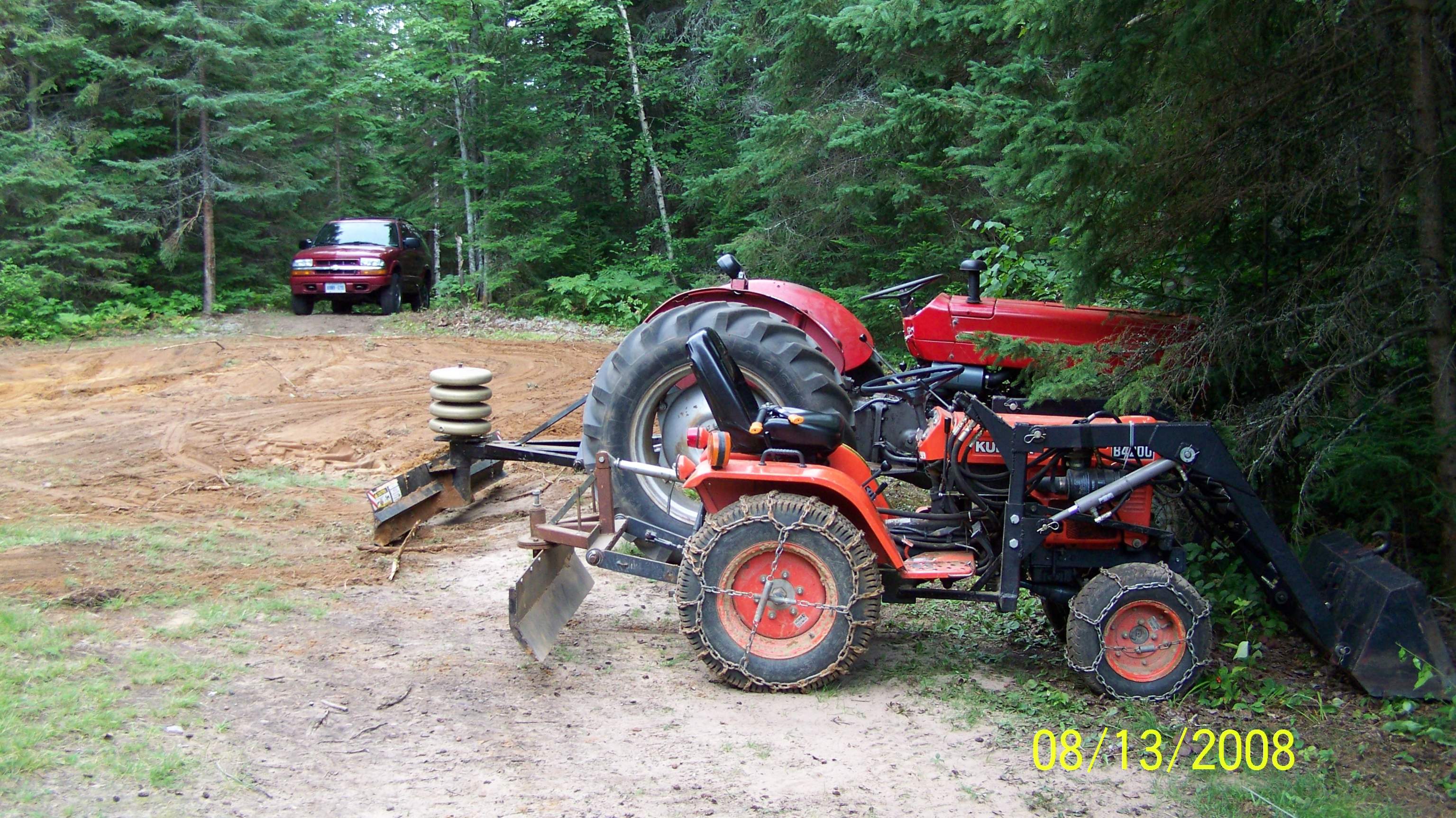

Trust me, you will need a brace. There will be way too much leverage at the frame. I had a brace going forward and although my Kubota does not have a frame like yours, I still managed to crack the bell housing. You can see in the picture I run a brace forward, and backward now.

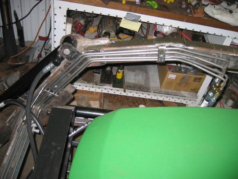

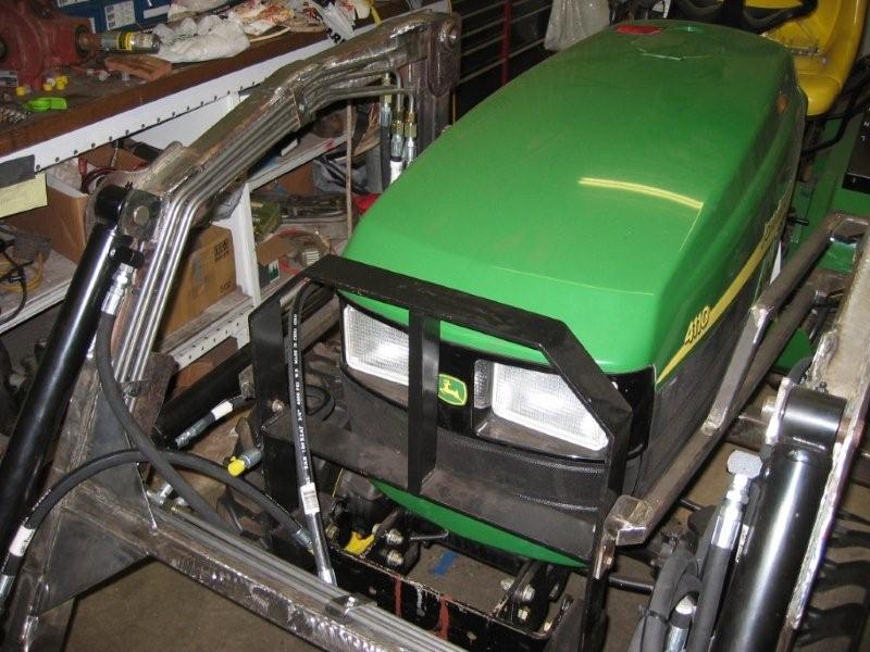

   / my loader 20/20 hindsight #34
I hand bent these lines. As long as they stayed on one side of the loader arm I was satisfied. Still waiting for a couple fittings from hose to the Ts. It should be ready for a test run when they arrive.
