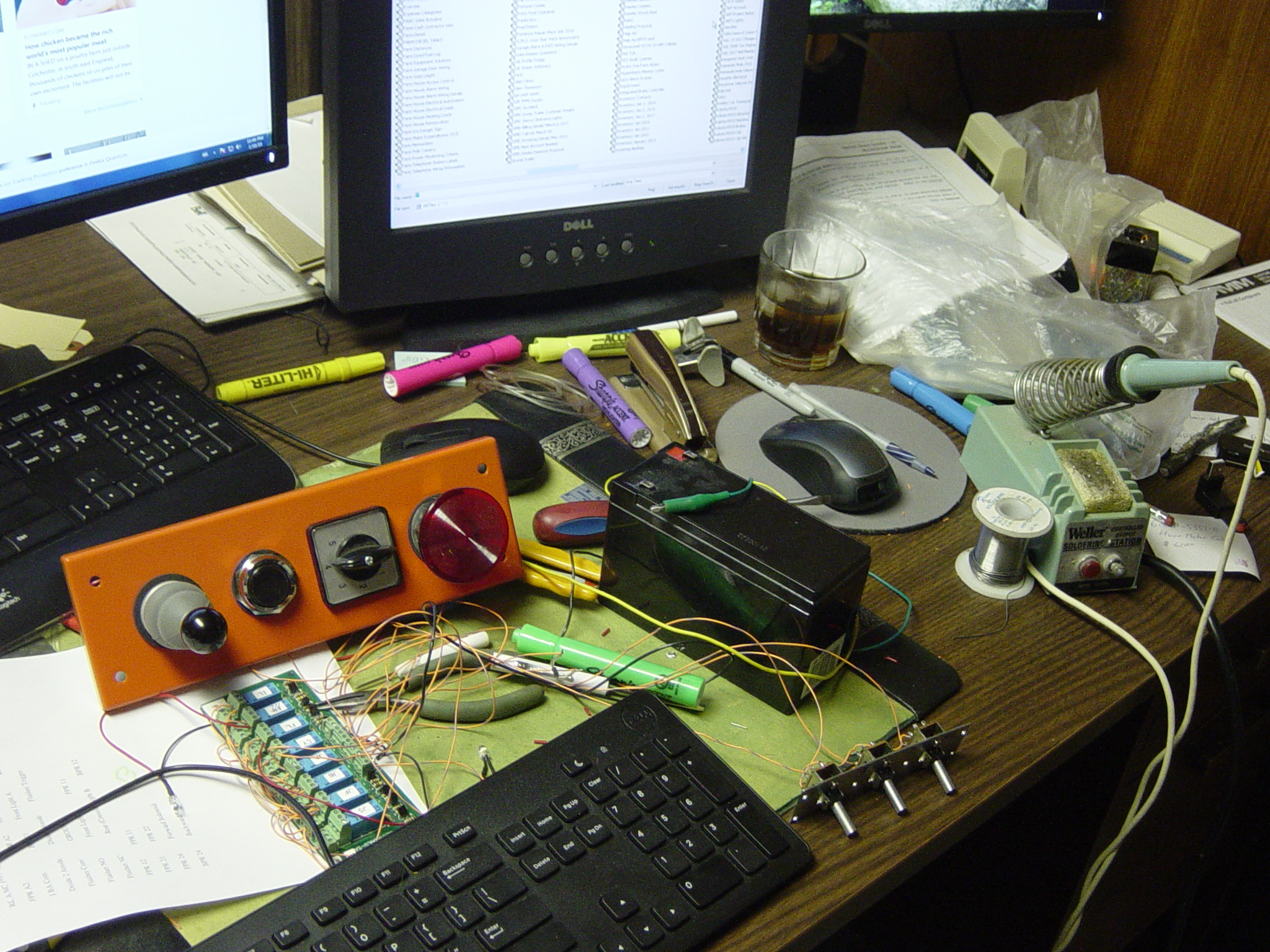

Relay Logic Board test, works! After a few bugs worked out. I am so pleased!
I will explain fully when it's finished.

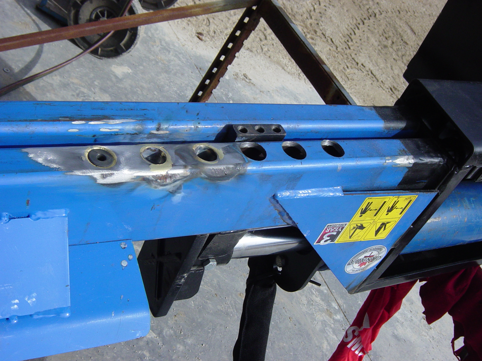

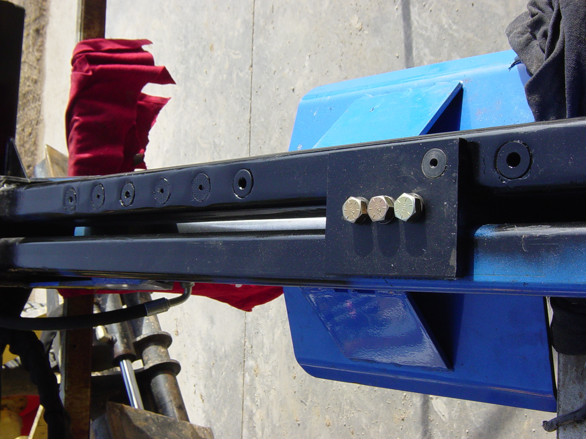

DSC04663.JPG Magnetic Sensors

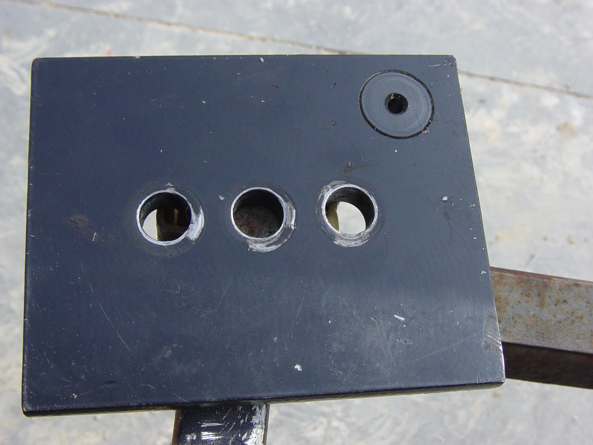

DSC04662.JPG Rare Earth Magnet on Pusher Plate
DSC04659.JPG Holes Drilled in frame

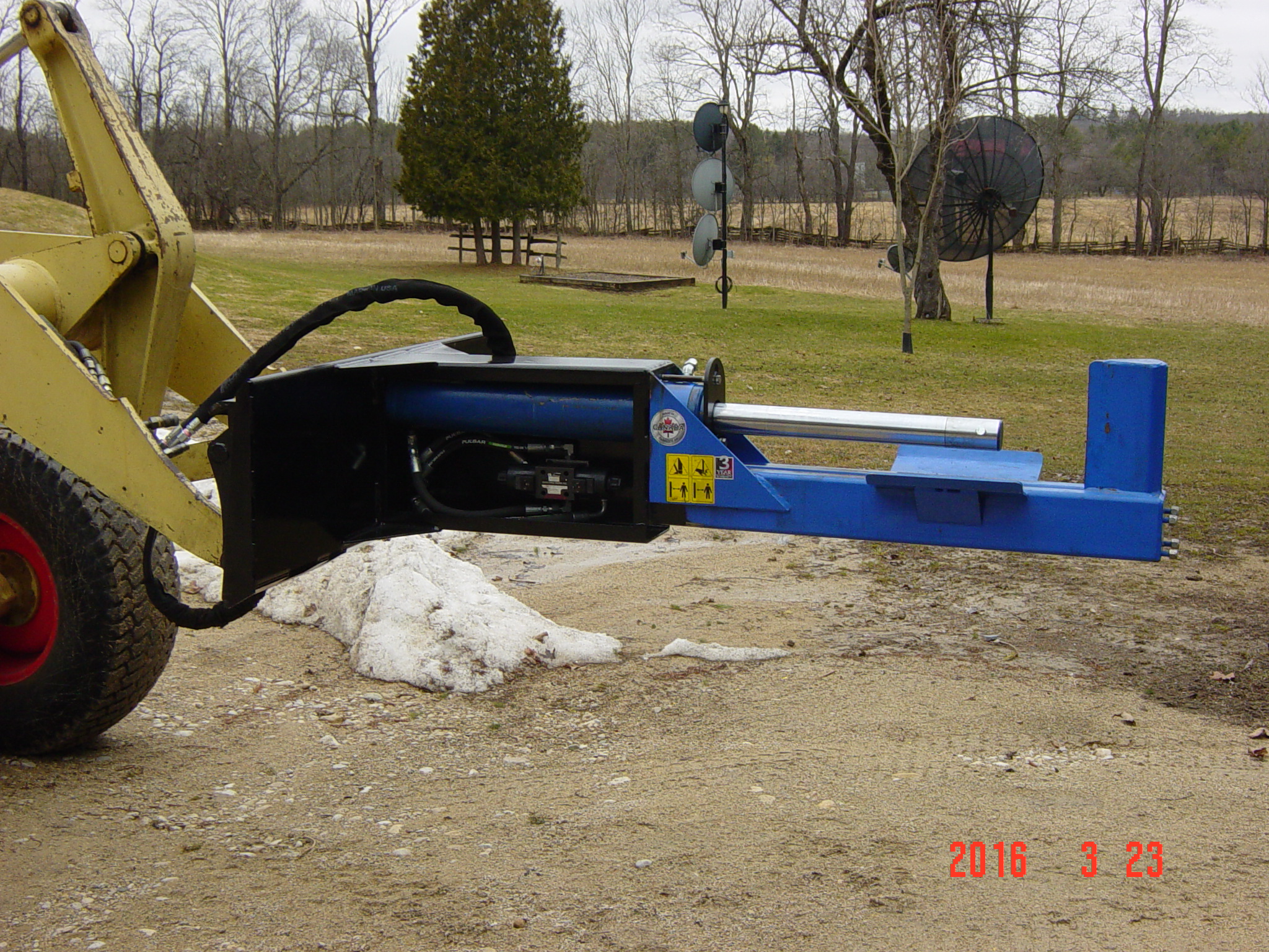

DSC04279.JPG SS Loader Mounted

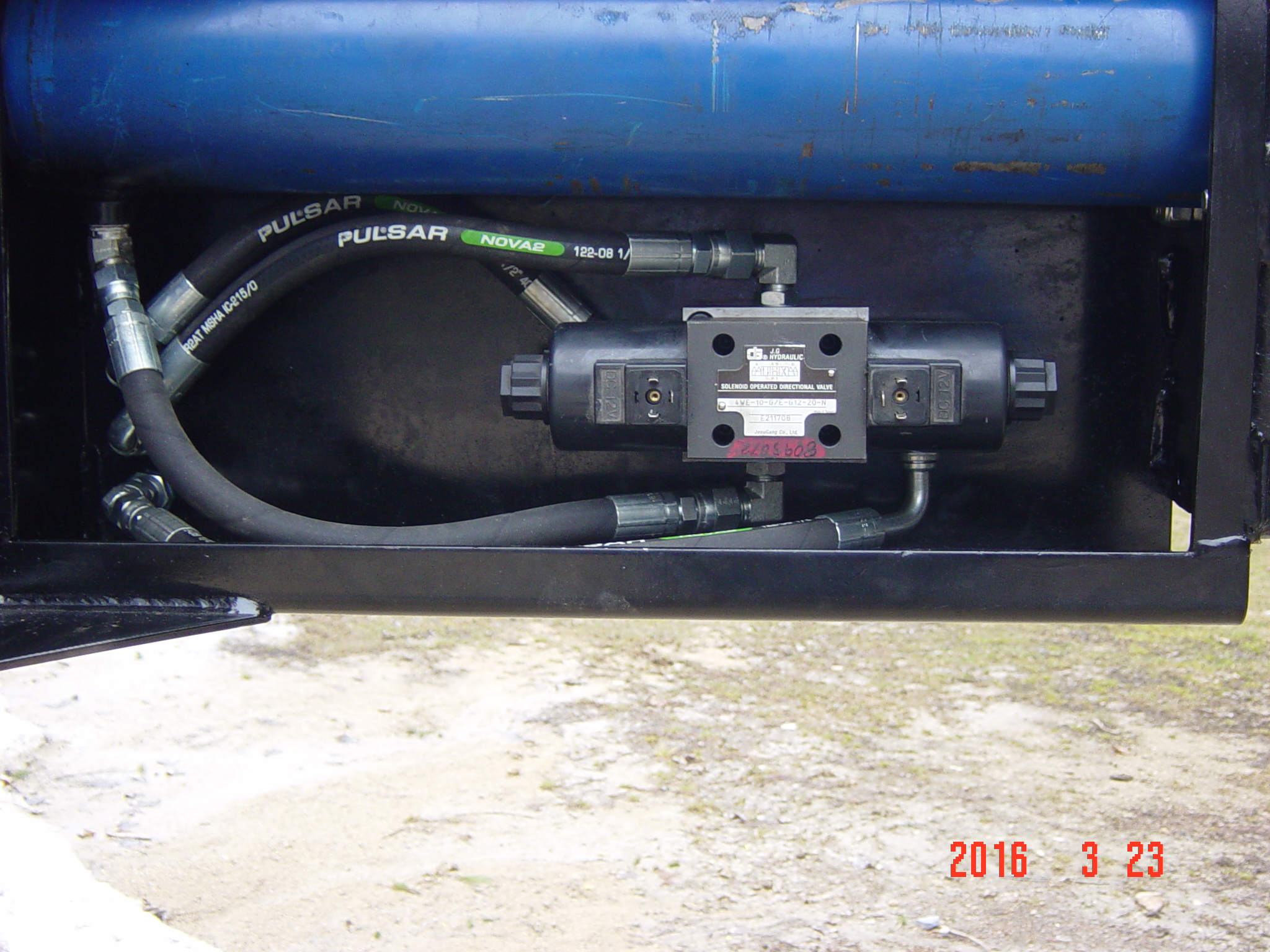

DSC04281.JPG DO 5 Control Valves make anything possible
