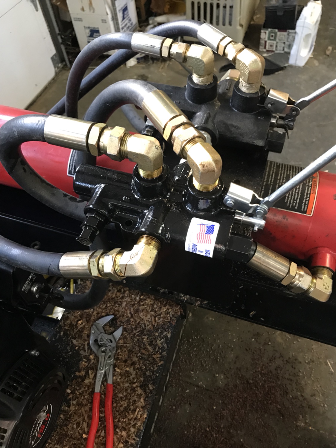

I changed the valve on my splitter to a double way detent valve. I think you could add some linkage to reverse the valve at the end of the stroke and you wouldn’t have any electronics.

The valve I used is not a fast return valve. It’s a got a detent in both directions. Here’s what the valve looks like. And so I don’t waste time with a 30” stroke to split 20” wood I’ve got 2 sets of holes drilled in the beam to put bolts in to stop the wedge. I keep them in the farther back position because the closer position limits some pieces of wood that got cut a little too long. IMG_1243.JPGIMG_1244.JPG

Mine currently requires the user to return the valve to the return position. I’ve been trying to figure out how to get it to reverse itself. It’s not a straight forward solution with linkage because before the valve goes into reverse it first hits neutral and the cylinder stops moving. It will have to store energy with a spring and then slam the valve the other way. I’ve got some ideas in mind but I haven’t and probably won’t bother building anything, but does anyone have any ideas?

$300 on Surplus Center will get you a auto cycle valve that will do that: Prince Mfg | Brands | www.surpluscenter.com
