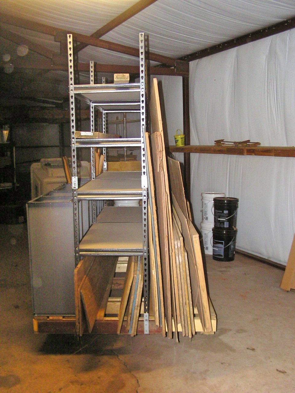

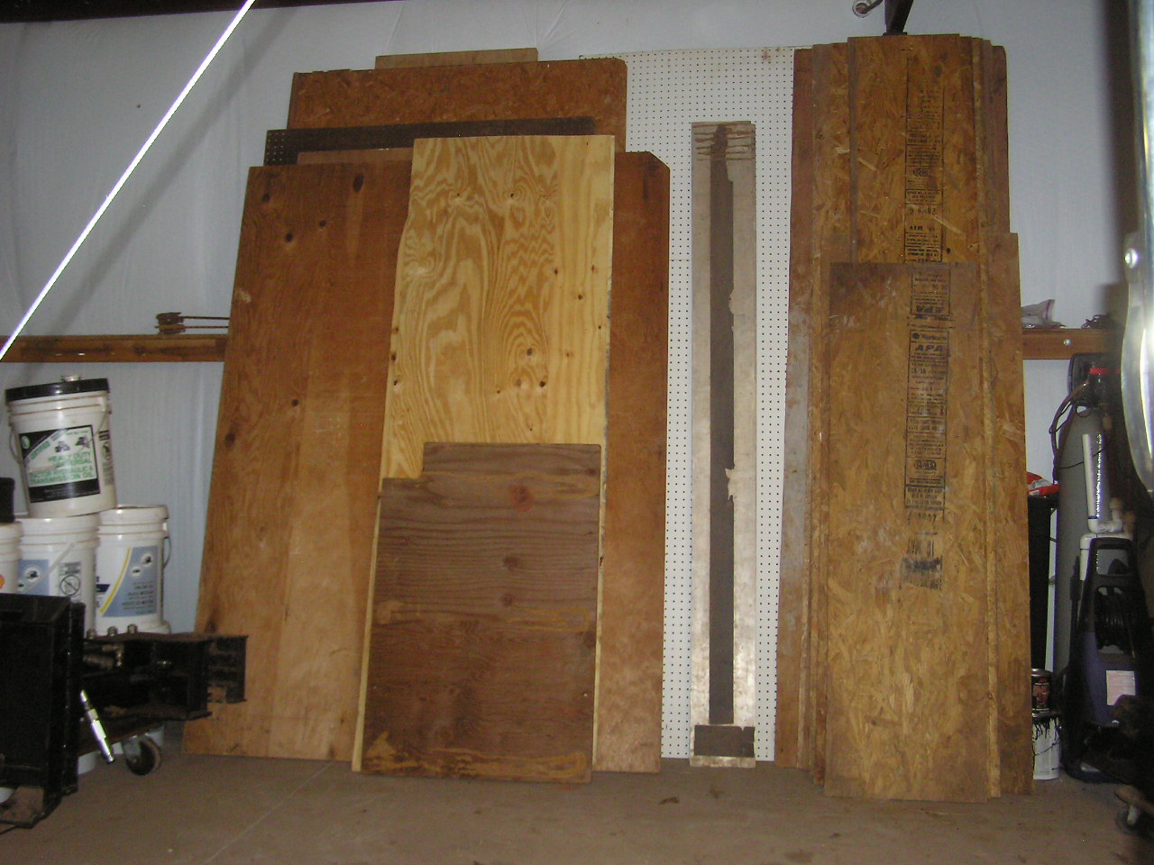

The problem, all that stuff leaning against the wall:

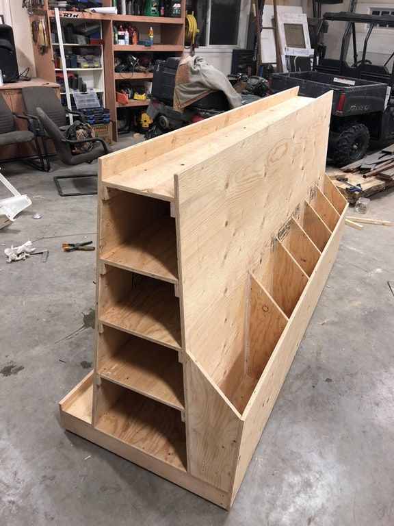

Did an image search for ideas, found these:

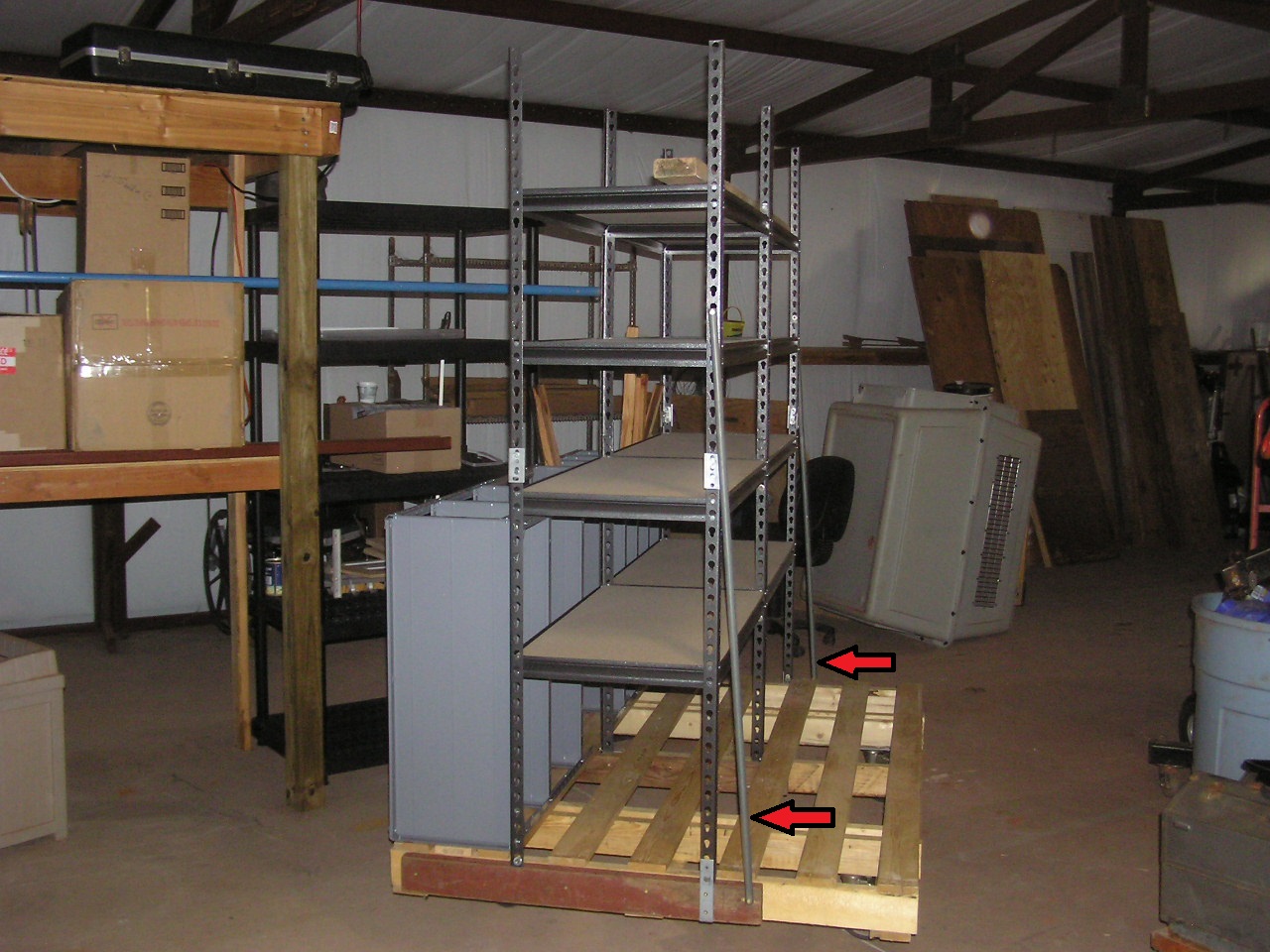

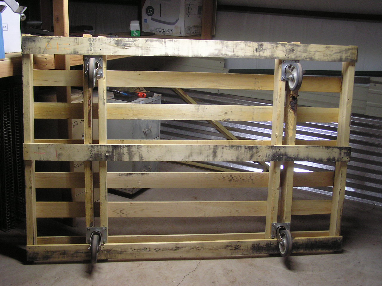

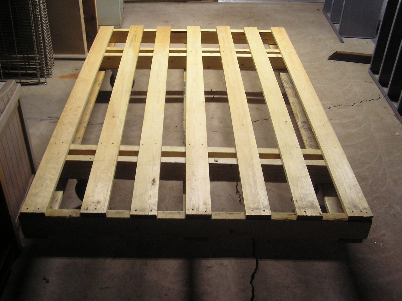

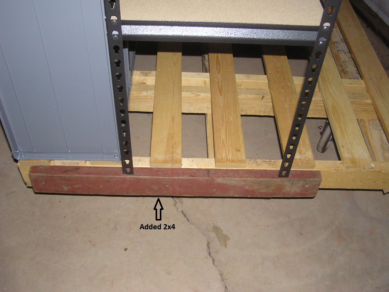

The solution to the problem is my version of a storage cart starting with a saved 4' by 6' pallet that stall mats came on years ago. Added two 2x4s and casters:

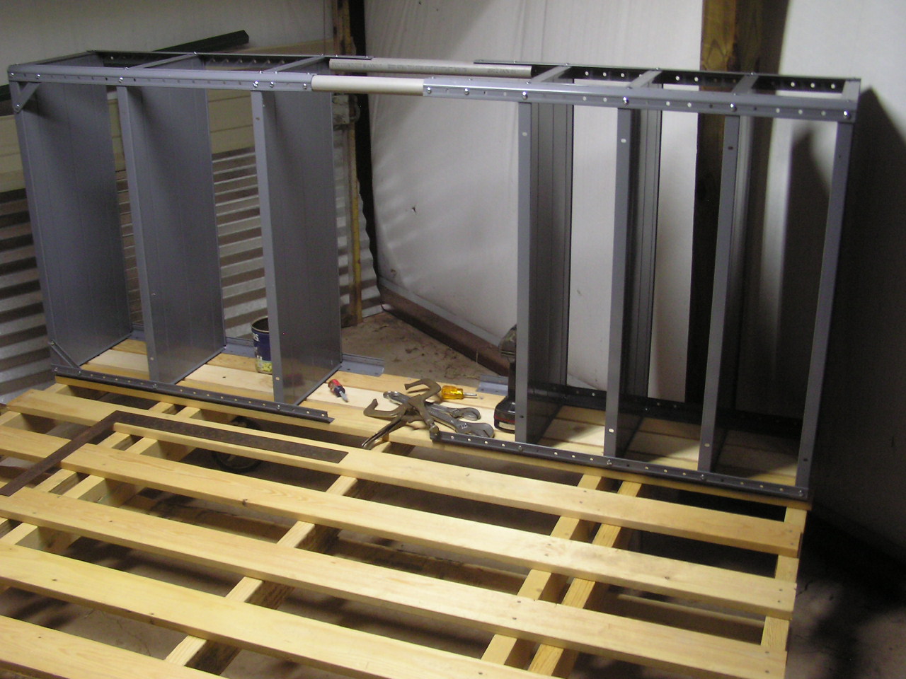

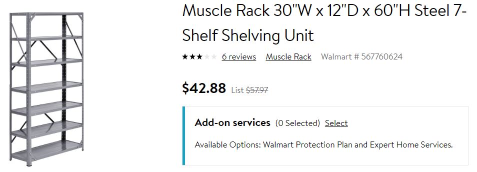

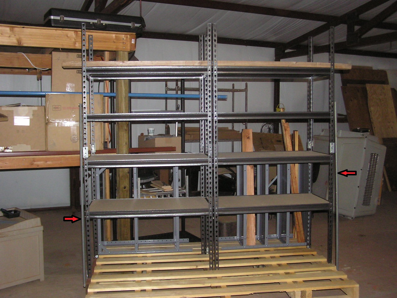

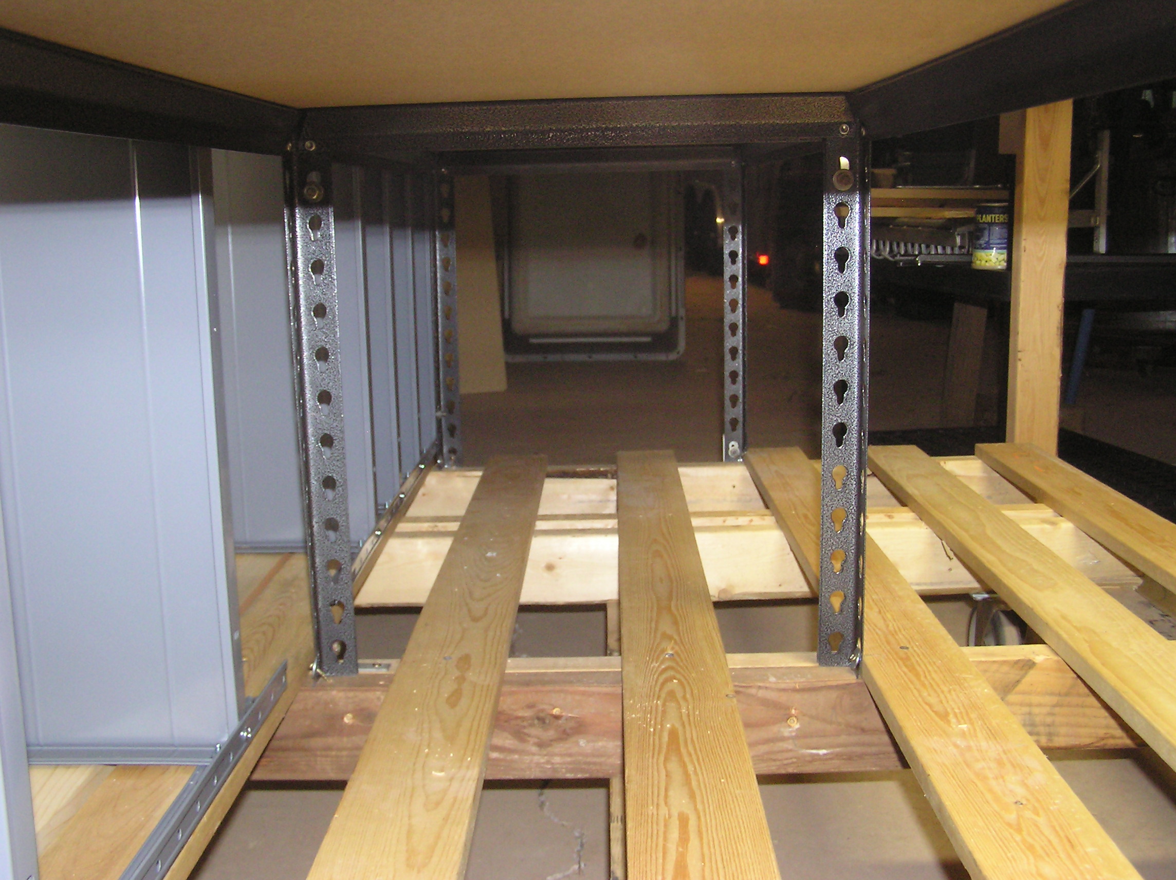

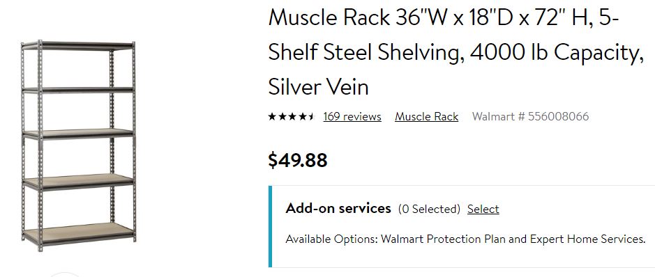

Ordered one 7 shelf unit for the vertical storage spaces:
And two of these for the horizontal slide in storage spaces:

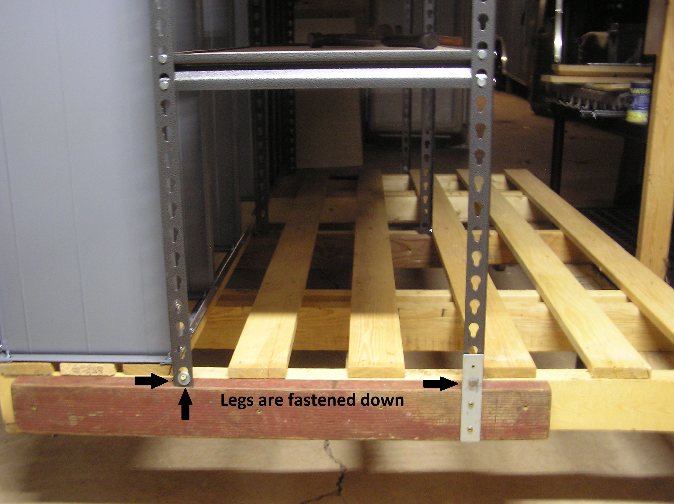

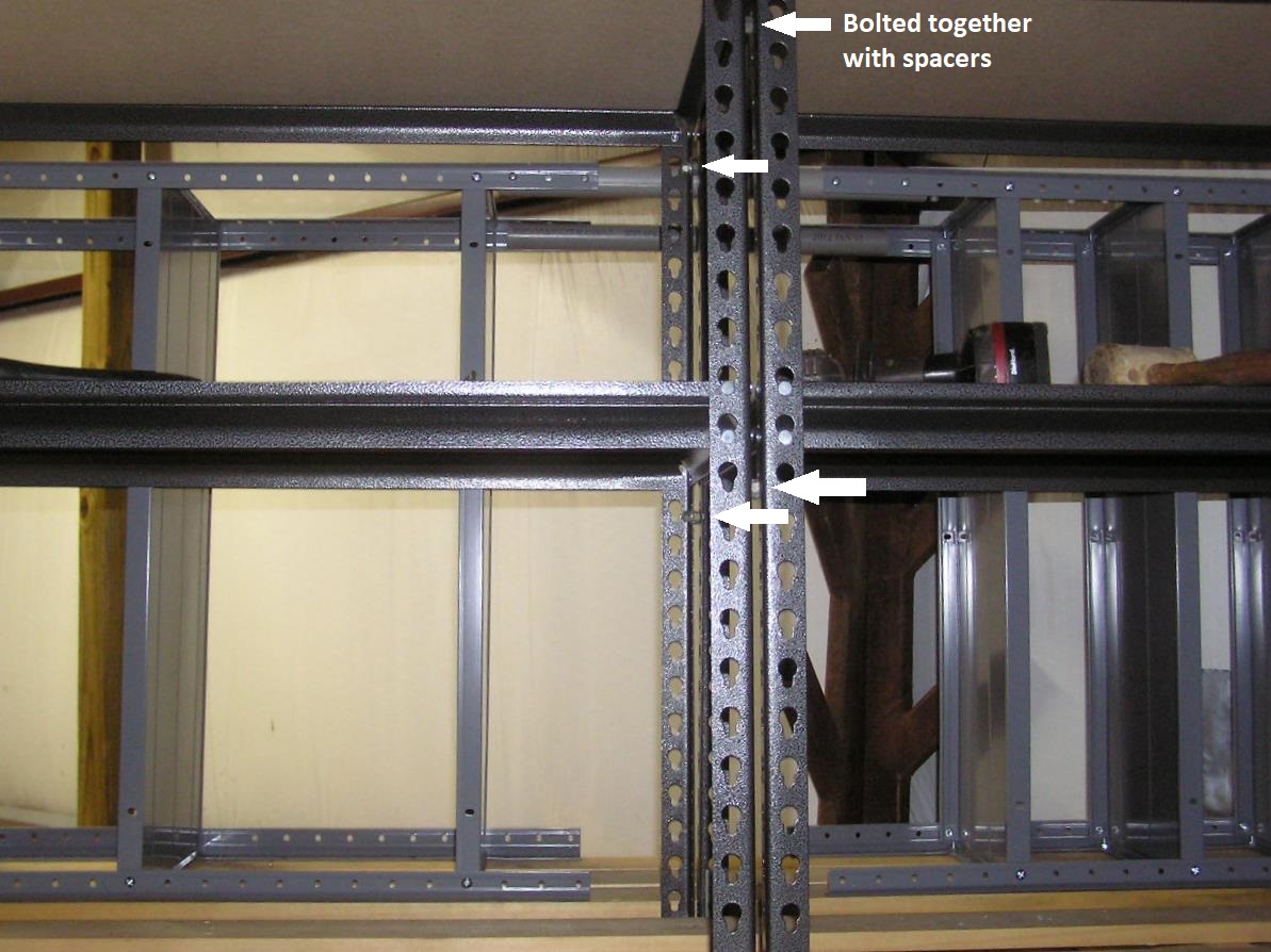

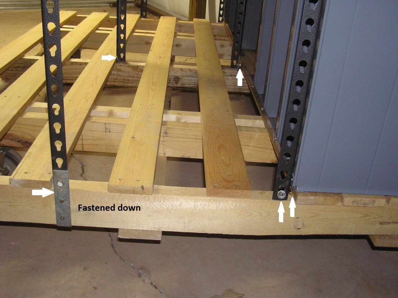

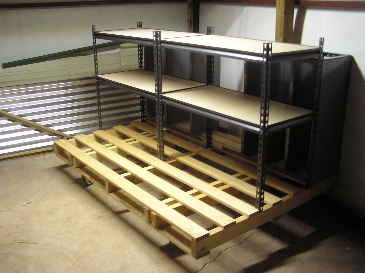

The first one is expanded to fit and screwed down to the base:
   / My Lumber and Plywood Cart

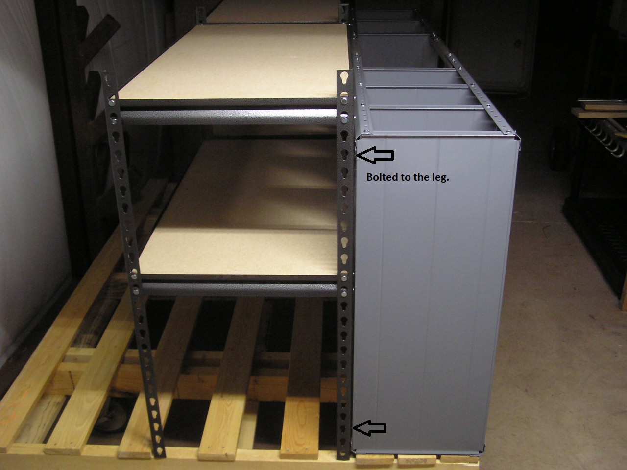

Set the bottom half of the horizontal shelf in place:

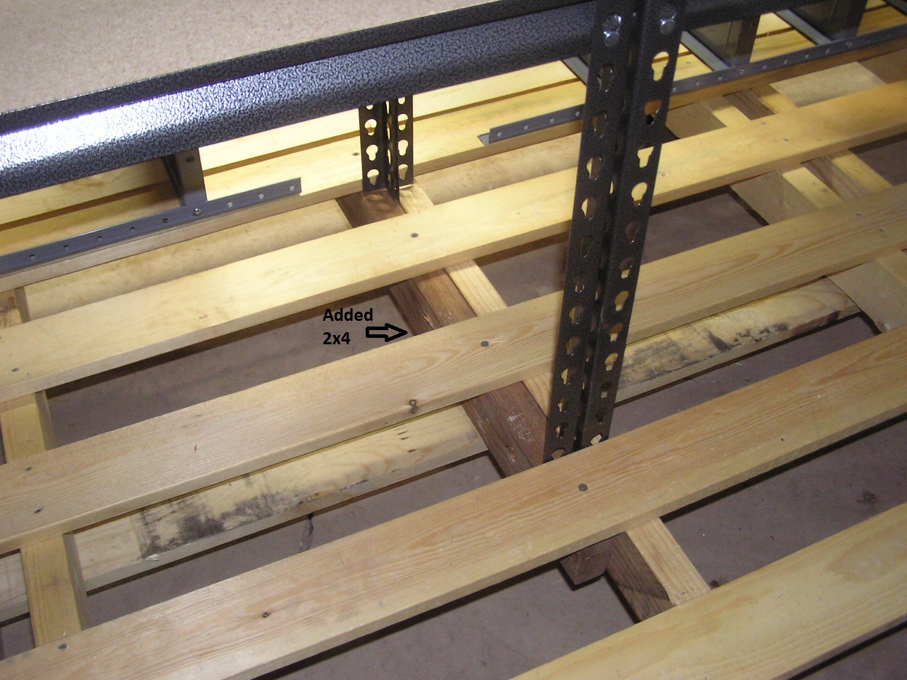

Had to add short 2x4s to support the legs of the second shelf:

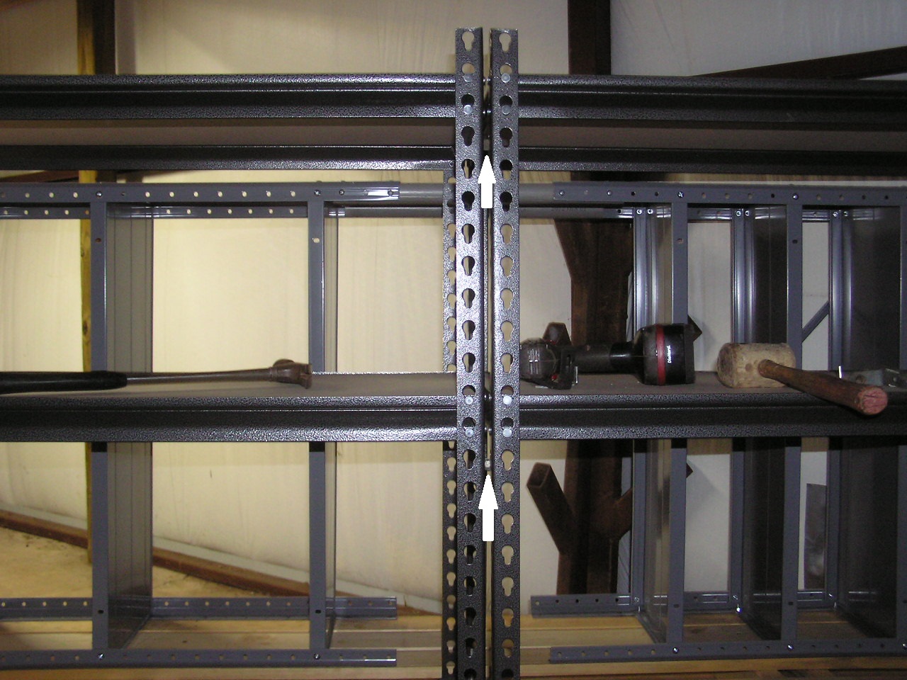

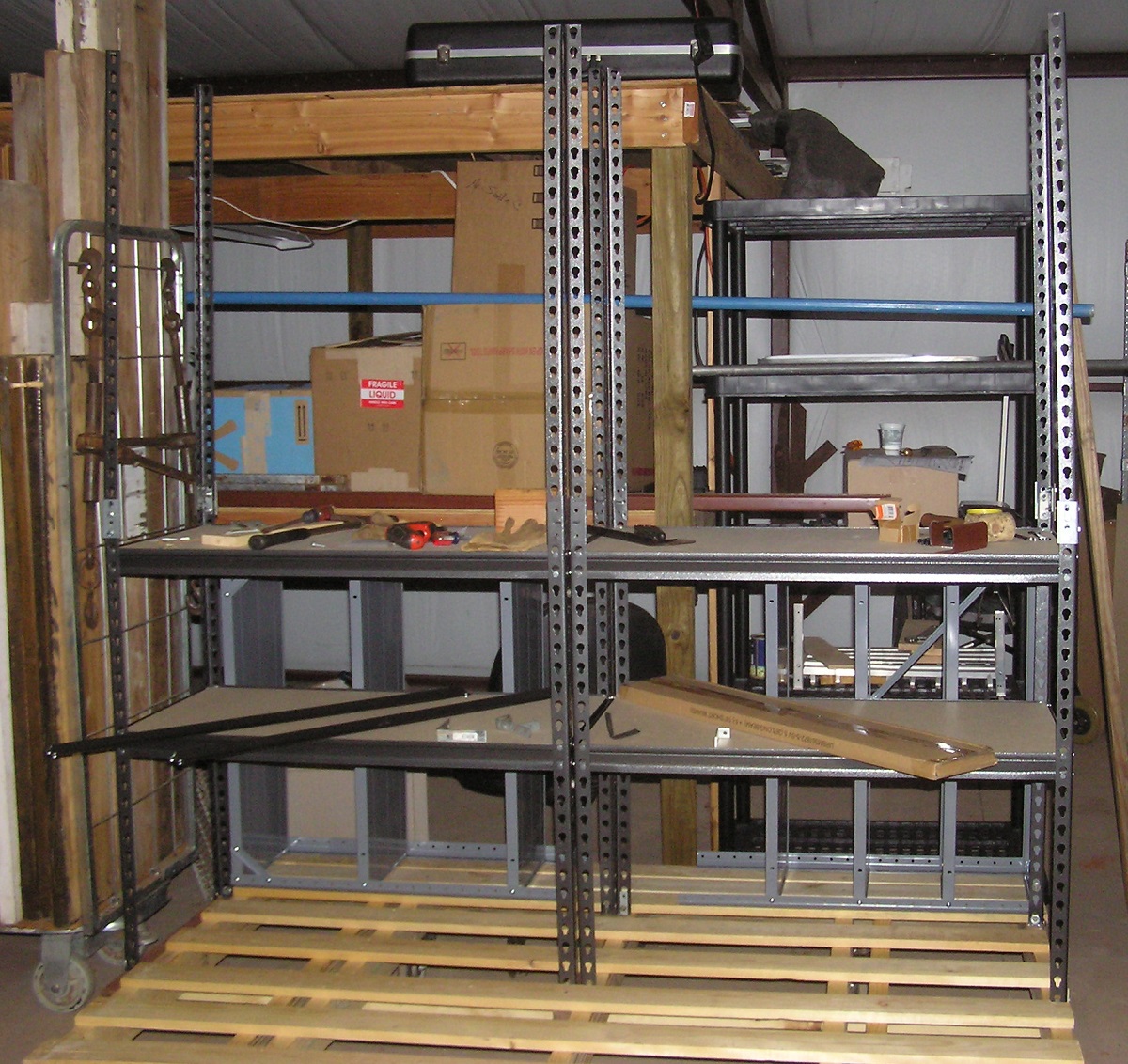

More progress:

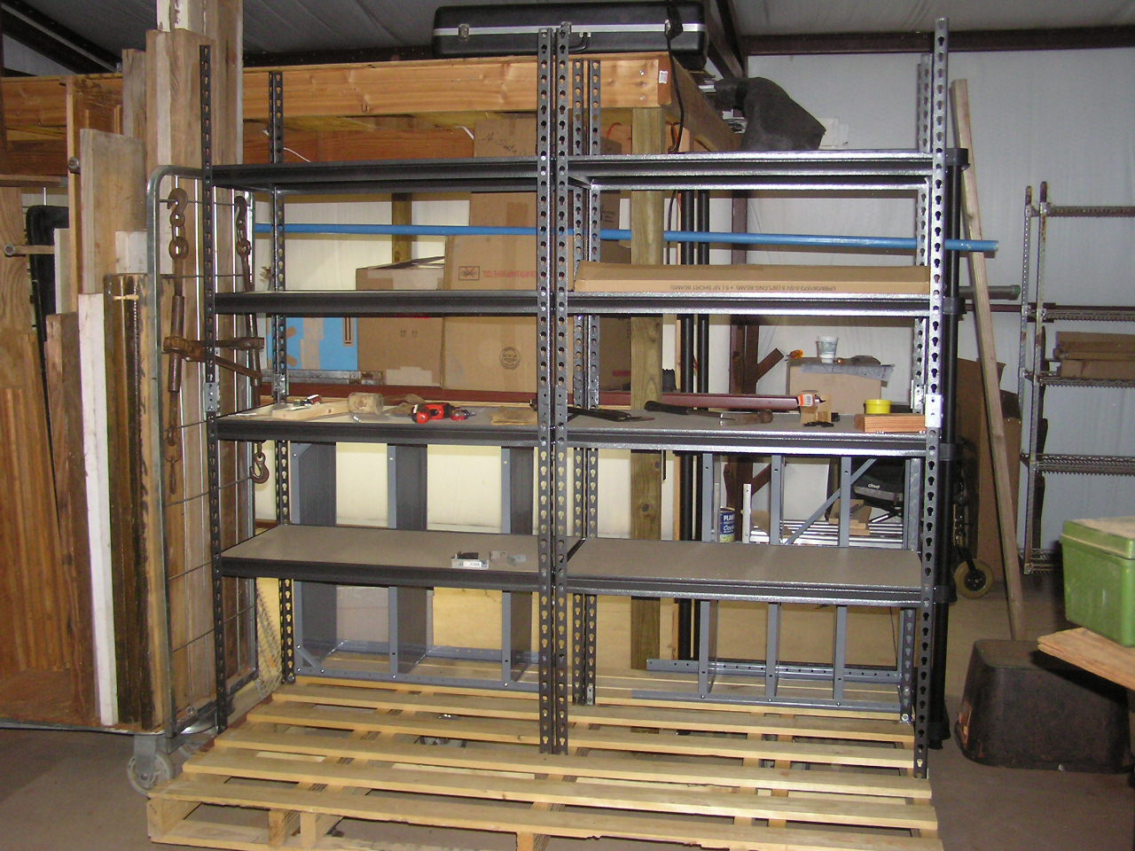

Got the rest of the legs on last night:
And two sets of shelves on today:
Still have one set of shelves, need to decide if I want them at the top or in the bottom section.

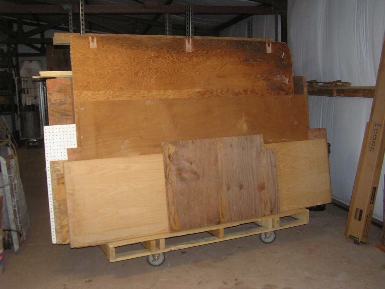

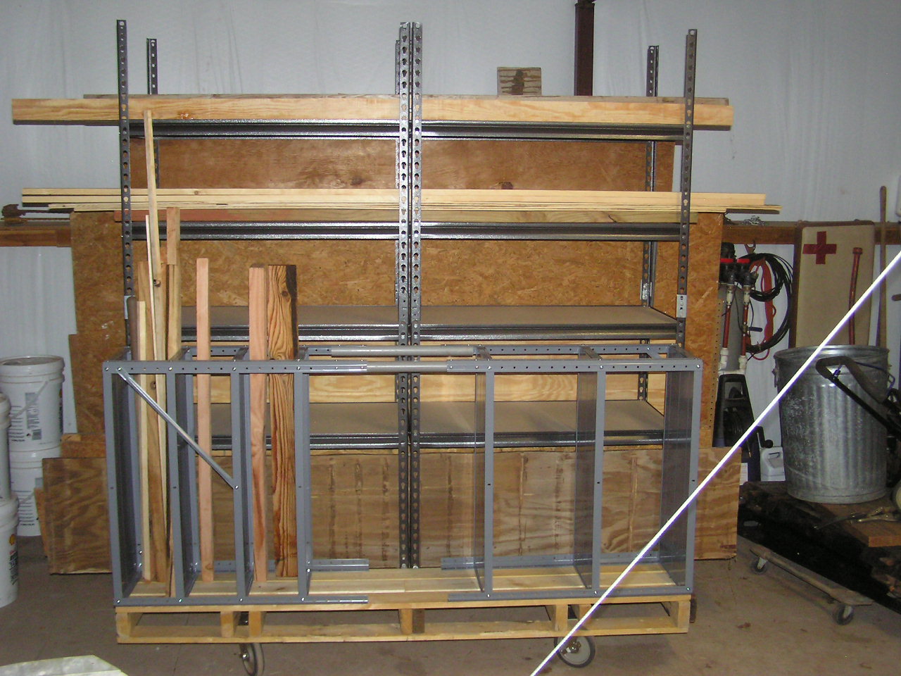

Decided not to use the last set of shelves for now. I can install them later if needed. So it is finished for now. :thumbsup:
Added 1/2 inch EMT at a slant for the 4 foot wide sheets to lean against:
Moved the stuff from the wall onto the cart:
Still have a lot of room left on and in the shelves for lumber:
