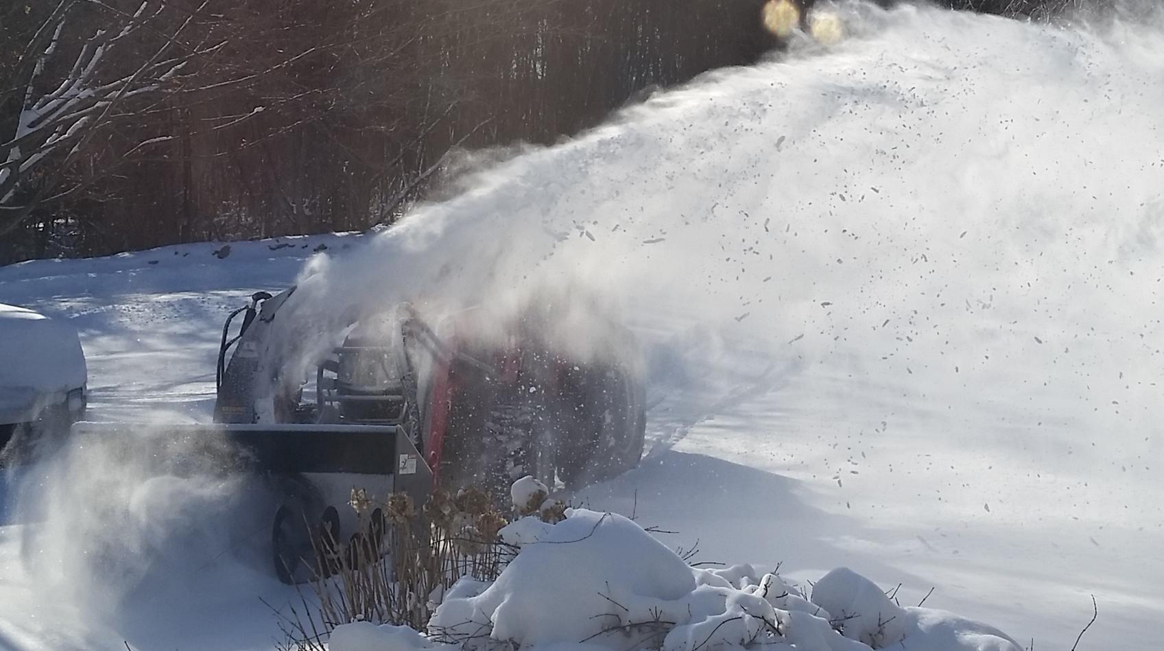

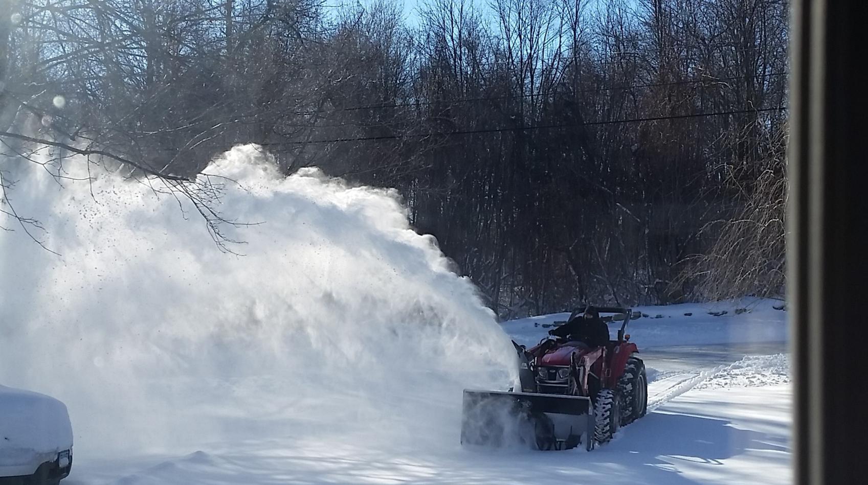

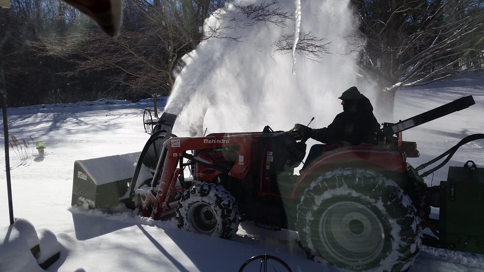

Well, we didn't hardly get anything compared to some, but I've been straining at the leash to try out my snow equipment. 8+" of light, fluffy snow is not much of a test, but I still had a ball. Of course after the first face-full of snow I was wishing I had gotten a cab model, but it's no problem.
The inaugural use of the Mahindra 2555 / Erskine ES2400 combo was a complete success!
