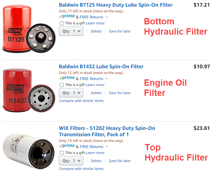

I posted this in an answer to a forum post about filters for the Branson 3520H. It seems to be hard to get a definitive list of acceptable filters and other consumables for Branson / Kukje tractors, so I thought I'd share a list of acceptable filters that I have used in the past (Or may need in the future).
If you walk into an auto parts store with the oily hydraulic oil filters that you just took off of your tractor and try to find one of the clerks who can read the Korean writing on them, or run the number on them in hopes of finding a suitable replacement, you will walk back out of the store with no new filters. :(
Some of this is preference, like the Rotella T6. Things with a little splat next to them are things that I use currently, or have used on my 3520H with no issues. If anybody has any options that they prefer, please reply with your findings / preferences.
Engine Oil:
Shell Rotella T6 10W-30
Engine Oil filter:
- * Baldwin B1432
- * WIX 51522 (Recommended by Wix's website for the 3520H)
- Purolator One PL25288
Transmission & hydraulic oil :
- * Texaco TDH 1893
Hydraulic filters MUST have the gasket around the far outer edge!!
Large Hydraulic Oil Filter:
- Original: Branson/Kukje : NTB8030000B3
- * Wix 51202 (Recommended by Wix's website for the 3520H)
- Luber-finer LFH4922
Small Hydraulic Oil Filter:
- Original: Branson/Kukje : TA00000859A
- * Baldwin B7125 Preferred
- Donaldson P551352
Air Filters:
- Original Air Filter Set Donaldson
Large Outer : P822768
Small Inner : P822769
- Wix Recommended:
* Large Outer : 46489
* Small Inner : 46490
Here's my latest filter order for the full lube-job I just did on my tractor...
