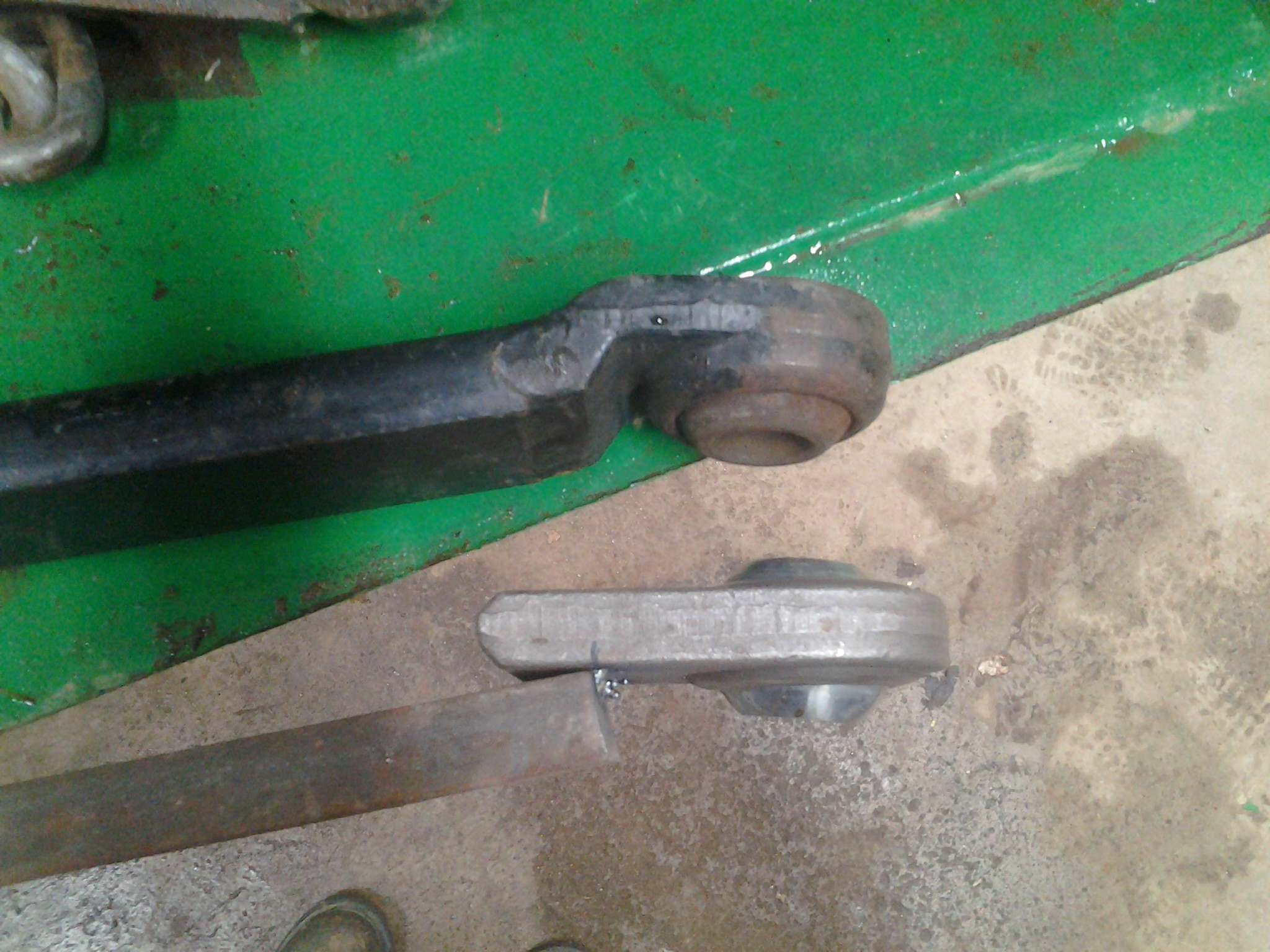

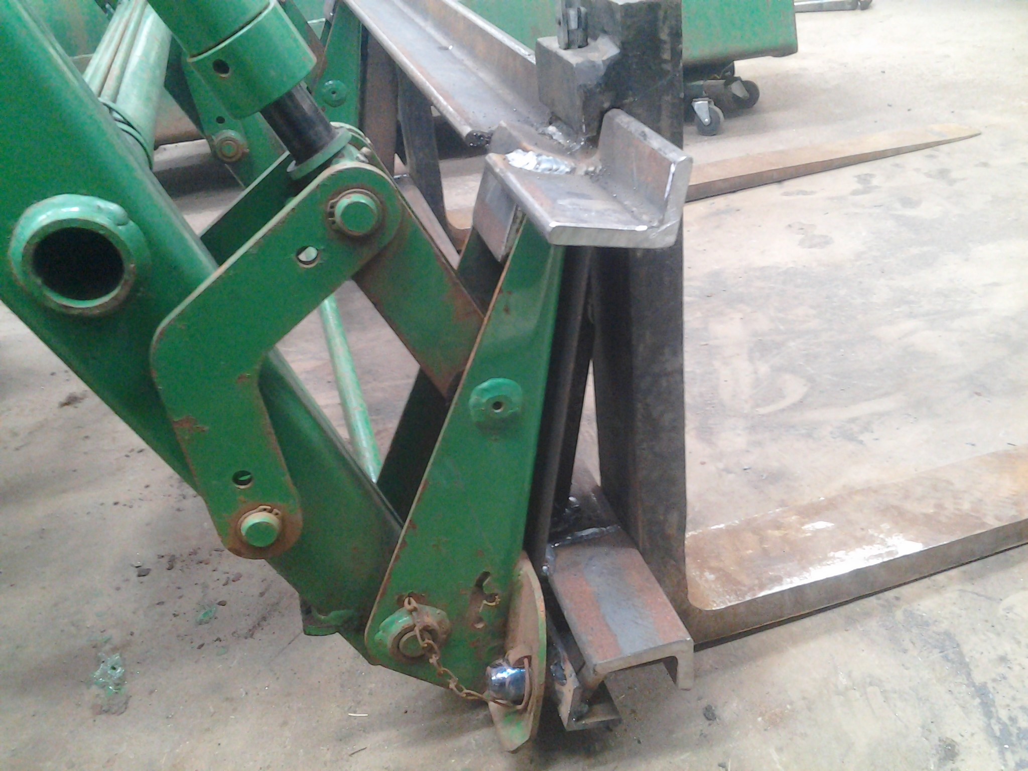

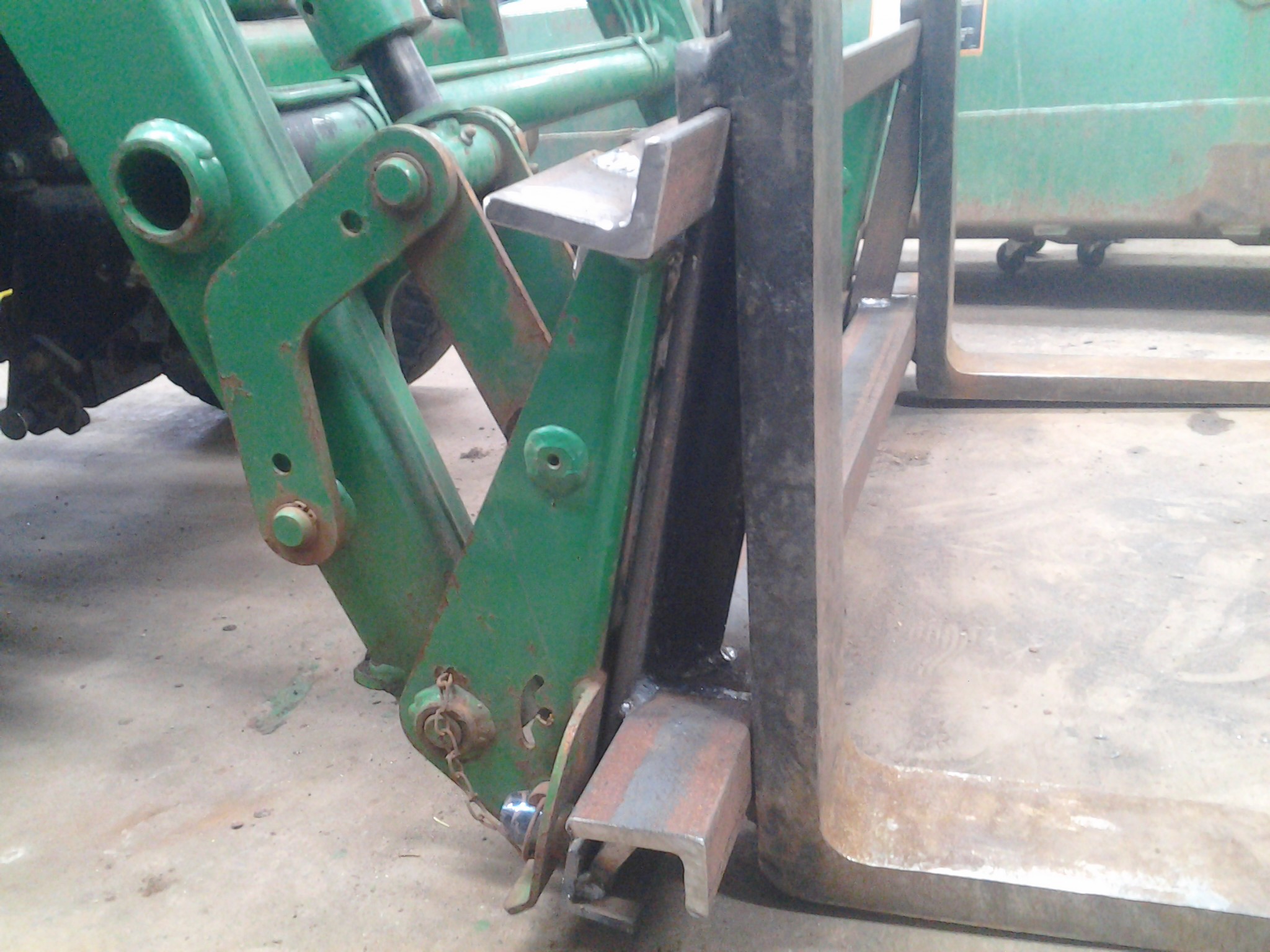

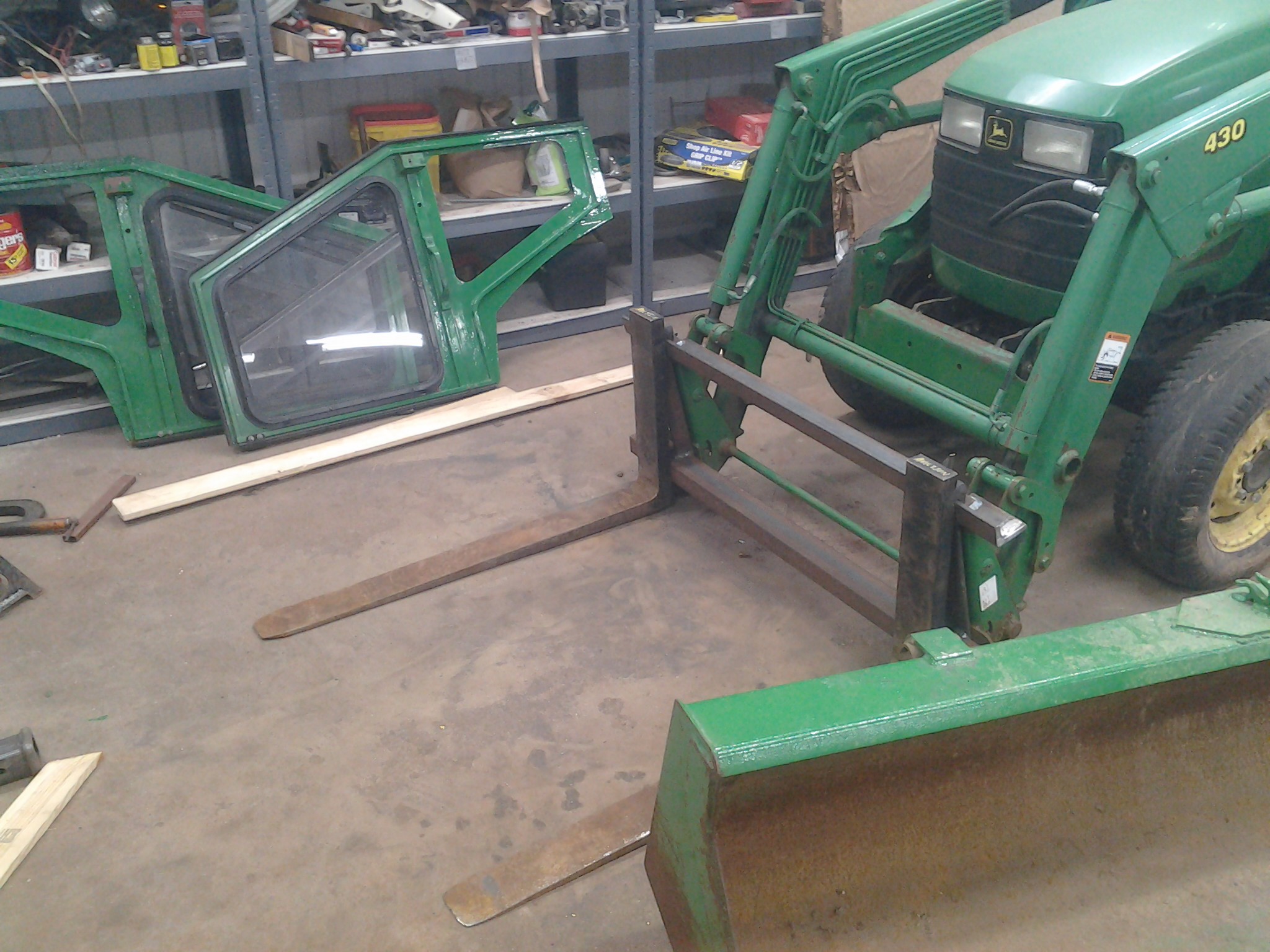

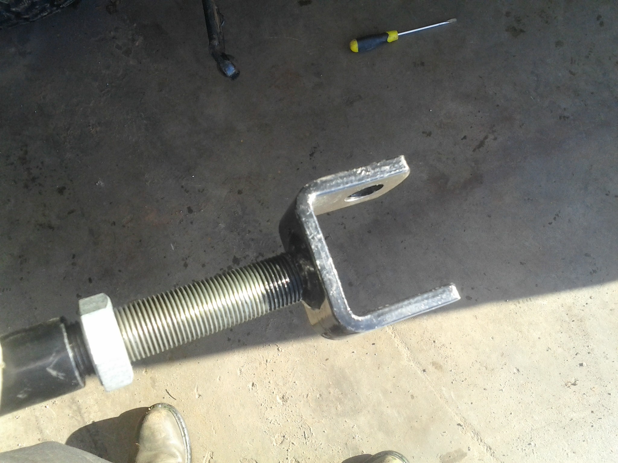

Been stupid busy at work, haven't had a chance to play with the tractor much. It's been snowing a lot recently so I've been back at it in the evenings. Made some pallet forks and started making a new 3-point arm to replace my missing one after giving up the search for a used one. Should be pretty simple and a whole lot cheaper than new from deere. None of the aftermarket ones were very close to being the same so I figured I'd be better off making my own so it's exactly the same (or better) than factory.
   / My new 4300 project
#27

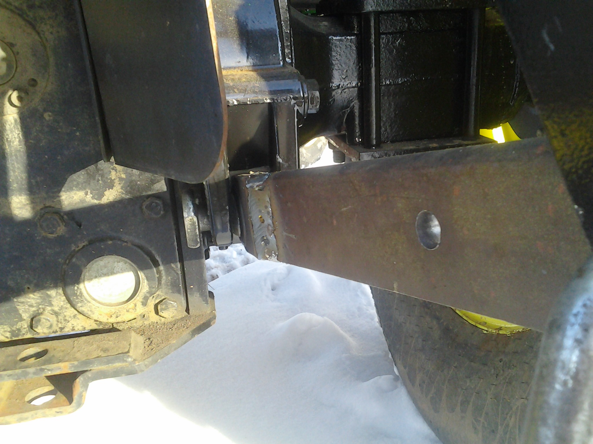

Got the draft link done. Turned out pretty good. I ended up breaking the tack welds from above and grinding the tip of the bar stock at an angle. It now is identical to the dimensions of the JD link. Ball centerline and angles are the same. It also has more freedom in the transmission ears than the stock arm and more room to the inside of the arm to the attachment. I'm not sure why the stock arms had such strange offset ends.
I made mine from a 24" piece of 2.5" x 3/4" bar stock, bent it with a 50 ton press, welded on ball ends from agri supply that were $5 a piece, and drill the holes in the same spots as the original. I also made the lift link from a $15 agri supply link and cut off the top and welded a ball on that. >$500 savings over JD. I haven't made a stabalizer yet, not sure if I want to duplicate the pin hole thing that is stock, I haven't used it much but I think I'd prefer to have a chain and bell crank. I find the multipin hole link unnecessarily complicated.

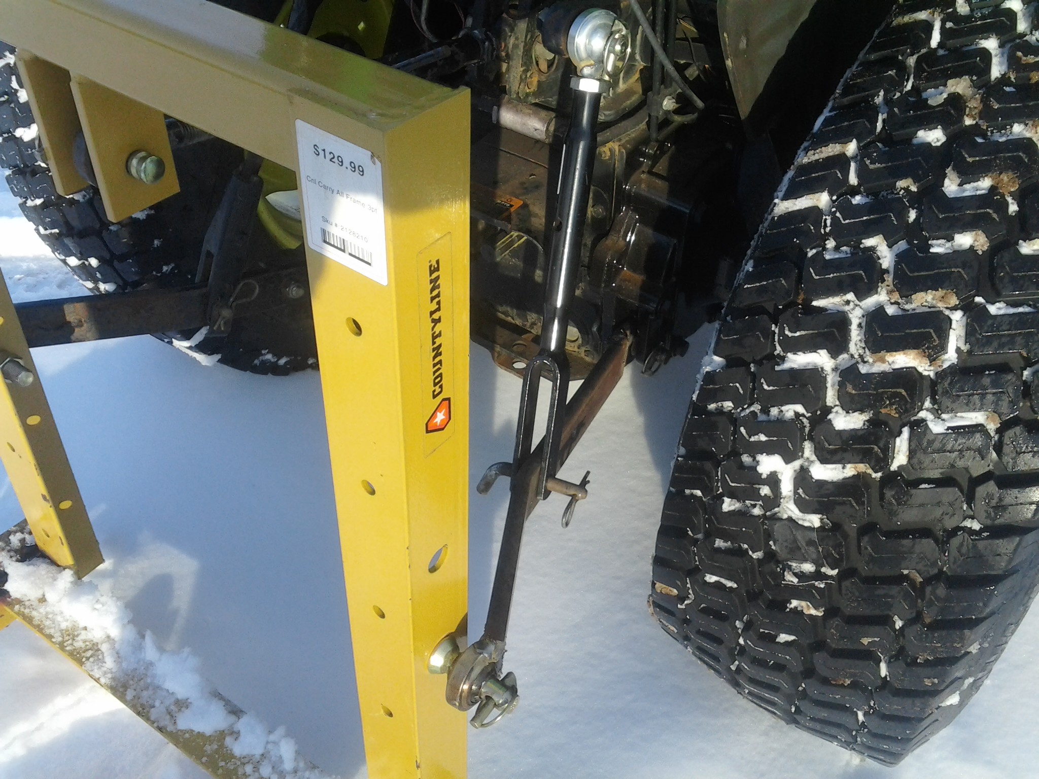

Comment: Your welds look great as does your build/fab job. :thumbsup:

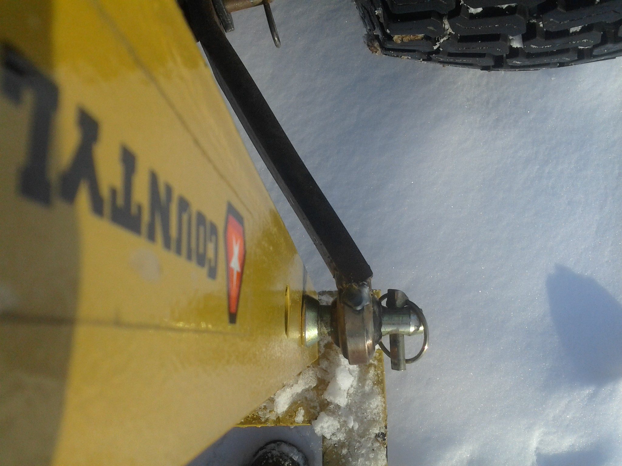

Suggestion, if you are going to use this rig in brush, change out the quick clips (shown in pic #3) with bolt/lock nuts or you risk losing that arm and some serious damage to casting can happen.
Also, with using the quick hitch you show, then the need for frequent changes in the stabilizers is reduced considerably. I only have one 3 pt attachment now that isn't iMatch ready to hook up and go.
#29
Thanks!
That's actually a pallet carrier that I'm using to carry a pallet with weight on it in lieu of a weight box (next thing to build). I don't have a quick hitch but that's on my list, I'll probably wait for a 25% off coupon and get one from harbor freight. It seems like they are the same as all the rest unless you buck up for the deere brand. I guess I've been lucky enough to not lose those clips on tractors in the past. Usually I rotate the pins so that gravity is helping the pin stay in. At the very least I replace those pins when they don't spring as well any more, but I'll probably take your advice and use bolts when I get a quick hitch.
   / My new 4300 project #30
K on the carry all... see it now.
And only takes one well placed stick to rip off the bail on the pins.. regardless of how much spring is left. So rare that those arms are ever removed.. unless you exchange with a backhoe. Good on your builds.
