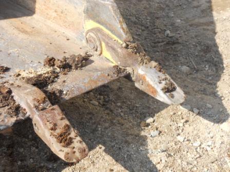

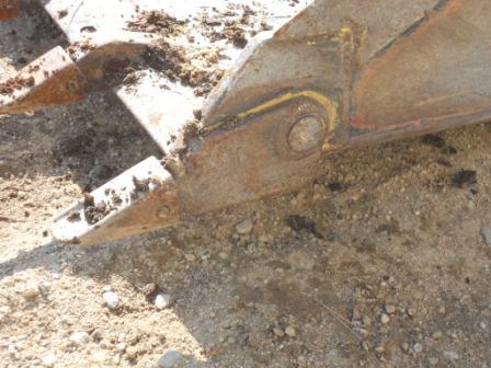

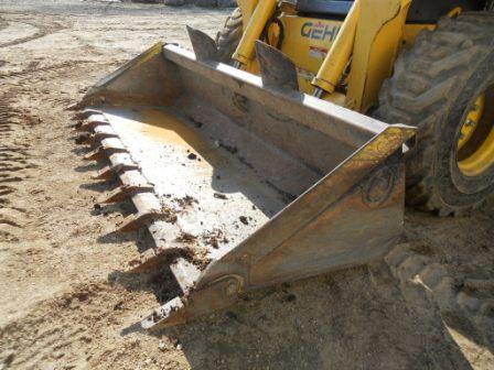

My CA 4/1 was drilled for a bolt on BUCKET edge, but is was not a dedicated tooth bucket like RD's. I agree with RD, a dozer they are not. Just not enough weight, and you'll never wear out that back "dozer" edge. My tooth buckets just do not wear the edge like a smooth bucket. It seems the teeth get to do all the work and it will take many hundreds of hours to really rag out the c.e. (with teeth).
If you Everything Attachment guys are still watching this thread. I built a tooth bucket for my big Gehl because I could not find a big enough bucket necessary for that machine with the spacers for the OT tracks. I have run into a lot of guys that really liked what I built, mostly for the corner tooth detail. These guy's are used to that tooth on their tracked 953's -63's Cat machines. I have seen some pretty nice buckets but none with this detail.
It costs too much for me to build them for them at one at a time! The corner parts are Cat backhoe bucket PN's

I like that end tooth design a lot Rusty. Bradco has a tooth bucket with the end teeth angled outward. Nice for straight digging, but you really have to watch it cutting grade next to asphalt and even concrete, it'll break the edge on either without much effort. Your design looks much more efficient.

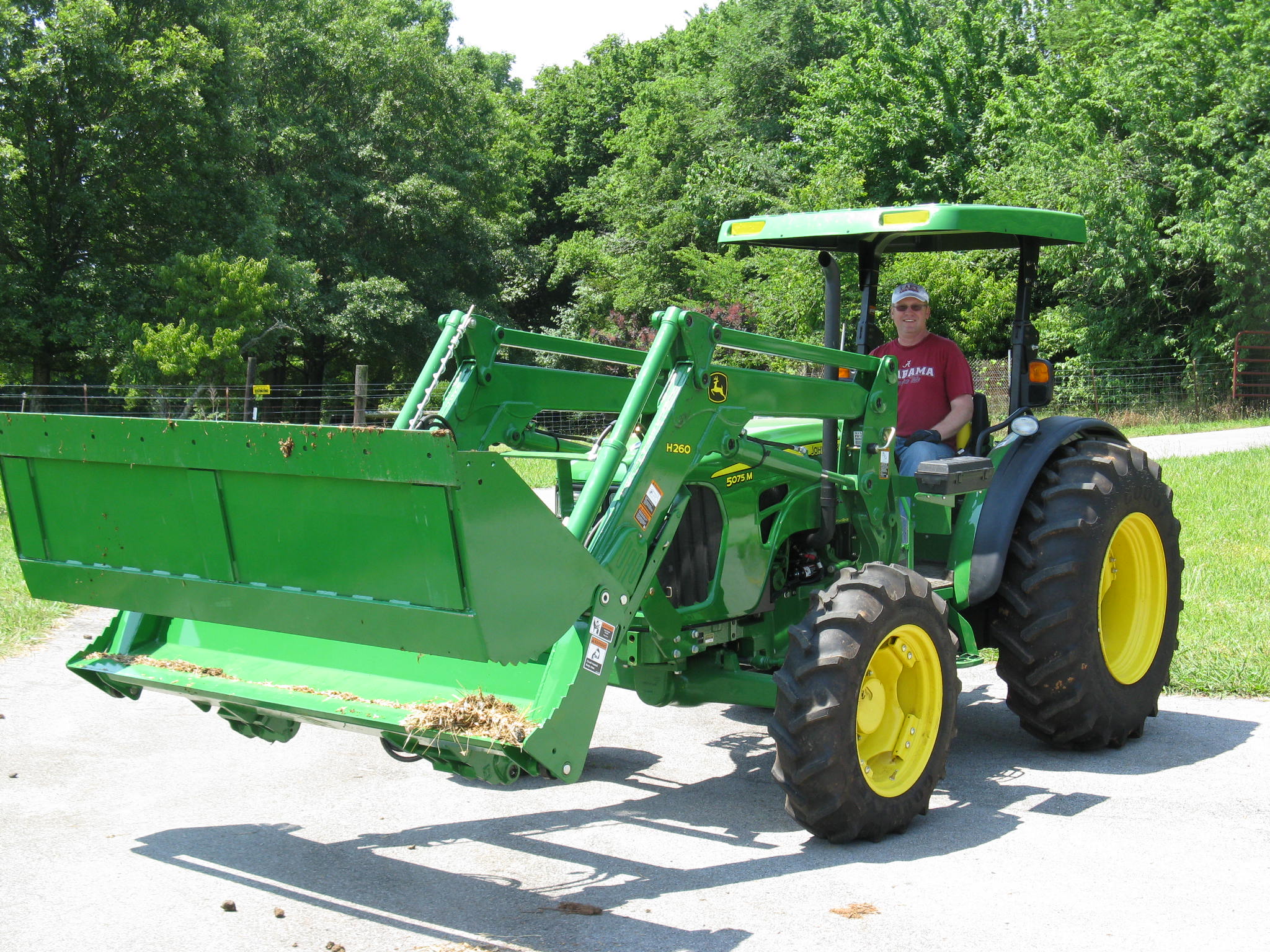

I have a Frontier 4-1 82" bucket on the front of a JD 5075M. It too weighs over a thousand pounds, but it is mounted on an H260 MSL loader and simply hang ballast (6' rotary cutter or box blade with a mounted water tank on top) off the back. I don't have any problem pushing it around as a dozer blade or with the clam closed.JohnDeere5075M 031.jpg. I have wondered if I need the tooth bar. So far, I can't justify it. Congrats!

Nice looking bucket!
Our heaviest, most durable bucket is the CA Severe Xtreme, which is available with weld-on teeth, bolt-on teeth or a tooth bar. The largest one one on our site is an 84", but they'd probably build a larger one. Ted talks about the tooth options in the video on that page.
CA started the Severe Xtreme line of buckets for added durability when the high HP Takeuchi tracked machines became so popular.

Lots of green in that pic!
