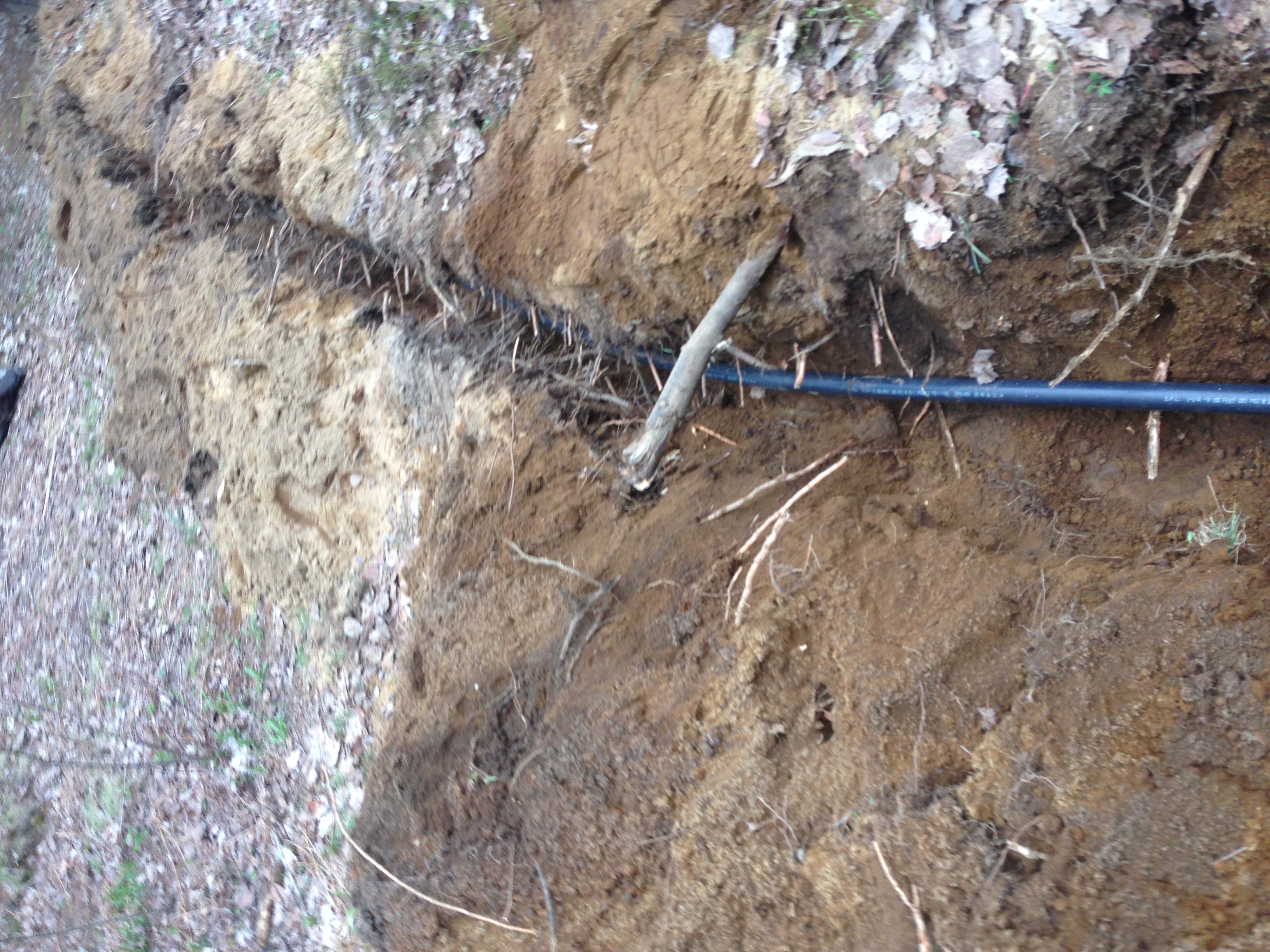

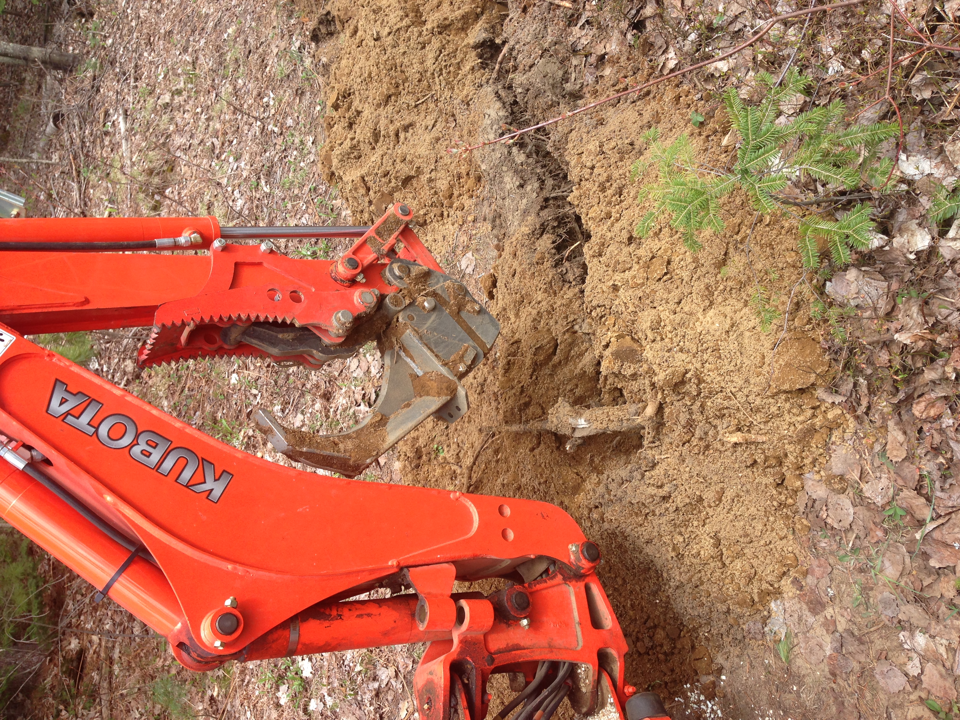

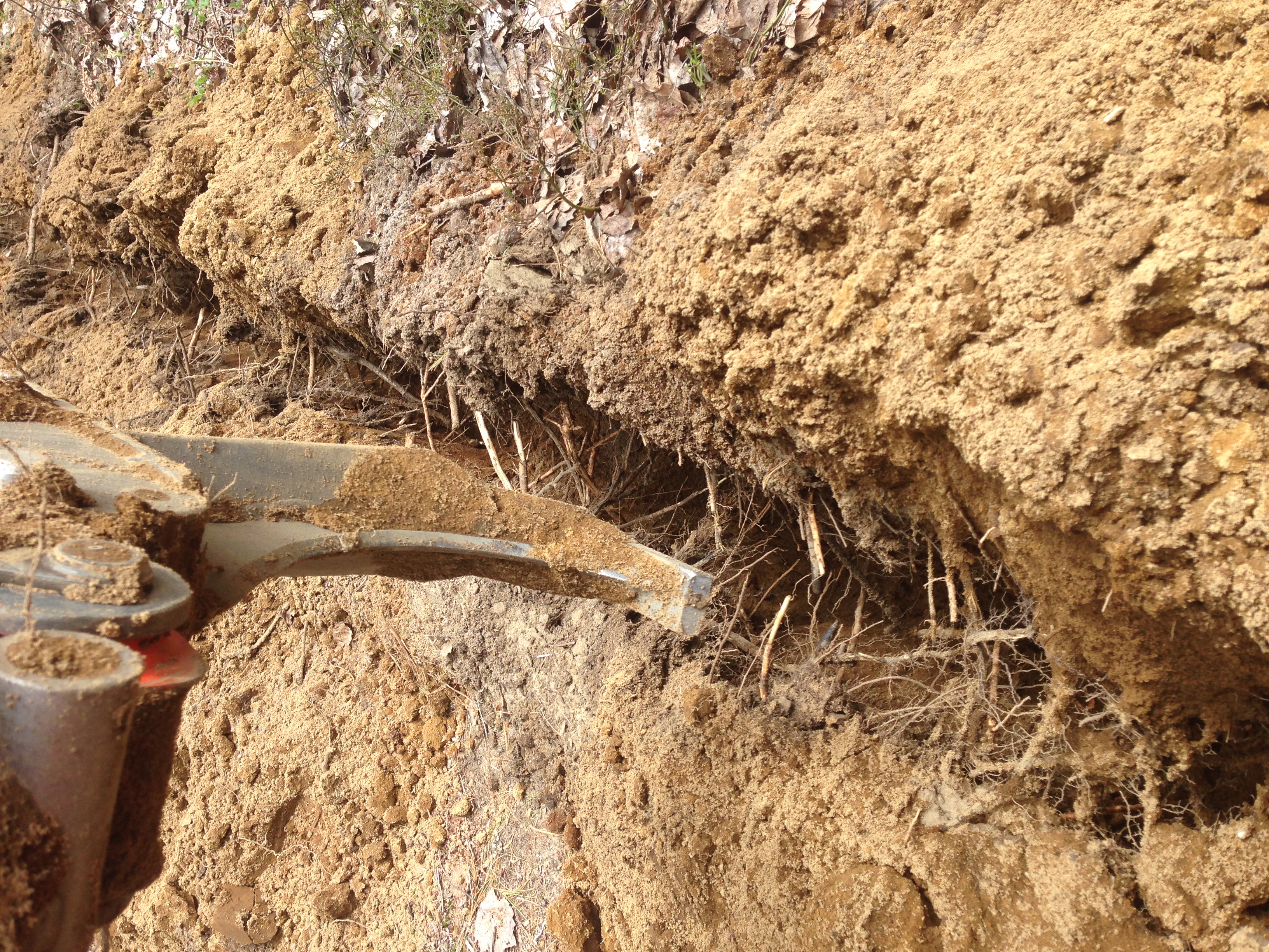

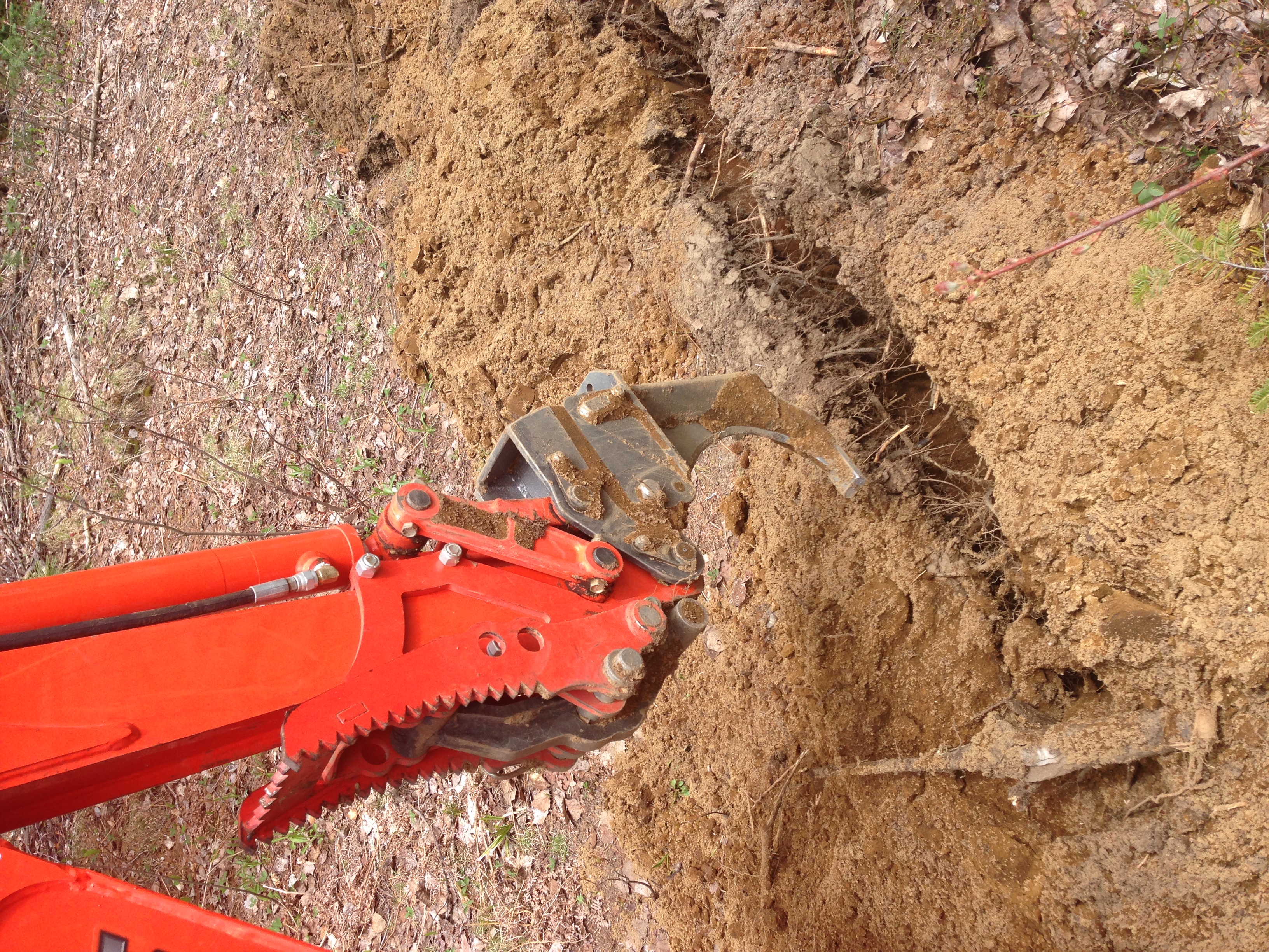

OK, so I got a chance to try out my Bro-Tek Ripper Tooth, digging a ditch for my water line. Worked great! Notice all the surface roots it ripped up, with nary a hesitation.

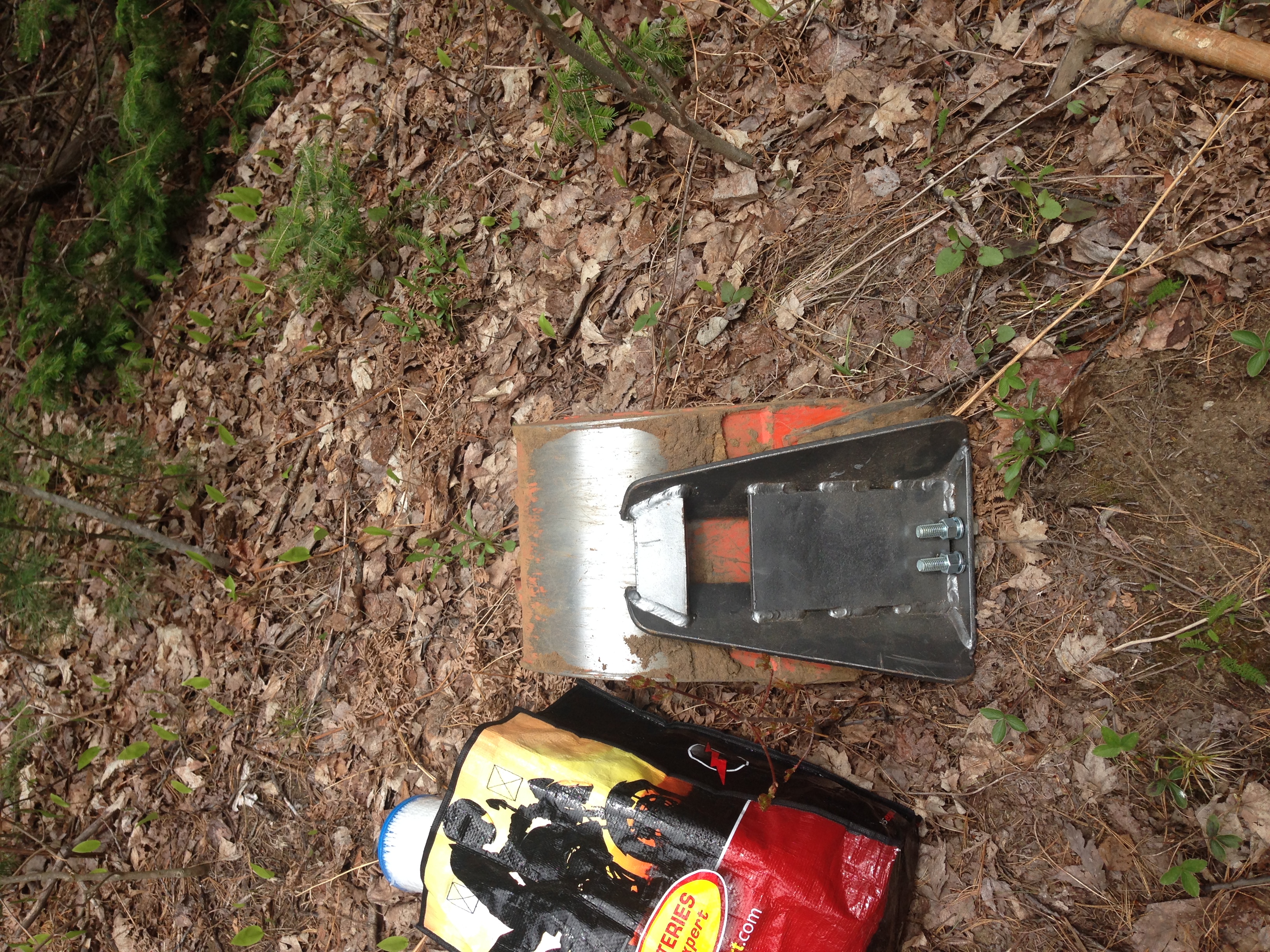

I also got the Bro-Tek QA so I can quickly switch back and forth with my 12" Kubota OEM bucket. The second last photo shows an optional attachment to the Ripper Tooth in case you want a wider ditch. I have it leaned up against the BH bucket for comparison.
Can't wait to try digging out a stump!

I was only digging down maybe 2 ft max, because I will still be draining this water line in the winter. (I just needed to get it off the surface so I could drive over that area with my tractor.)
As you know, the BX25 can dig down some 6 feet, but I wouldn't go that far with just the tooth unless it was hard clay. I would attach the bigger trencher piece if I was to go down even to 4 feet. Or use the 12" EOM bucket. BUT, my soil at that spot was fairly sandy with no rocks at all. If there had been rocks I would have had to use the 12" bucket.
