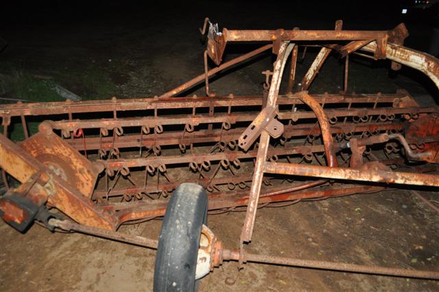

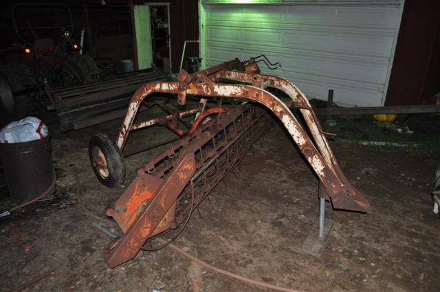

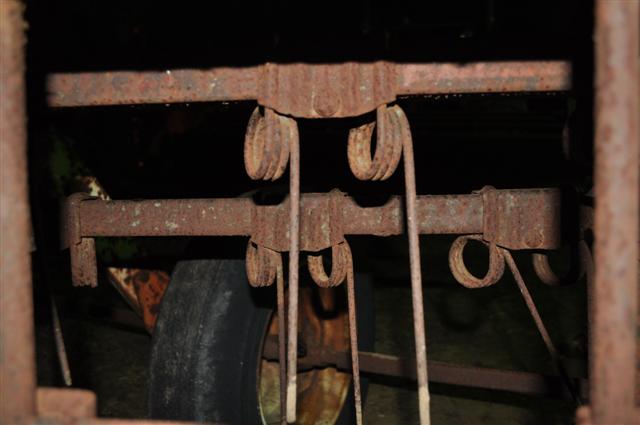

anyone have any idea what model this is? everything works on it but lots of the teeth are broken or missing and all that i have found online ain't them.. any ideas on part #? oh i got it for 200 is that a good price?? jon

Good Deal ... those teeth are sold in my area at TSC ... Do not know the # ... sorry, however that will be a good one!!

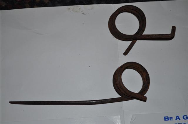

yah but i didn't see the teeth that look like that on their web page. i could prolly make some of the other teeth work.

If you can't find the replacements, You may want to consider those universal rubber base rake teeth. They are higher in cost but last longer. Ken Sweet

Thank heavens for old books and parts people! The rake looks to be a model 281 and the teeth have a part number of T17350 and are still available through the CaseIH parts system with a retail price of $4.83.

KEN i was thinking of those if i cant find the right ones
red those are close but the ones I need don't have a hook they have a 90 degree el where the hook is

yes he is officially my hero i looked the teeth up on aiproducts website and there they were. now i have to figger out how to get them. thanks again

yes i now do its t17350 ill pm ya thx
