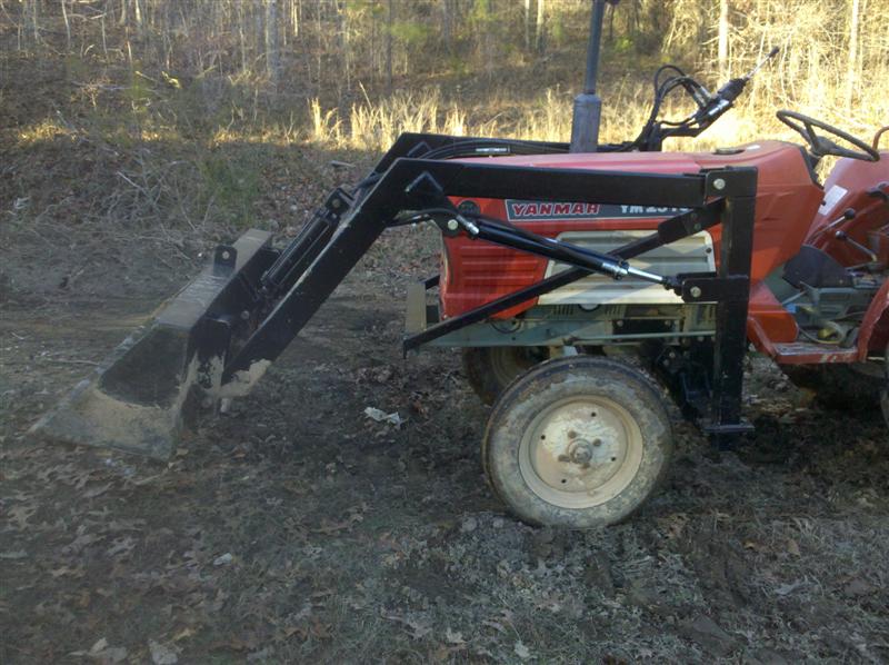

I wanted a new FEL for my Yanmar 2310. So after a lot of reading, blogging, questioning and honestly a lot listening about what to look for in FELs, I recently purchased a FEL online from Coldwater Tractors.

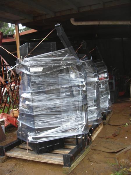

Shipping: Coldwater fabricated and shipped the unit within a week. I arranged for my own shipping. Coldwater packed the FEL on a pallet wrapped in plastic. I was extremely impressed how well and secure this packaging was done. It appeared that an engineer figured out the best way to ship the FEL. Nicely done! It arrived perfect! Henry sent me a picture of the unit on pallet before it left their dock. Weight was around 600lbs.

We used a hydraulic lift to remove the FEL pieces from the pallet. This is a very handy tool to have around. We un-wrapped the plastic wrap and removed all the packing wire. Once again, this was very well packed.
Everything was in perfect order. Hardest part was to get a mental picture of the end result never seeing this specific model installed. A little trial and error and we had all the nuts and bolts done in a little under 2 hours. Installation was actually very easy.

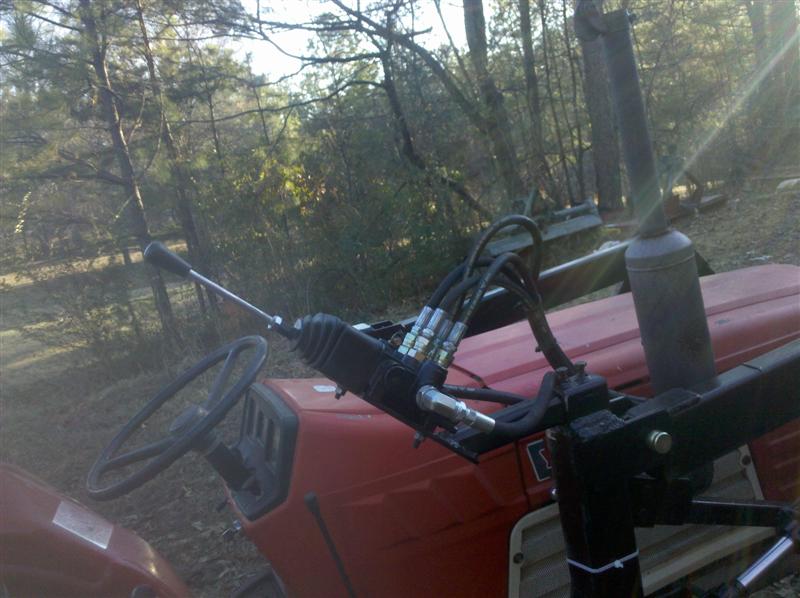

The next task was to connect the hydraulics.... the pre-connected controller had no markings (we found) for pressure in or out. We winged it and guessed the right line off the controller box was the pressure in connection. Made the cut on tractors hydraulic line and install the new ends. All the standard connections came on the lines. I like the fact that I could go to Napa or any local hydraulic shop and replace any of the connections or lines if I ever needed to. There appears to be nothing proprietary here. Checked the hydraulic fluid level and it was perfect. Started up the tractor and let it sit for a minute or two, then we raised and lowered the still connected box-blade, no worries, then hesitantly tried the FEL... wow, up it went, then down, then up... slow at first, then curled in, then out, up and down... a little sluggish, but responsive.
Turned off the tractor and checked the hydraulic level again. It was pretty low so we added 2 quarts of hydraulic fluid. Started the tractor and worked the FEL and box-blade a little more. The attachments were smoother and more responsive. Turned off tractor and checked fluid again. Right on the money!
Lastly, we secured the new hydraulic lines to the FEL frame with a couple of zip-ties.
Impressed so far - time to try it out - drove over to a pile of dirt and after couple of little rookie maneuvers, picked up and unloaded a couple large loads. Worked like a charm. May even sell my shovels (ok, not really). The front tires may need to be replaced soon (currently 6 ply) to a more substantial tire.

Good job - glad it went well. IMO the FEL about doubles the usefulness of a tractor. Do you mind if I ask the cost, and the load rating? It looks well-matched to the tractor - I like those side plates on the frame that bolt to the engine.

I noticed the side plates also and thought they look like a good idea to tie things together. You just doubled the usefulness of your tractor, just need a lot of weight hanging off the back. One thing I noticed and have a question about, was wondering if there's room to flip the control valve and hang it from the bottom of the bracket, that way no hoses sticking up to catch on something. I bet it was satisfying to do all that yourself and seeing it work so well. Have fun in the dirt and when the wife sees how useful it is, you may just get approval for another purchase down the road.:cool:

We paid $1,800 for exerything (+ shipping that we covered) I believe this is not a secret and it is posted on Coldwater's site. Keep in mind that this purchace was made Dec of 2010, but it does give ya an idea...
I do not know the exact load ratings... hopefully Coldwater will post somje detailed specs for us.

Don't want to be the safety police or anything, but please be safe when operating the loader. Your Yannie hasn't got a ROPS and will be easy to roll if you get that loader up high with any weight in it. Suggestions:
Keep it low when moving and watch out for potholes and uneven ground. Keep that boxblade on in back or something else that's heavy, and think about ballasting your tires if you haven't already done so.
