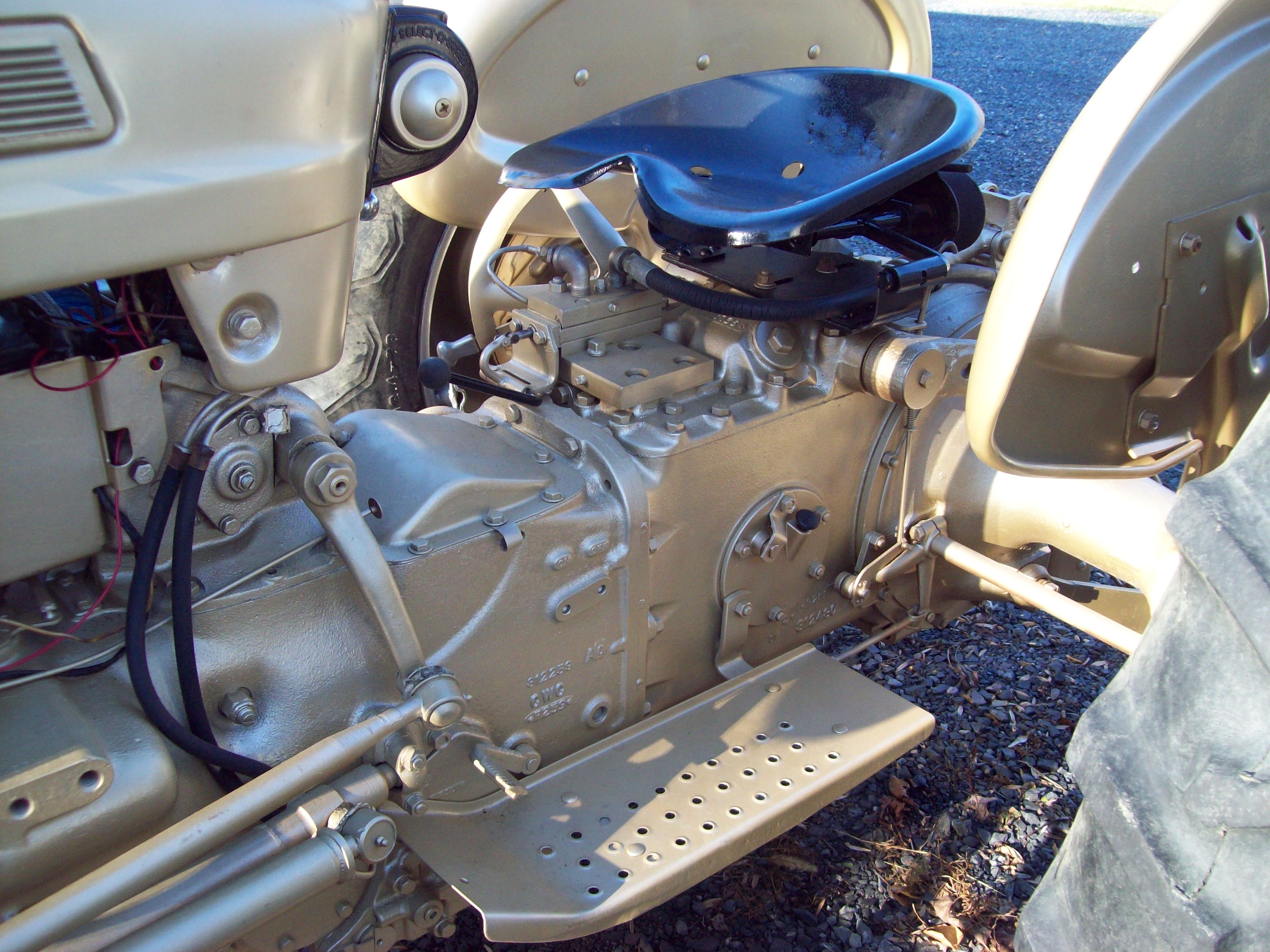

Here is a photo of my 871 inching pedal. Yours should be similar. Possibly someone replaced it with something else. Post a photo if you can.
Yes the PTO will spin when lever for driveline is disengaged. You are disengaging the trans to rear not the pto.

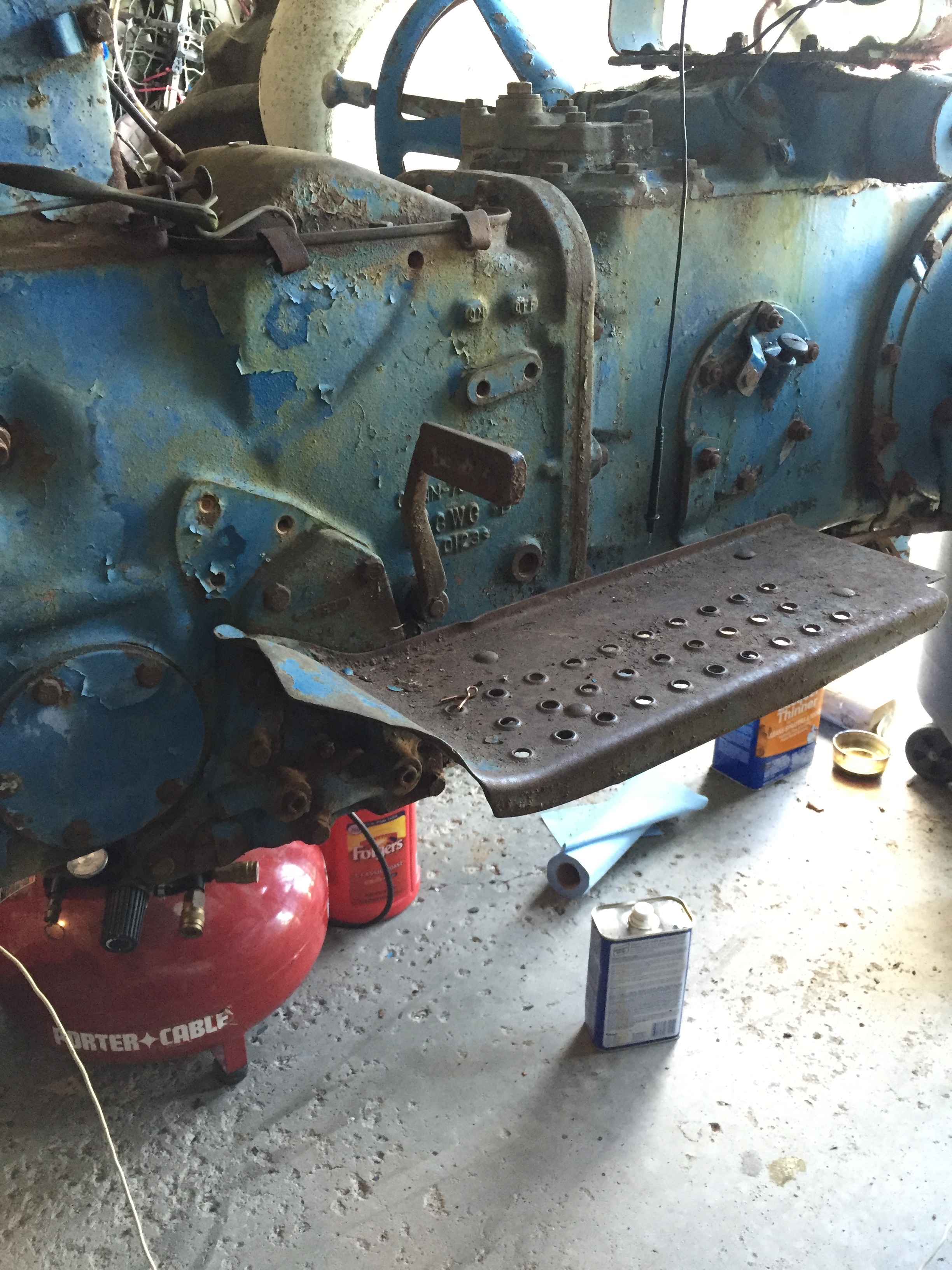

So you bend your own fuel lines? I can appreciate that, but that really isn't something I can pull off. I just need to determine the correct part # for my rig.

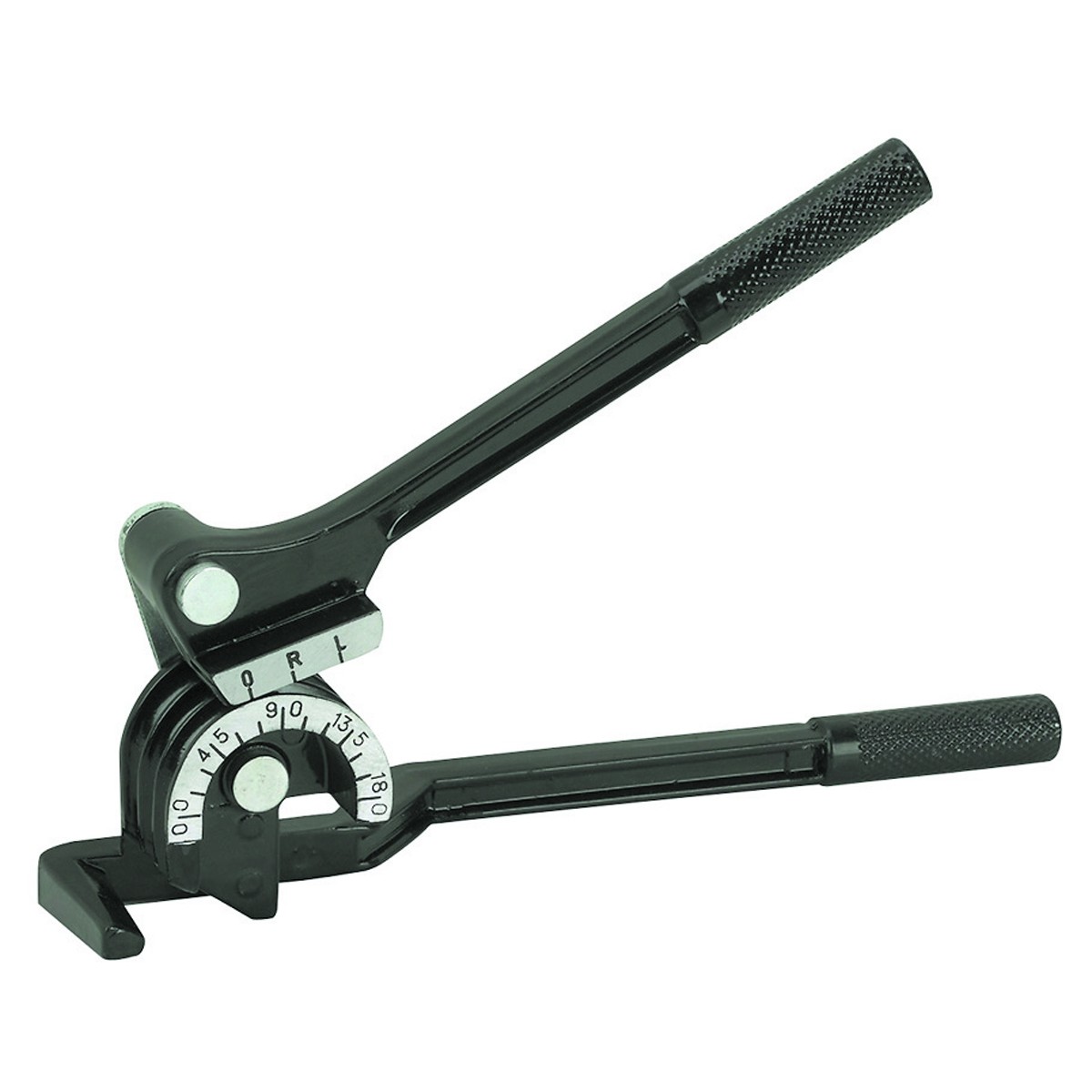

rolling your own fuel line is easier than typing it.
You buy premade brake line at a store like napa for a few bucks. already has flare and ends on it. buy a piece as long or a hair longer than you need. ( if it's too long, you can just get creative to make it take up more length in some of the bends.
The tool to bend brake line is just sheet metal and a small supporting cup, usually the tool will bend a couple sizes of tube.. and they are cheap from cheap tool stores.
You can also hit those cheap tool stores and buy a flare kit that has a tube cutter, bender, flare block and press, reamer, etc for not much $
Depening on the application it may be possible to do a multi part line, some rubber, some metal. all depends on what/when/where/.
Really.. No joke. The line I made up for my 950 from a piece of straight line with ends at napa took less time to bend than typing this message... really... the line is soft and bends easy.. just use the radius tool to bend it...

OK, I can get a pretty cheap tool at Harbor Freight image_18464.jpg and pre-made tube from Napa.
   / My new Ford 4000 #18
you can get them cheaper than that tool as well. indeed, just a couple bucks for a sheet metal one with a track or 2 for 1/4 and 5/16 tube and a small and large radius bend.

Any ideas on my clutch/inching pedal? Feel very little if any resistance when I press it down
   / My new Ford 4000 #20
For unknown reasons I'm guessing the inch pedal was replaced with a standard pedal. Maybe the inching pedal fell off?
