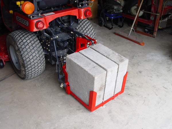

1*I found that it was easy to lift the rear end when filling the FEL up with top soil.
2*I had all 4 tires foam filled. Helped alot.
Good luck with the new machine.
1*U should never use the FEL without a proper counter balance on the rear.
2*I don't have filled tires and see no need to do so on my BX23 as the BH is all the weight I need.
You should not have the front tires filled when doing loader work-likewise you shouldn't have the rears filled when using the BH.
What I don't like about filled tires is the weight always seems to be on the wrong end of the tractor for what you're doing.

i purchased my 2005 unit from an agco dealer in alberta with mmm and 60 hrs on it and had it trucked to wpg. it was donated and used one summer to cut baseball fields for their little league. the 2350 fel was purchased at lawsons last spring......... when i was there i did see 2006 unit like yours in their quonset. since then i have fab'ed up a weight box for the 3pt and dolly to store the mmm in winter. i have ordered the service manual from lawsons and they just informed me it is ready for p/u. the block heater is a external mount type as there is limited room in the water jackets of the block. lawsons quoted me around 130.00 . i am using shell rotella sb in the winter ... i believe its weight is 0w 15.i have been very happy with this unit ........ it has lots of power and not often gets stuck. my next project is to fab up a hydraulic filter guard as the sight of that thing hanging down underneath ready to get snapped off scares me. i want to add a tiller and a snowblower to the unit eventually.

IMHO I would have to respectfully disagree with this statement. When doing FEL work (lifting), the front tires are the pivot point and could have the potential, in certain situations, to provide stability. At the least they would not be additive to a tipping situation since the weight is not beyond the fulcrum.
When I am using the FEL with the toothbar to rake the hard clay I have here, I am most appreciative to have the extra weight in the front tires for digging (and the rear tires for traction). This also goes (for the rear tires) when I am using the rear blade for levelling. I would suspect the extra weight in the rear tires will be beneficial for digging with my new backhoe (when I get it).
Yes I would agree. In my case I had my rear blade (with a 12" block attached and my 260 lbs) and still was able to lift the rear with a full load of damp topsoil. Stupidity always has the potential of cancelling the best laid plans...
