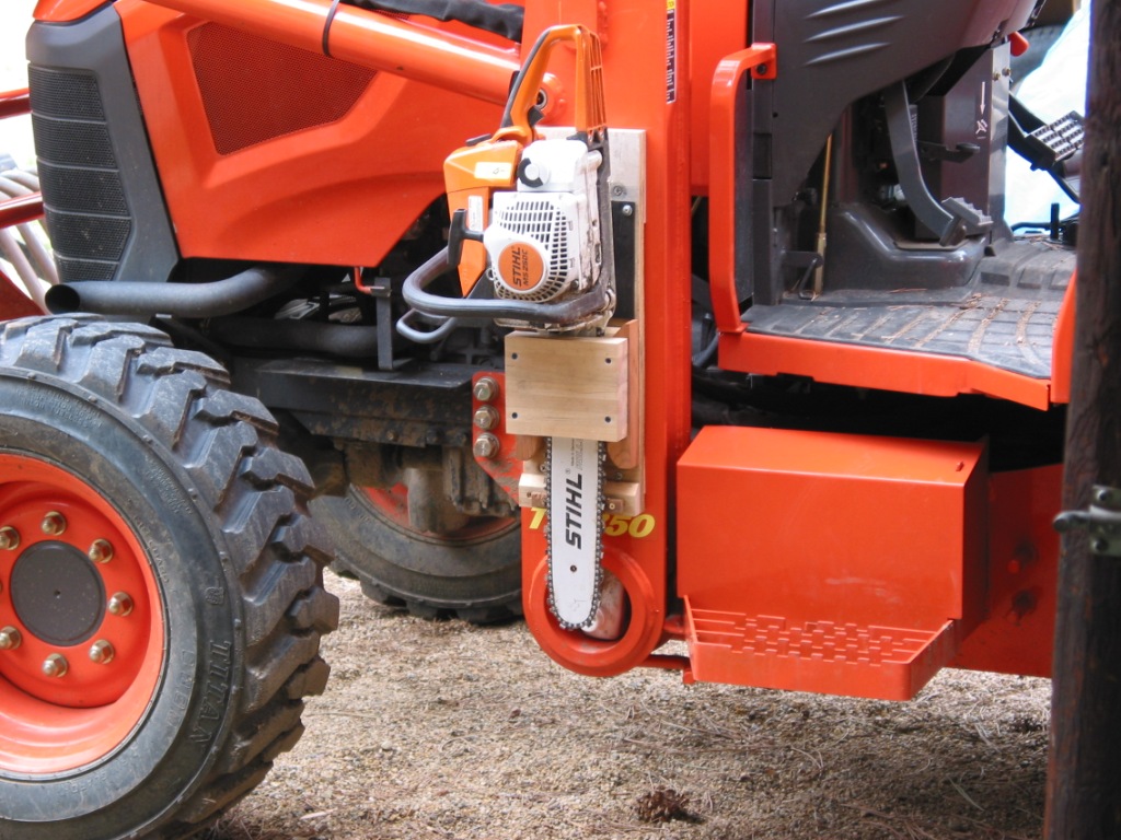

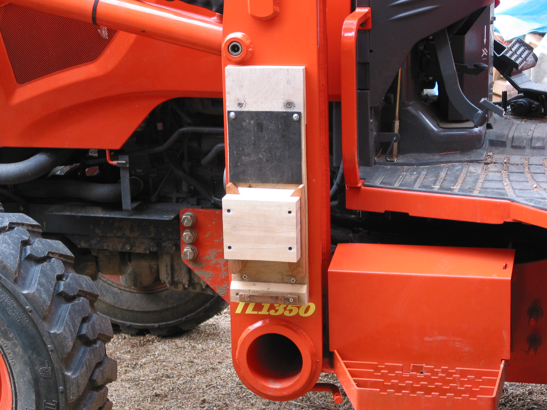

And make up a chain saw holster. Wouldn't hurt to also make up a dedicated place for chain and logging tools too.
