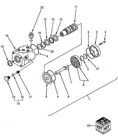

Prankstar, I don't know much about your tractor, but if the PS pressure ever goes to 4000 psi as you stated in your first post, I gotta believe you have a relief valve stuck closed somewhere. That 4000 psi is essentially dead-heading your pump. Most PS systems I am aware of will go into relief at about 1500 psi. The relief valve is often adjustable an located on the steering motor at the bottom of the steering column. Without a service manual for your tractor, I'm just not sure where it is located.
EDIT: See item #17 below. That's your relief valve. Items 15 is removed on the side of the steering motor for access.
