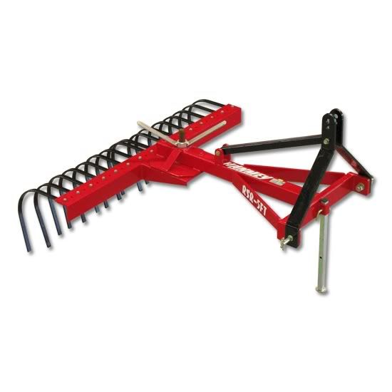

Also an 18 ton wood splitter and a 5' landscape rake.
Then a Jinma chipper and a set of Pat's EZ change system which we bought at the Ag Fair from Pat himself.
We still have to put those implements together, except Loretta already put Pat's system on herself.
