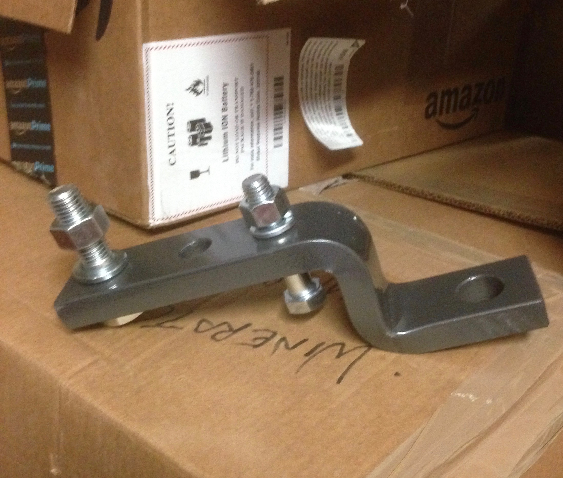

BTW...I received this with the tractor although I don't remember ordering it...I think it is a clevis hitch. What application would I use this for? I ordered a swinging drawbar so not certain where I would use this.

It's a Hammer Strap. The Hammer Strap bolts to your existing drawbar on top. This creates a double pull drawbar. Use a hitch pin long enough to drop thru both pieces.
Purpose is generally for heavy tillage tools or hard to pull attachments. I use one on my M9540 so I can pull my 5 yard clamshell scraper with a Pintle hitch.
I made mine. Dug thru my pics but don't have one. Can't find a pic of the Pintle hitch on my scraper either.
If you Google "Hammer Strap". You'll find all kinds of info.
I have no clue why they sold you one. For your uses, I'd probably take it back. I'm guessing you paid $225 for it??

I use a pull type rotary cutter on our M8540, if I wanted to use it on my 5740, I'd use it to adjust the attachment on my existing draw bar to compensate for the lower hitch height. Now that may not be the purpose, but that's what I would use it for, just like on a pickup.
I had thought about that as I couldn't really think of anything else it could be used for. It wasn't an expensive part but is most likely something that will sit on the shelf unused for many years.

I was apparently wrong, see ovrszd post.

Excellent info...thanks! As it turns out, with overall discount on tractor and attachments I paid about $58 for it.
