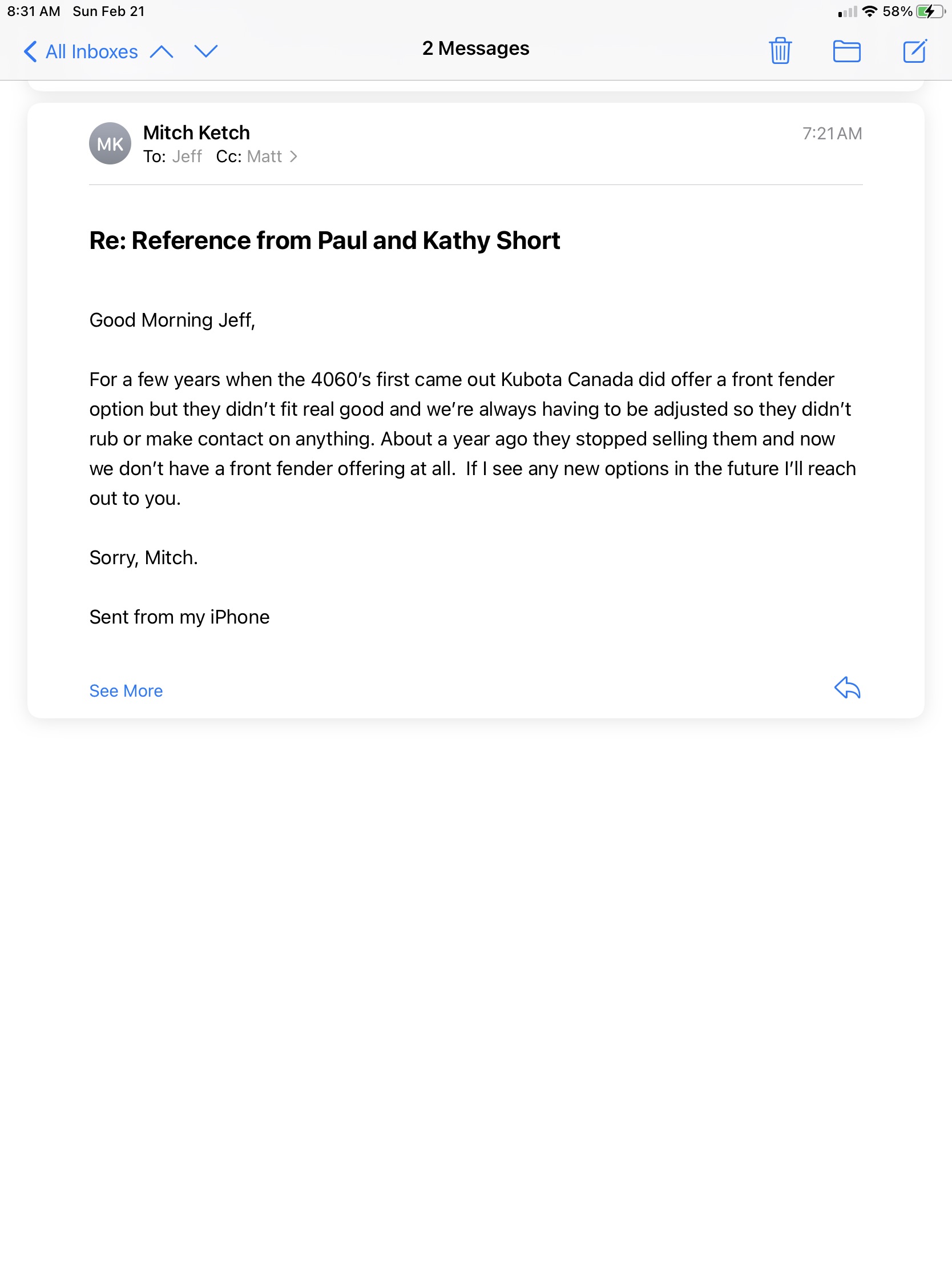

For those following front fender posts for Grand L series tractors here’s the answer from a Canadian dealer.

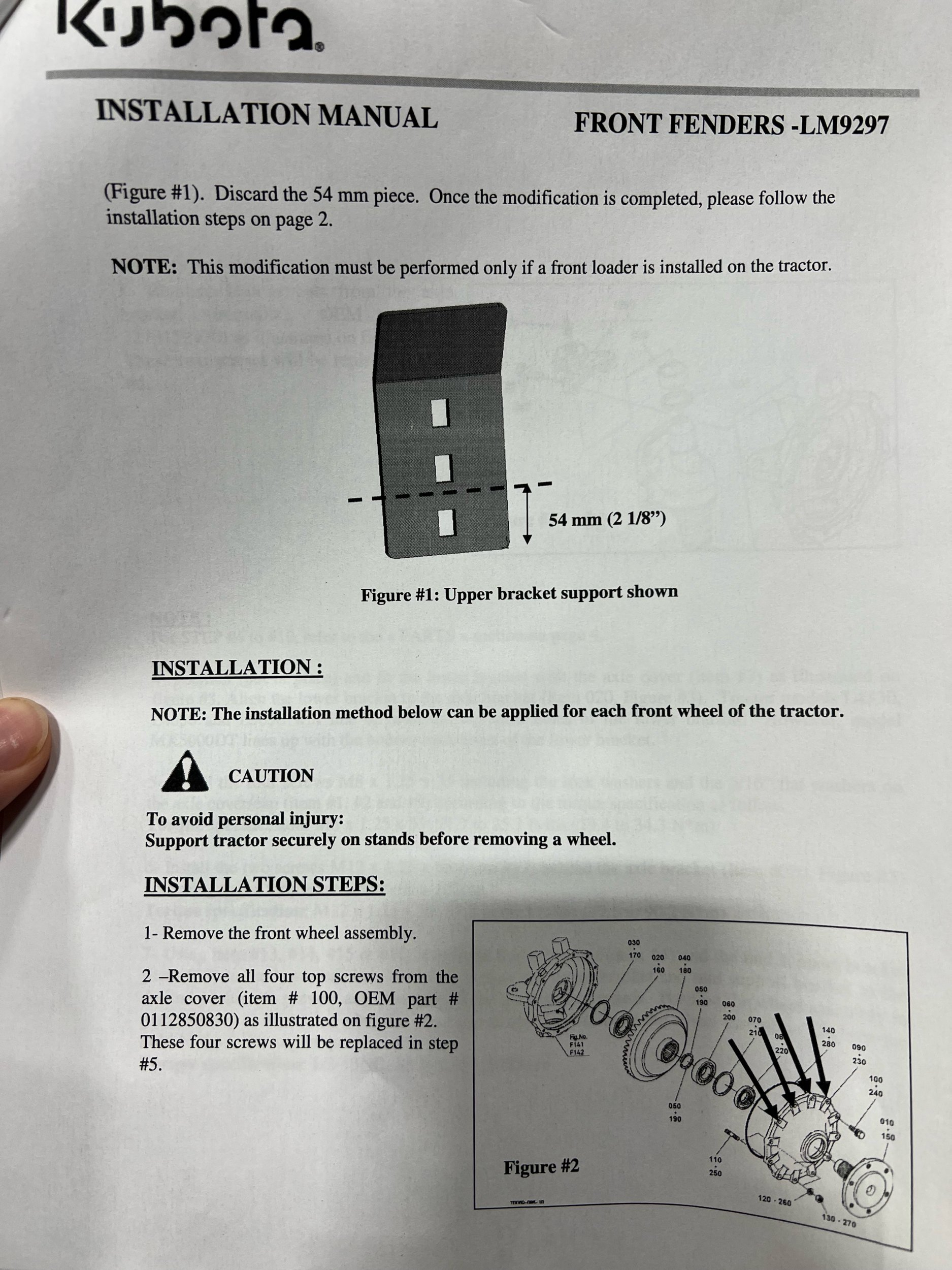

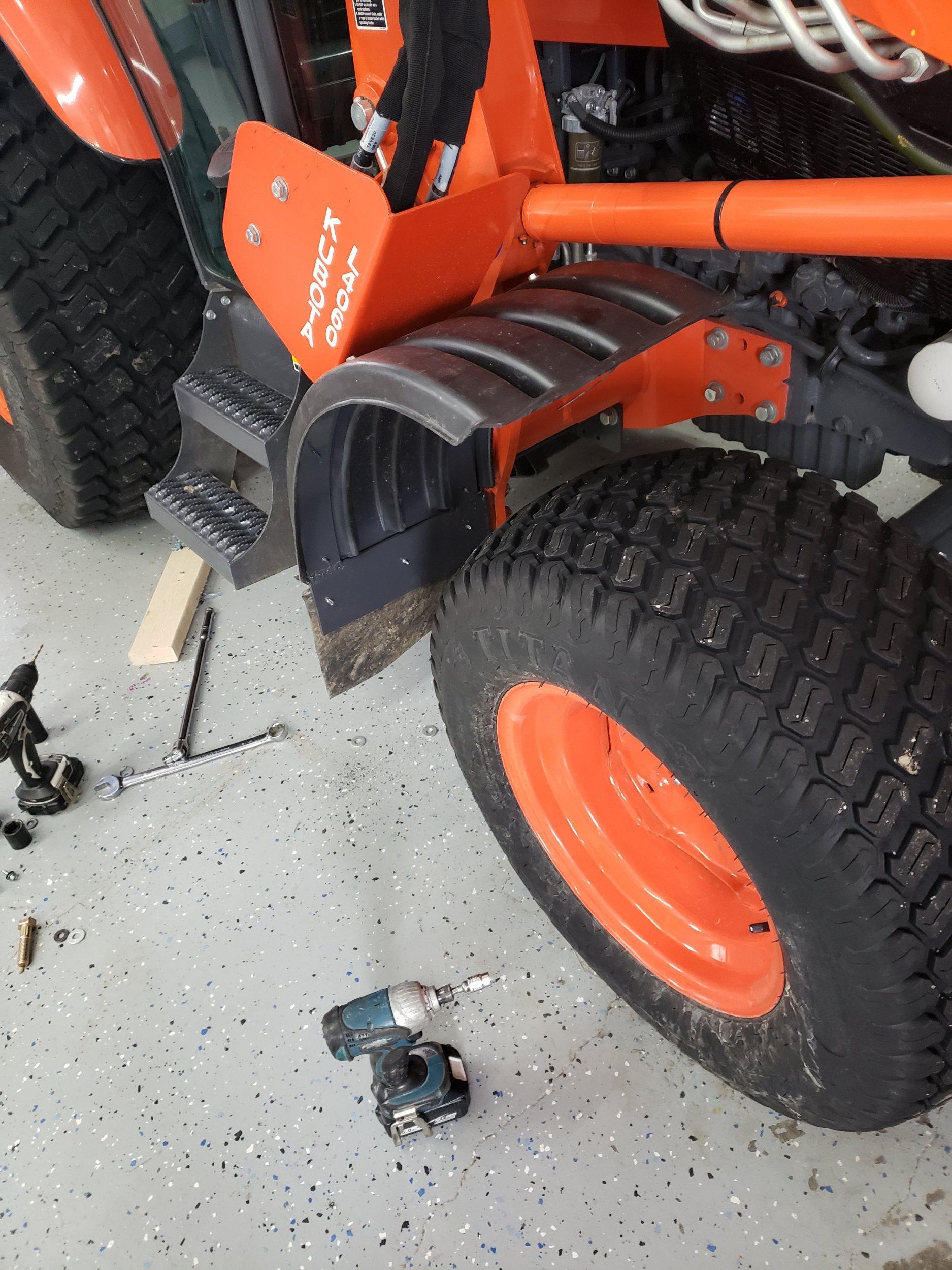

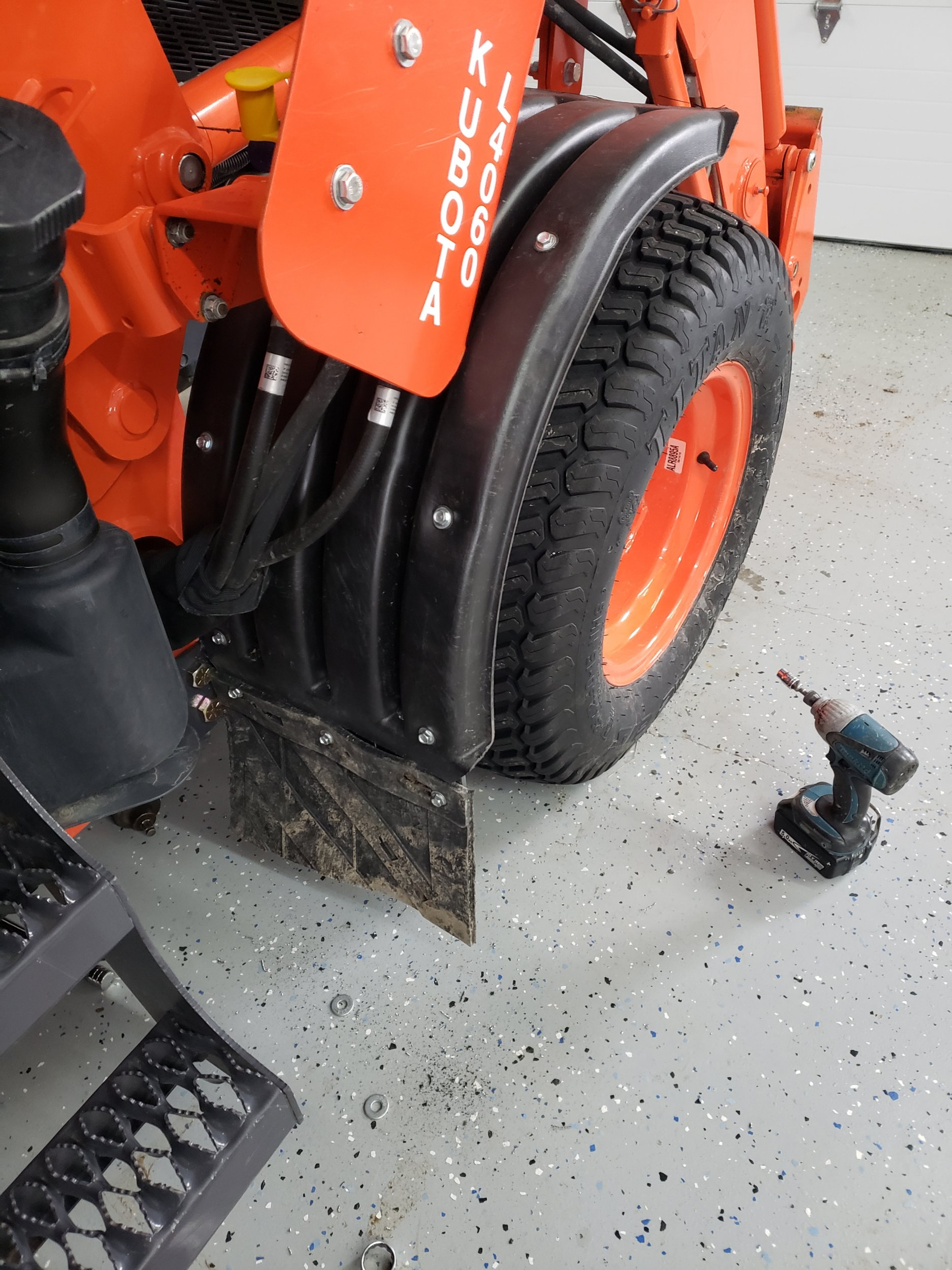

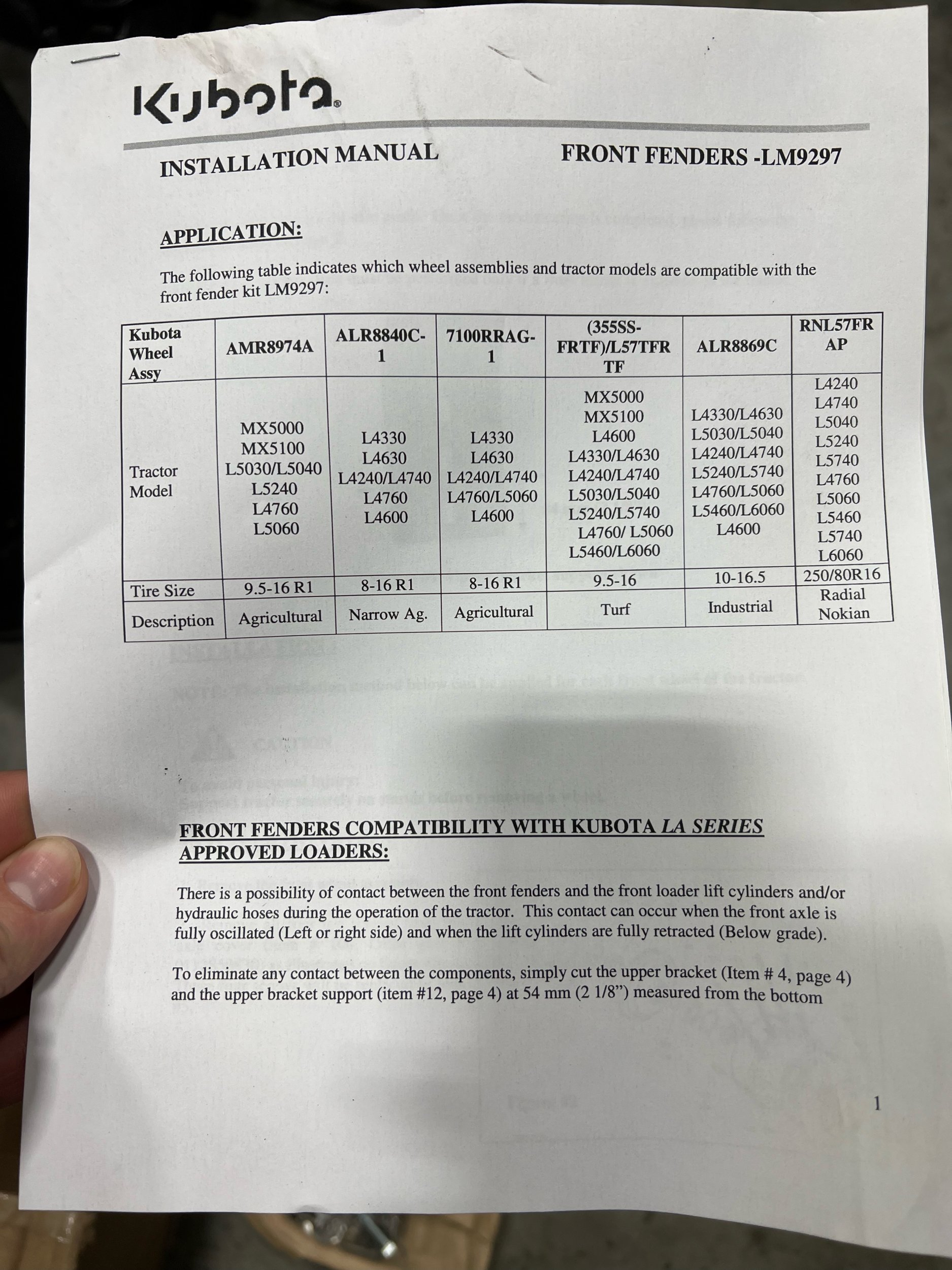

I just purchased a set of OEM fenders (from a Canadian dealer). They do still in fact fit L6060 and the install instructions even mention the provision for install on machines with a loader to avoid interference. See here:
