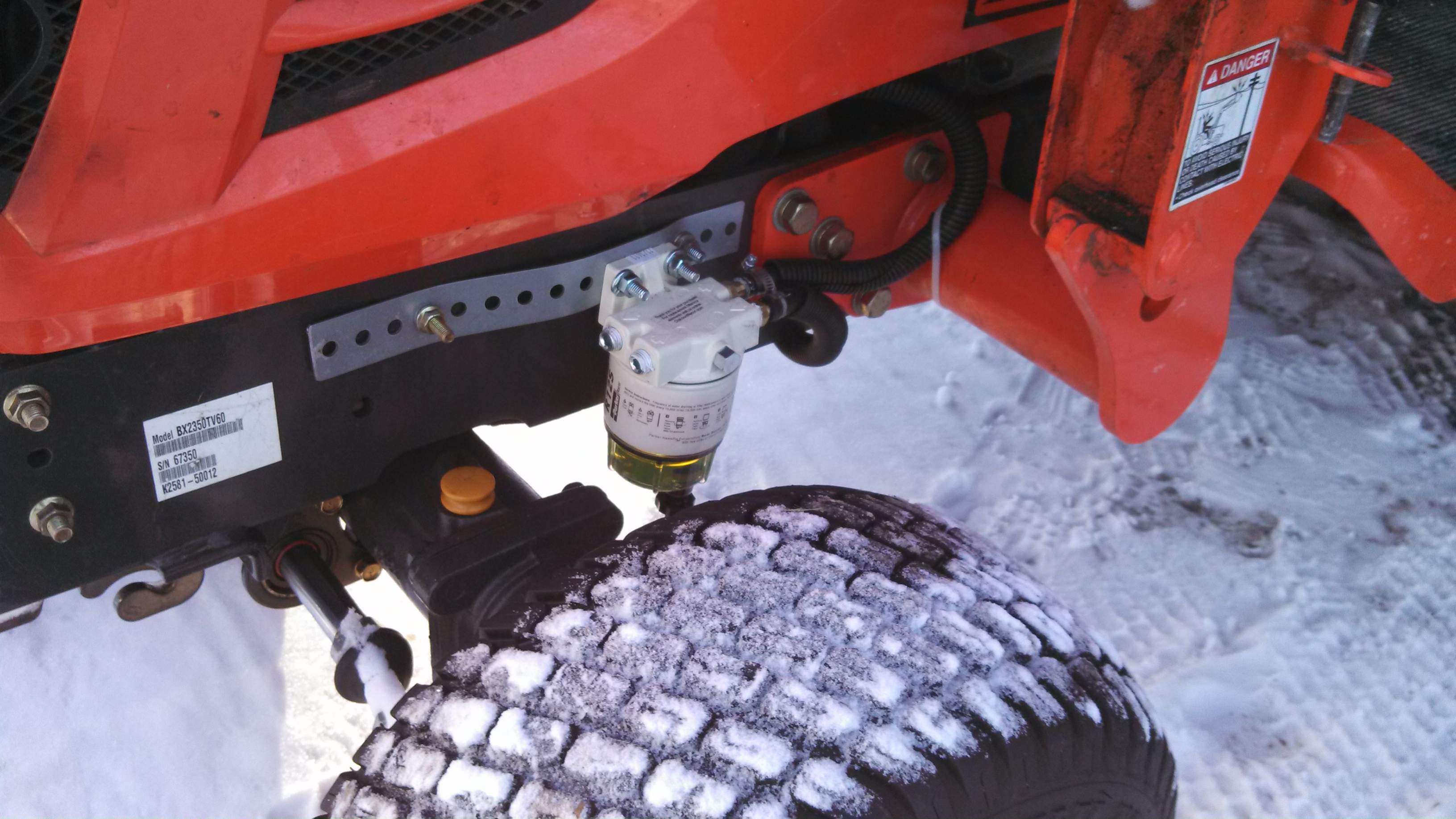

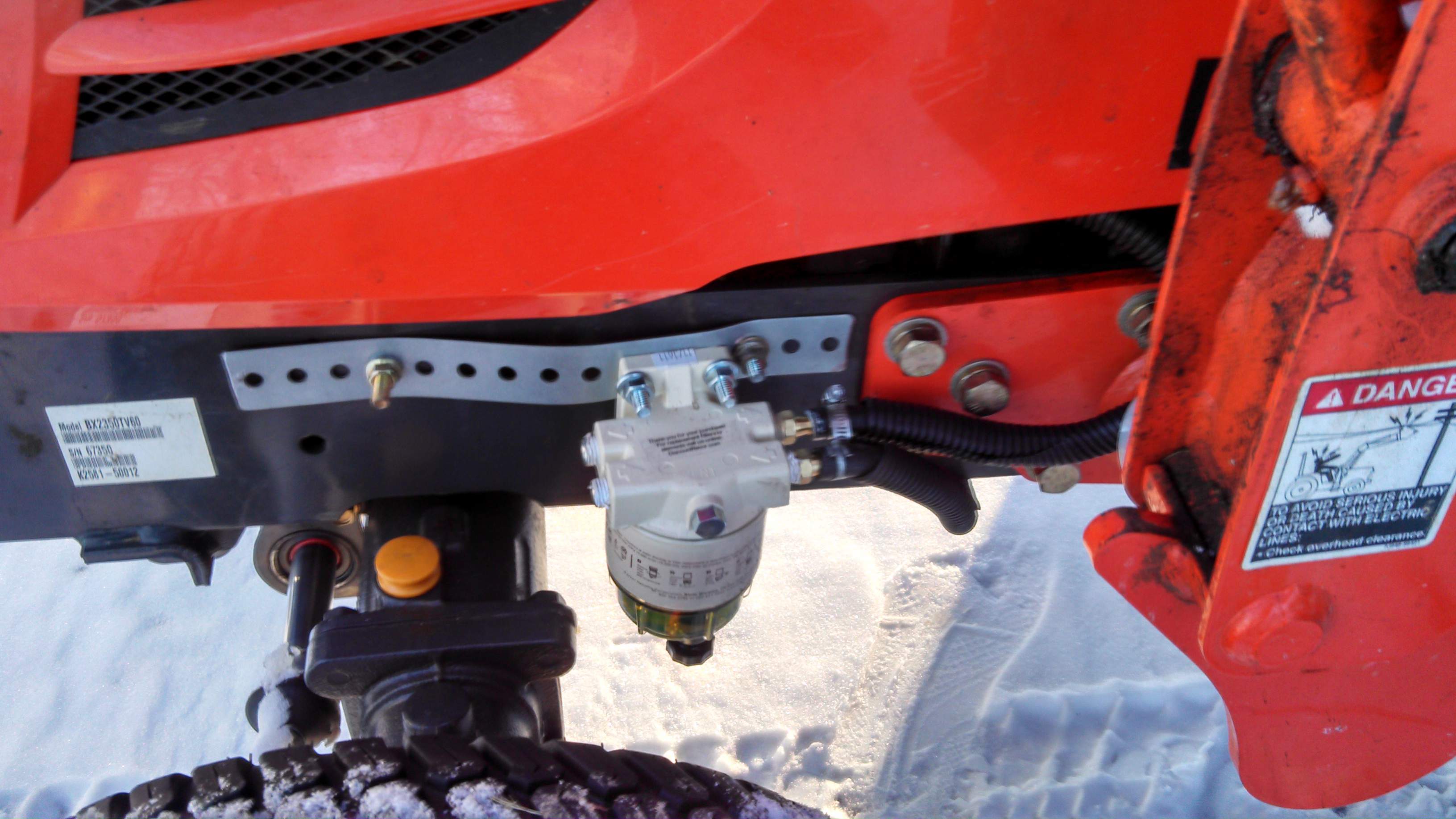

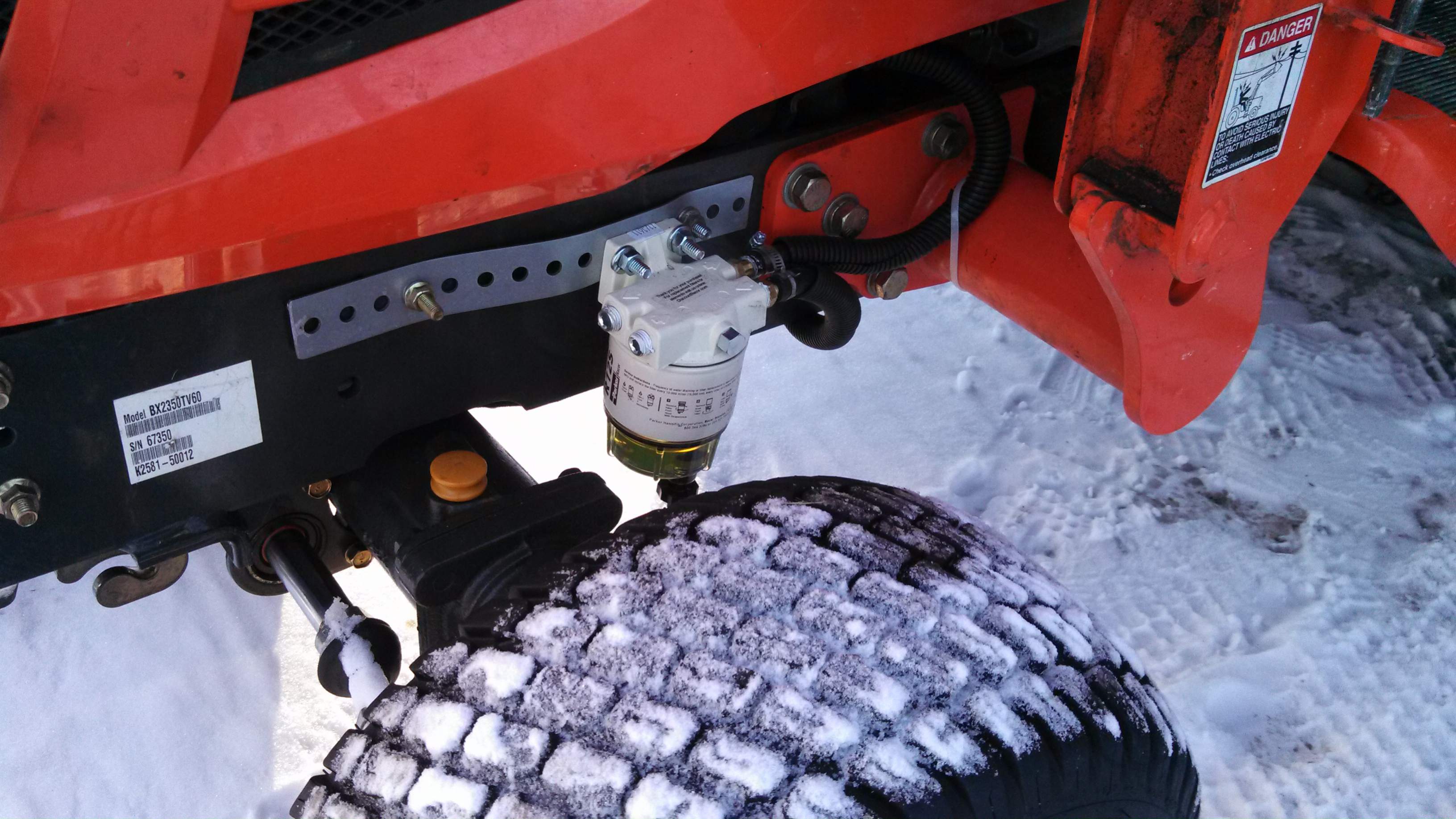

Here are a couple of pics of my Racor fuel filter install on my BX2350. Others have posted much nicer installs. I'm not ashamed of my install but its just not as clean and nice as others.
I simply bolted the Racor to a piece of flat steel I had that came pre drilled with all the holes you see in the photo. I then bolted this to holes that were already in the frame of the tractor. The hole toward the loader arm already had a bolt through it that I removed and installed a longer bolt. I then removed the fuel line from the filter up near the engine and rerouted it to the new Racor. It was pretty much the correct length already. I just had to cut a few zip ties and install new ones. I then installed a new piece of fuel line from the Racor to the fuel filter near the engine and was good to go.
The bad part of my install is that the new filter is after the pump. In theory this can stir the water and fuel up and not allow the water to separate as well. The good is it took less fuel line for the lift pump to move fuel through. I feel the flow level of a Bx fuel system is slow enough to allow the water to separate out. The alternate method is to run fuel line from before the lift pump forward to the Racor then from the Racor back to the lift pump which then has to pump the fuel back forward to the main injection pump. This adds what appears to be 10 to 12 feet of additional fuel line. Its not the cost of this that bothered me but the added length that the pump had to handle. The truth is, either method of plumbing the filter is probably fine and much better than the factory system.
I looked long and hard at other places to mount the filter but there just aren't any that are lower than the fuel tank.

Dave, nice job.
You touched on the fuel emulsion concern, how much of that plays out in practice remains to be seen. One thing though, your filter looks awful close to the axle and wheel. Id be a bit concerned about ground debris and/or stuff thrown off the tire hitting it. You might want to consider moving it back a bit, use the loader bolts for mounting.
   / My new Racor install
I actually think its might not be any more exposed to debris, its fairly close to the axle which may protect it some. I'm pretty sure anywhere on the front frame rail is somewhat vunerable to debris hitting it. Its a pretty solid unit so I think it would take a pretty hard hit to damage it. I also found out it didn't come with the drain valve tightened. I installed the filter last Saturday and we had a pretty good amount of snow that night. The next day I was plowing and I noticed a huge fuel leak. I turned out just to be the drain had worked itself loose.

dodge man I often make things more then once before I get it right, its just part of doing stuff.
Not that you asked, and you don't have to do it because I said it but.
Look at this picture, see the two top bolts of the fel mount to frame, see the space between the two bolts.
It looks like that space between the two bolts was meant to have your filter between them.
Use the same bracket that you have now, hog out the holes to the fel size bolts, use a couple of washers to space it away for the filter bolt heads and move it back there. Paint only the bracket orange and you'll have one nice looking install. :thumbsup:
I wouldn't worry about the shield, that looks like one rugged filter.

I'm reviving my old thread. My original install was not good I had to change it. The problem didn't pop up until I mowed with it. The wheel turned all the way to the left was hitting the filter. On flat ground it wasn't a problem but it the front axle was tipped up at all it hit. It actually unscrewed the filter and dumped fuel all over the yard.
In an above post Waxman suggested moving it back to the FEL bolts. I loved the idea and did it. Guess what, the tire hit it there also. I ended up using the original bracket and added to more that extended up a few inches and bolted the Racor setup to that. If you look at Scooby074 pics its in a similar location but mine is mounted higher. It seems like looking at Scobby's photo I had mine in the same place the second time around and my tire hit it but maybe his is a little higher or tucked in tighter than I had mine.
