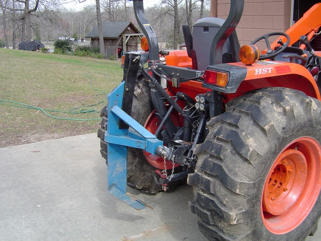

Hey EnviroEd...Why not get a subsoiler? Drop it down, snag whatever it is, slowly drive forward while raising the lift arms. Works pretty good for small stumps. Just do it slowly...

Redbug, that's what I was thinking about:D I'm kinda worried about the rock getting stuck between the sub-soiler and the tractor, have you had any problems like that? If I could extend it back farther from the tires I sure would feel better. Thanks for the help!
   / My New Ripper tooth #19
The problem with extending it back is that you loose lift force on the 3PH with longer lift arms...
   / My New Ripper tooth #20
EnviroEd, I'm not quite sure about the problem of getting a rock stuck between the subsoiler and tractor. On a stump that is stuck, I go slowly and feel my way with the tractor and back off when the tires begin to spin. I do things slowly to avoid bending or breaking something on the tractor. If you approch the stump from another direction sometimes you can get it to move. I guess a rock can be like that, although I have never tried.
