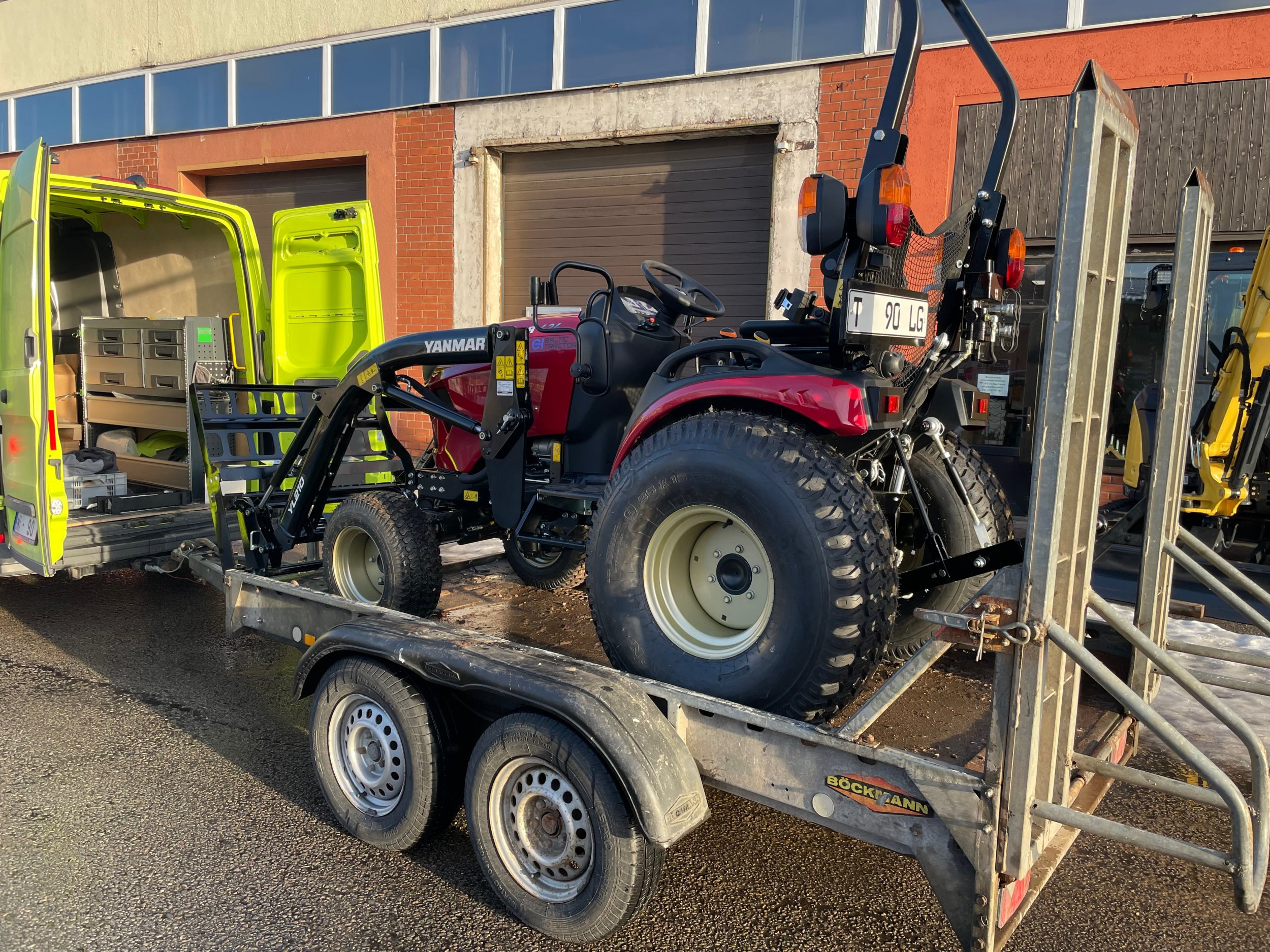

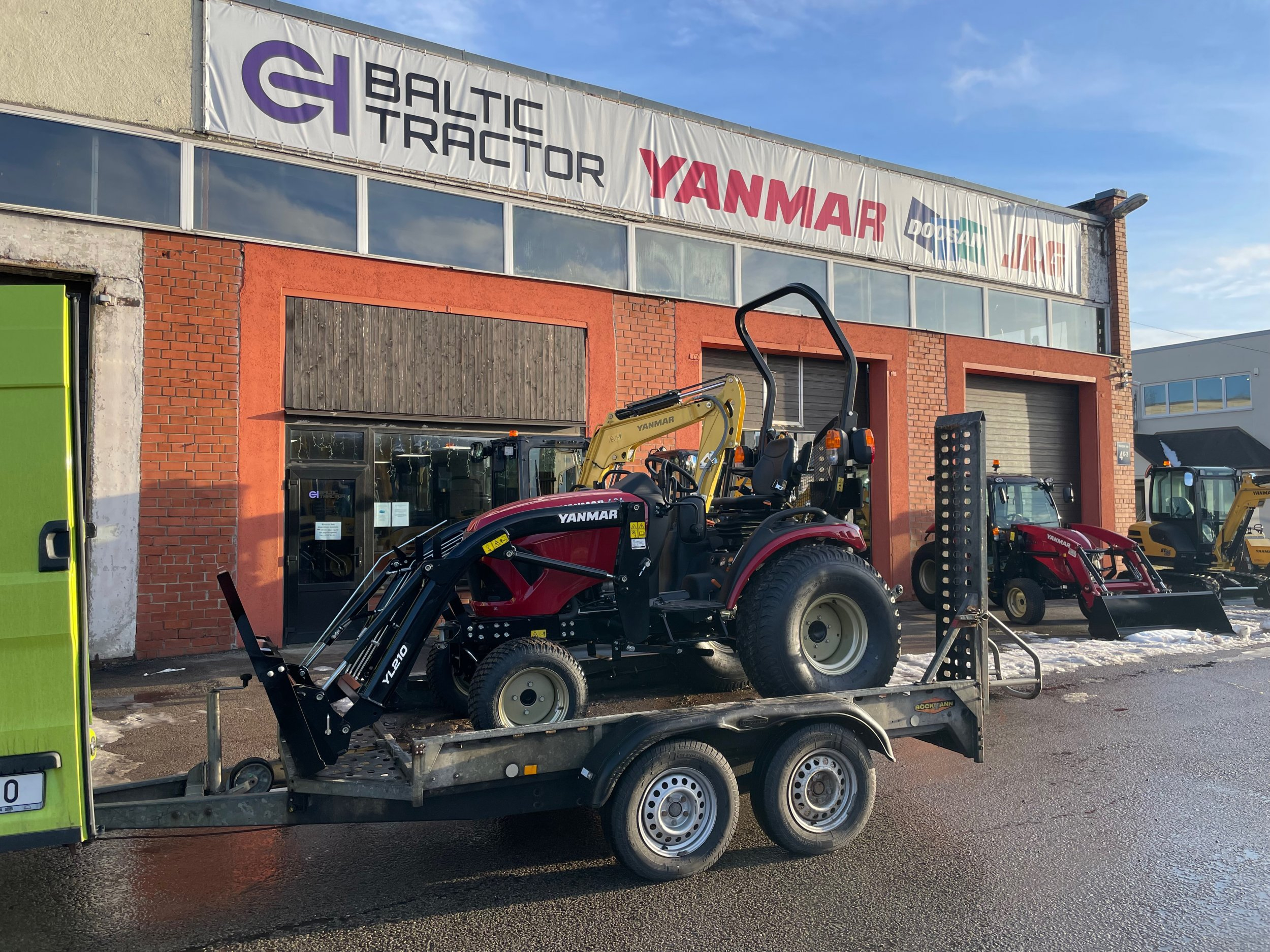

Yanmar SA 424
Yesterday collected my new toy :cool:

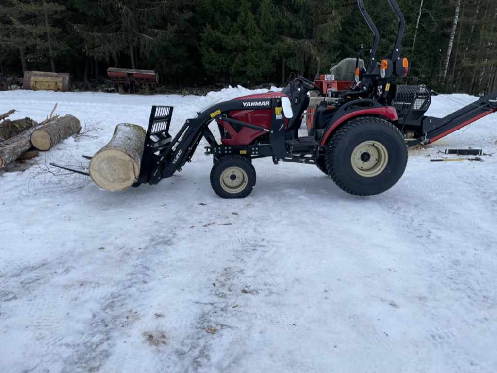

Frankly - FEL capacity is a bit of disappointment.
That chunk is only 2,4 m long. Aspen, which is light wood. OK, directly from stump, could be full with juices, but it is "winter cut" = should be pretty dry already
Maybe some weight on rear 3p will help. Guys - do you have any idea, how much would be optimal to put on the tail ?
Turf tires in that snow / ice are working very well, indeed
Didnt like joistick, little jerky to my taste. Please get me right - it is a kind of proportional, but I would like to have it more graduate (if that is the word).
Other things are super

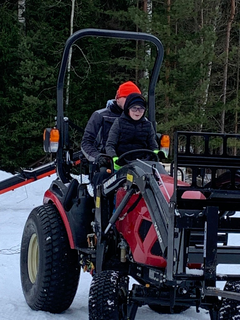

Seats safety trigger is overly sensitive. Boy cant ride it alone. For him that is massive disappointment.
But I mean, I will not bridge that. At least for while.

From the photo, it looks like the FEL capacity is still unknown. There is a problem with a lack of weight on the rear of the tractor. That's common to any tractor.
Actually hydraulics started to struggle either. Both lifting and tilting. Only noise changed when joystick was pulled. 😬

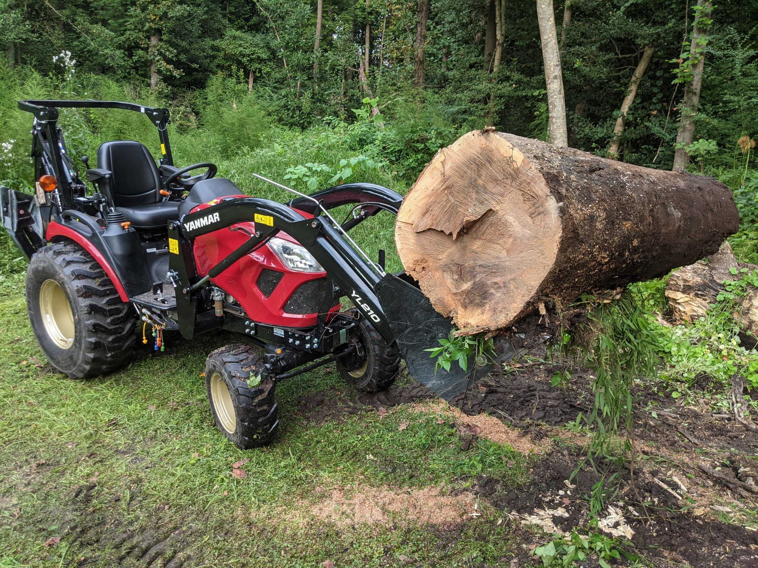

The backhoe makes a great counterweight, and I think the FEL is pretty capable for a machine of this size.

Are you operating with the engine speed at above 3000 RPM? Increased engine speed = increased hydraulic flow.

Nope. As tractor is new, I don't turn motor above 2000 rpm
Maybe that's wrong, but I mean: rpm = flow = speed of hydraulics
At the end pressure should be the same, not so much relevant on rpm ?

That is how the theory works, but without flow you do not create pressure. I fully understand the flow=speed and resistance to flow=pressure. Without flow, it will minimize resistance. When doing a pressure test the engine is to be set at rated engine speed, anything below that will have drastic differences.
There is no break in period for the engine, just a initial 50 hour service.
/ My new SA 424 #15
NICE tractor!
If you don't run the rpm's like 2500 up
don't expect the functions on the tractor
to work very good! example: your trying
to use your tractor like a little boy and he
can't do the job until he grows up! You
need more RPM"S that's what the tractor
is made for you are not going to hurt the
diesel engine with high RPM"S so you will
not be using very much fuel with the high
RPM"S but you will be able to work better
also without weight in the ass end filling the
bucket with put you up in the air, you get
a free lift in life not good!

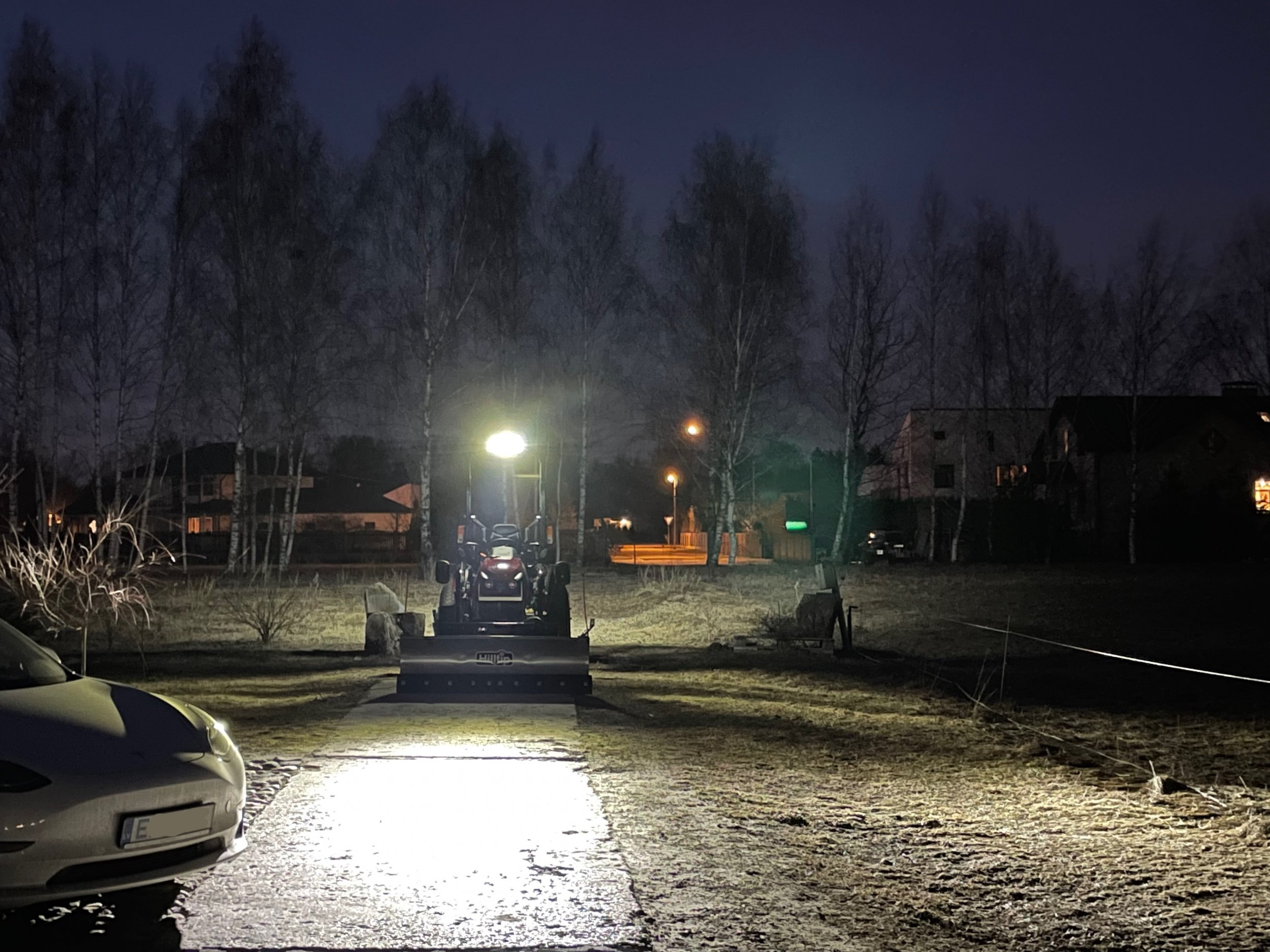

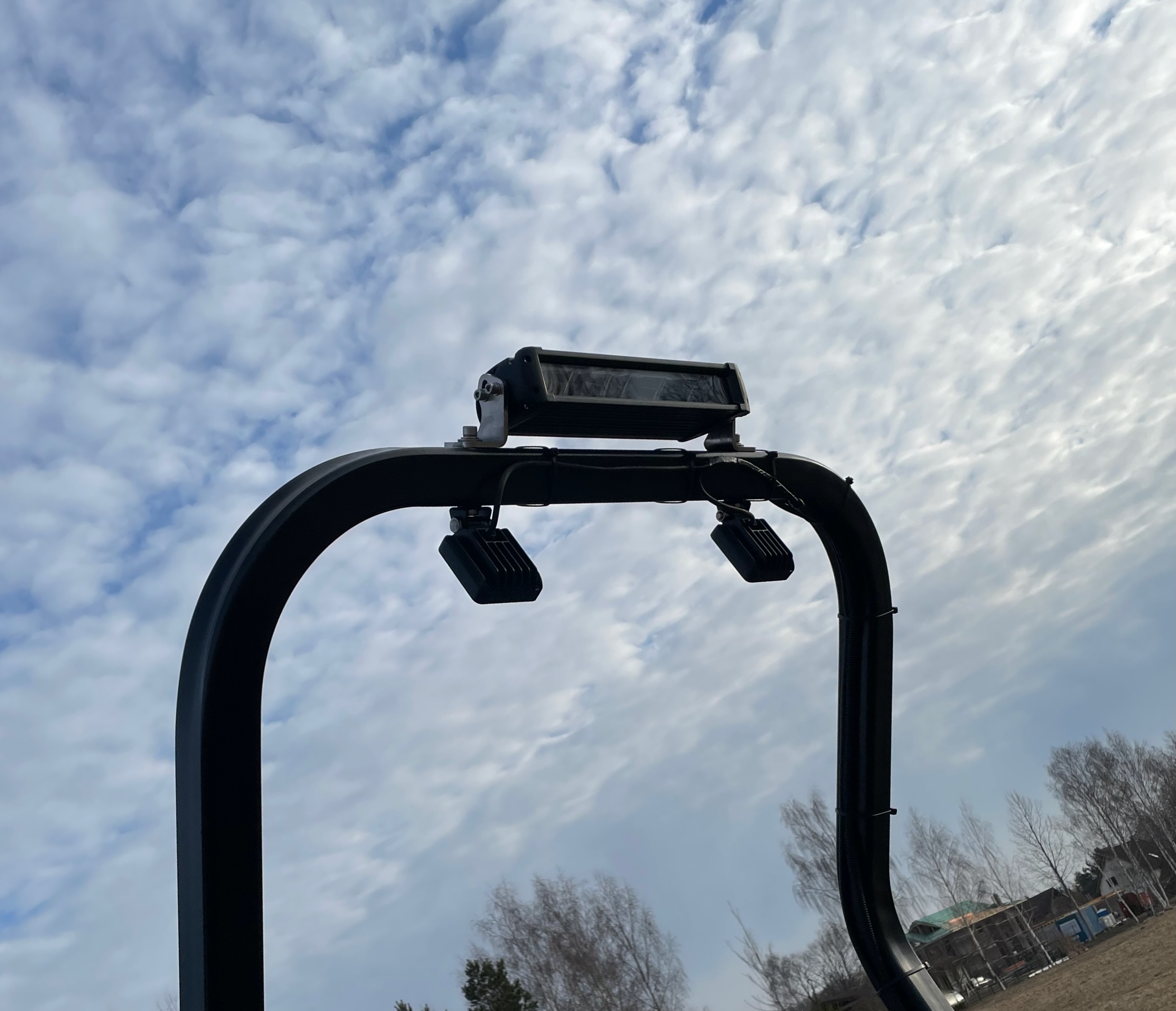

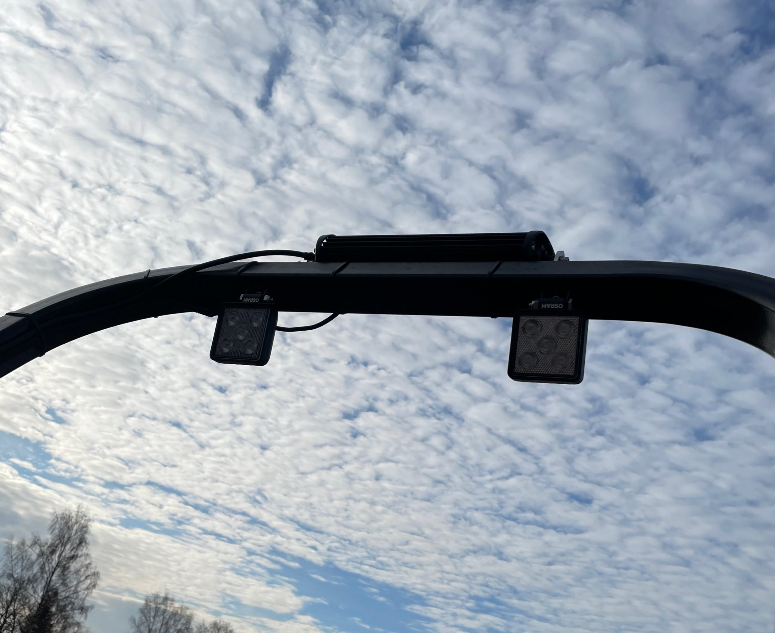

Those are original lights
New LEDbar in action.
Maybe should be a bit higher. Will see.
Good thing is, that light is very focused.
And working lights for backside
I am super happy with result.
OSRAM
/ My new SA 424 #17
What lights did you upgrade to? They are definitely effective!
