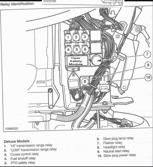

In order to check the safety module, it is under the left side cowling where the relays are. To remove the cowling, you remove the bolts between the two sides under the steering wheel and then there are two bolts on the firewall, visible when you raise the hood. There are actually three bolts there, but the top bolt does not go to the cowling. Only the lower two bolts need be removed. With the cowling removed, you will be shocked with the amount of dust and you may find a critter nest. Do not use water to clean this area. Use a soft bristle paint brush and compressed air (like keyboard cleaner) to blow out any dust. In the illus. below, I've labelled the Oper Safety Module. Just above it, there are 6 relays. #4 is the fuel-shutoff relay that sends power to the solenoid. On the Oper Safety module, Pin E is the one that gets input from the seat switch. If the parking brake is set, there is a parallel path to that pin from the parking brake switch. If the parking brake switch is damaged or out of adjustment, it should not cause problems. It only serves to bypass the seat switch if you are in neutral and not sitting in the seat. The safety module sends out power on Pin B to the Fuel S/O relay's coil. If you think the relay is inop, you can swap it with one of the other similar relays.
It is completely okay to run 12 volts through a switch to the solenoid. Just remember that when you turn off the key, you will not kill the engine. You'll have to throw the switch. Since all your interlocks are already bypassed, this is the only additional caution. The solenoid runs on full 12 volts and is common for it to get warm, but not so hot you can't touch it.
Good luck with your troubleshooting. BTW: The fuse that supplies power is fuse #2. If fuse 2 is blown, your engine will not crank over and the PTO ON lamp will stay illuminated constantly on the dash with the key on whether the PTO lever is engaged or not.

Thanks Jim- That illustration is very helpful! I will check the relay and do more research regarding the wiring harness. My last resort will be to wire it directly, of course from a switched power lead in the ignition somewhere.
